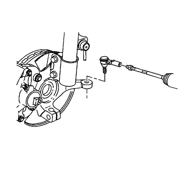

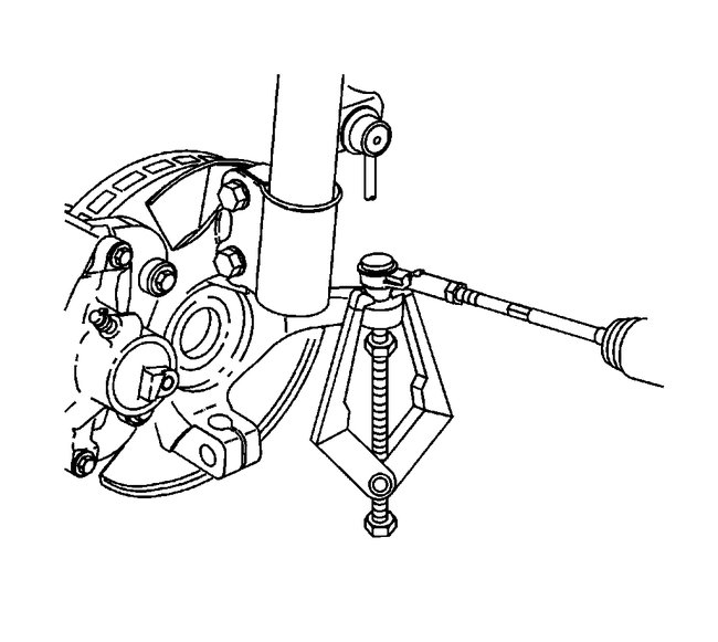

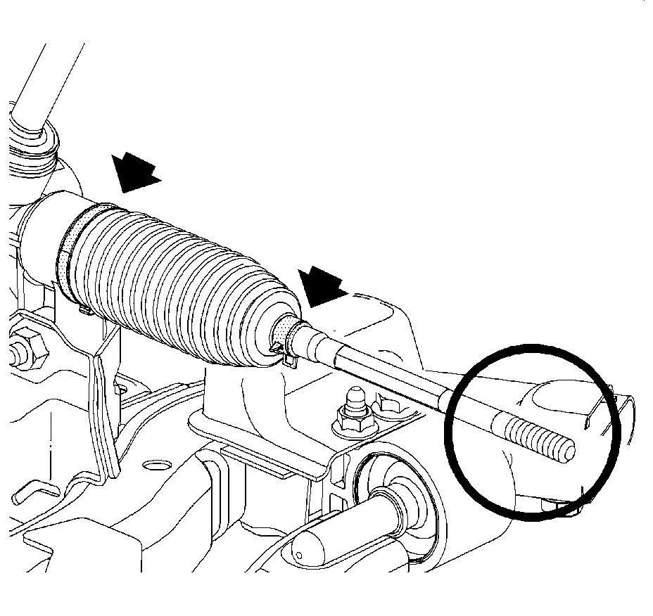

Old parts I'm trying to get off do not belong on this car. There is no nut above the tie rod end. There was no crown nut. No carter key. I am trying to un screw the tie rod end off but it is spinning the whole tie rod no matter how tight i hold it. Please help. Thank you for your help in advance.

- J 24319-B Steering Linkage and Tie Rod Puller
Removal Procedure
1. Raise and support the vehicle.
2. Remove the front tire assembly.
pic 1

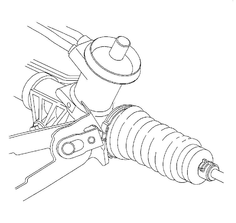

3. Important: Mark the location of the jam nut for installation.
Loosen the tie rod inner jam nut.
pic 2

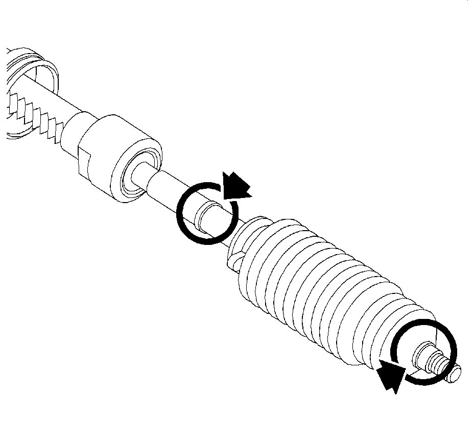

4. Important: Hold the ball stud to prevent turning during removal of the nut.
Remove the tie rod to knuckle nut. Discard the nut.
pic 3

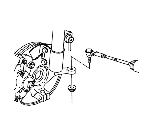

5. Notice: Do not free the ball stud by using a pickle fork or a wedge-type tool. Damage to the seal or bushing may result.
Use the J 24319-B to separate the tie rod from the steering knuckle.
pic 4
6. Remove the outer tie rod from the inner tie rod.

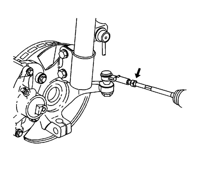

Installation Procedure
pic 5
1. Install the outer tie rod to the inner tie rod.
2. Connect the tie rod to the knuckle.

If you are unable to remove the outer tie rod, then both inner and outer will need removed and replaced. Here are the directions for replacing the inner boot for the inner tie rod. This will get you to where it connects. Remember, you want the overall length of the unit to be the same when you reinstall it. Also, I do recommend an alignment when this is done.

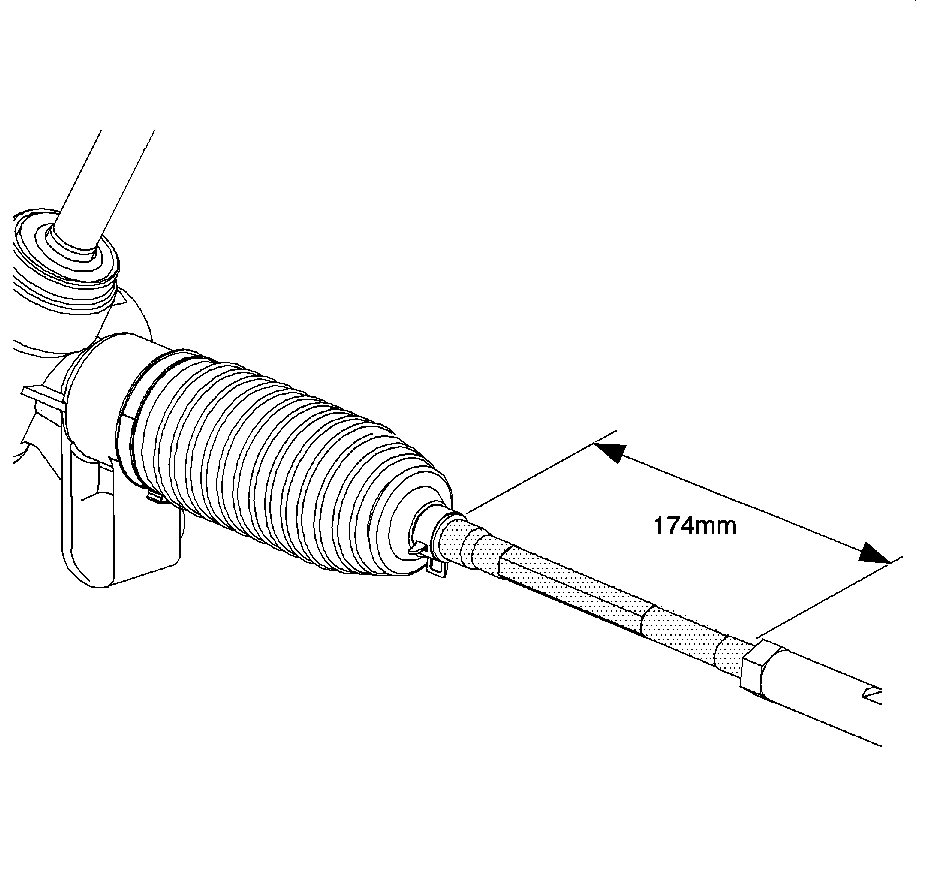

5. Install the jam nut approximately 174 mm (6.85 inch) from the boot clamp.
pic 13
6. Install the outer tie rod.

Welcome to 2CarPros. First I assume you are talking about the pictured part? Be sure the jam nut is backed off, then use some heat on the tie rod end. Many have loctite in them and really stay on. If it still doesn't come take two large hammers and hold one tight to the side of the threaded sleeve and hit it hard from the opposite side, that can shock the part enough to break it loose.
