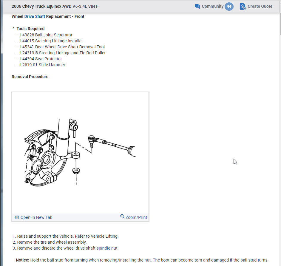

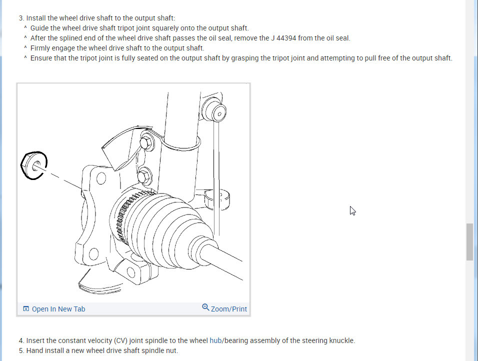

This started three months ago. When i turn right only it makes a hum or squeal stays the same speeding up or anything. Never gets louder same just when i turn right. What could this be? I know it has electronic steering if that is helpful. Any help please.
Jun 27, 2017 at 4:36 PM

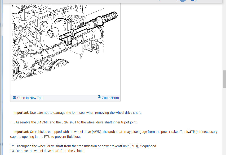

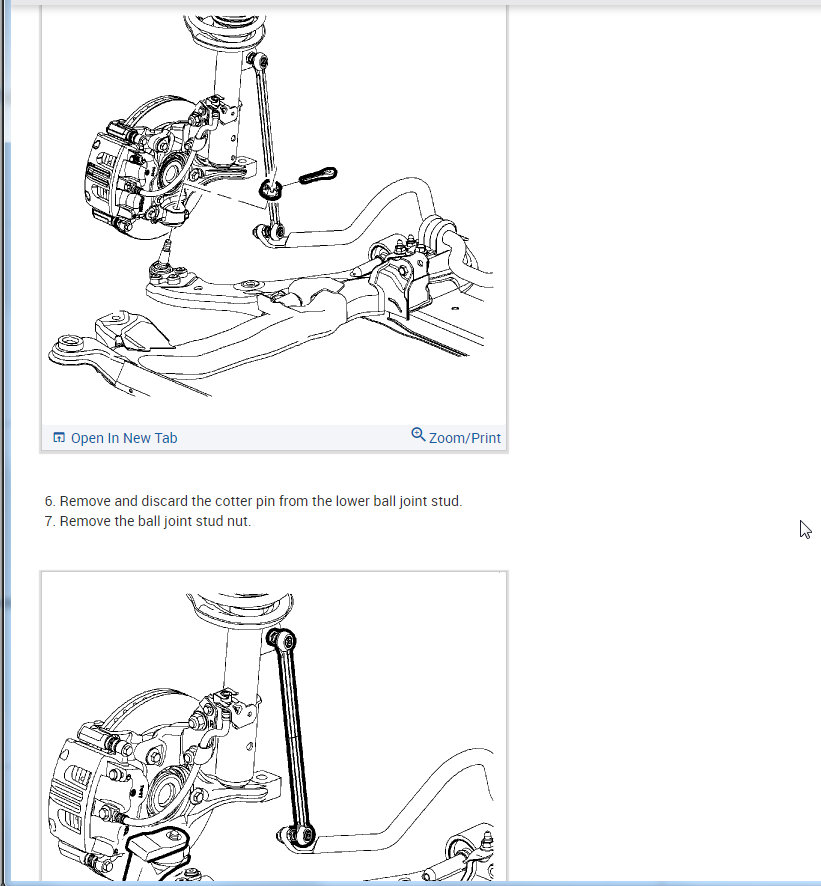

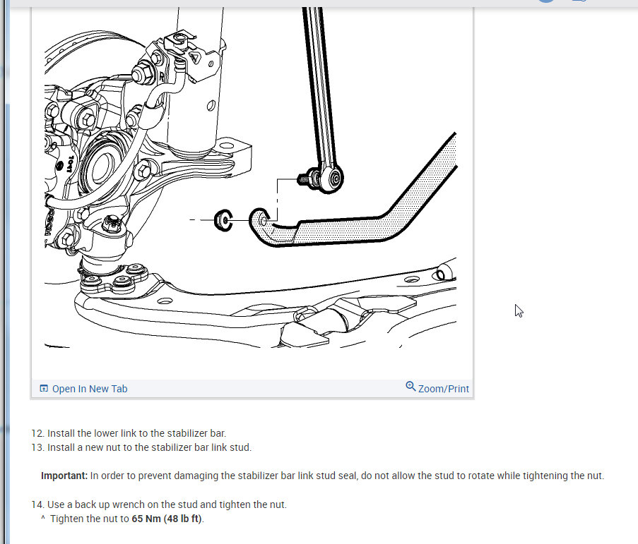

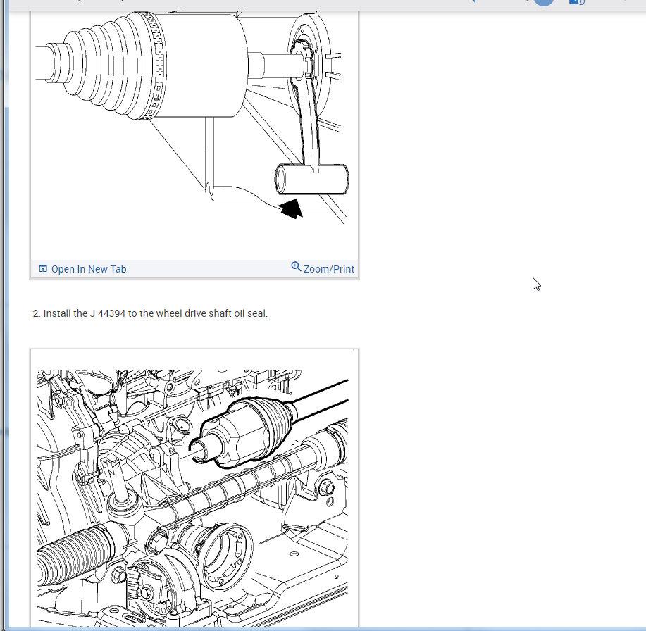

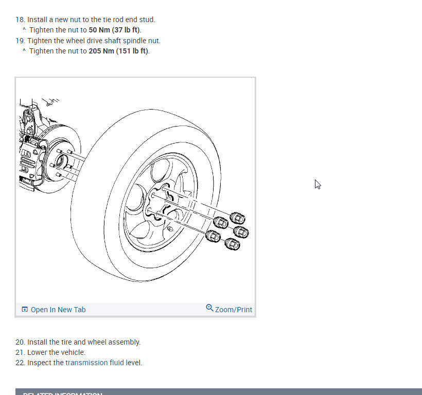

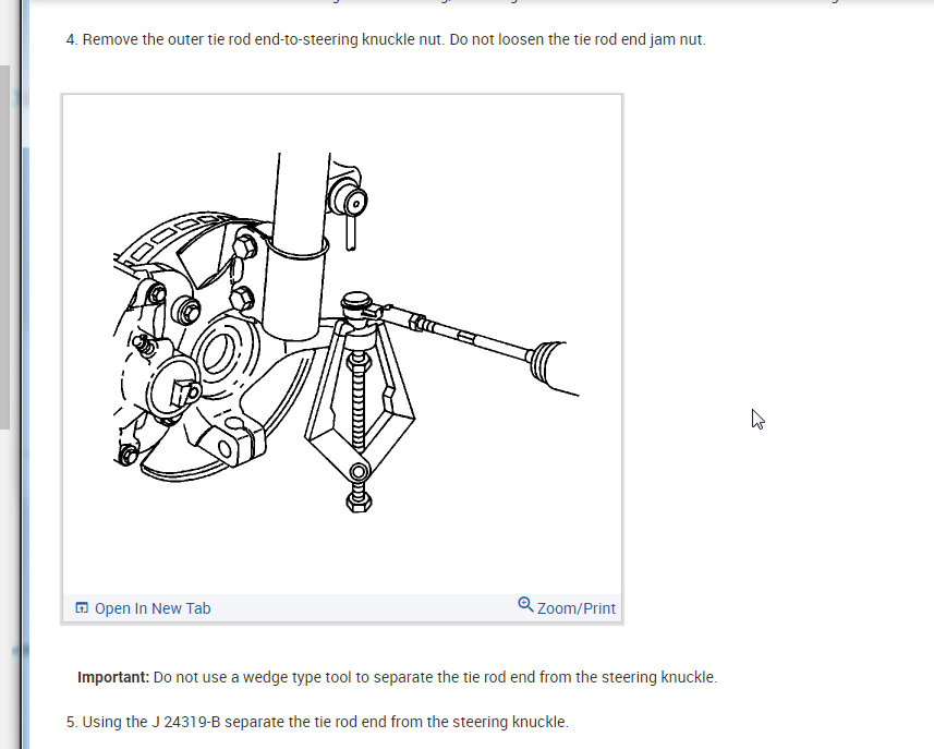

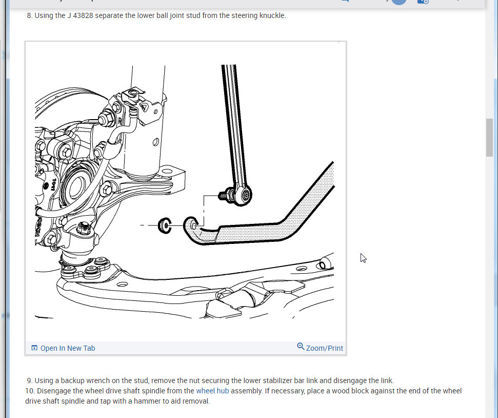

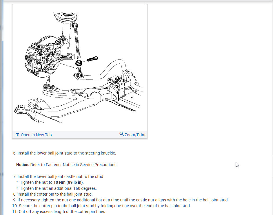

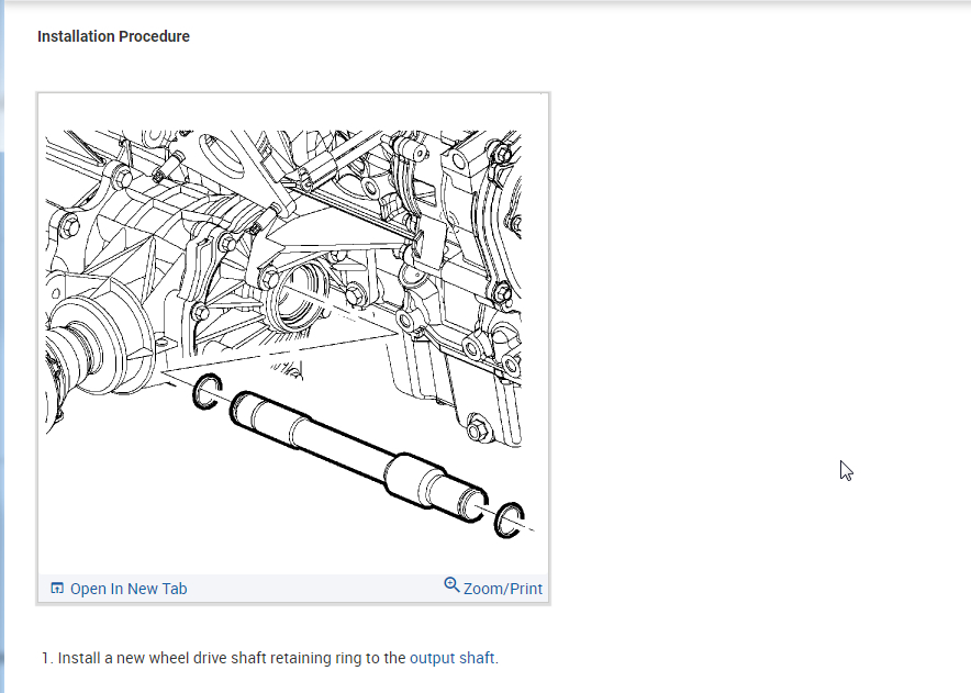

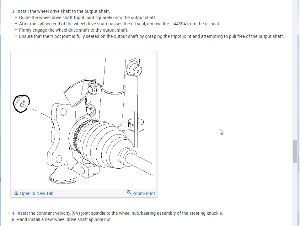

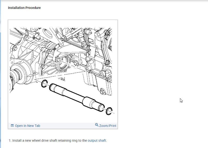

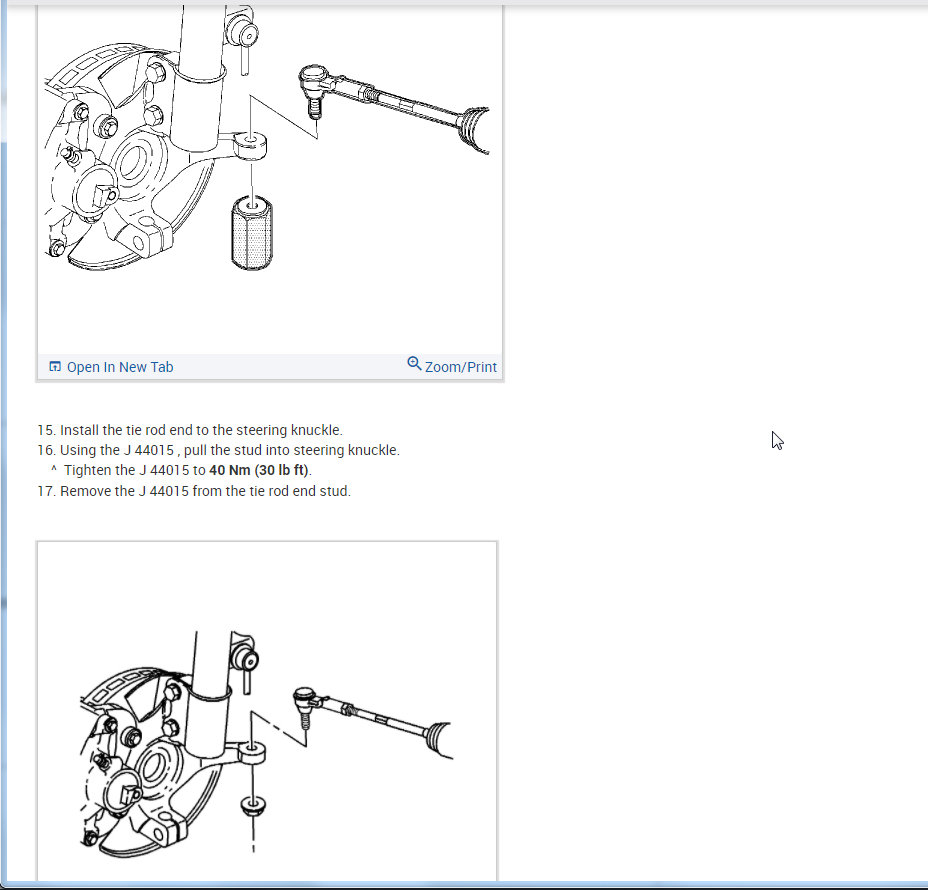

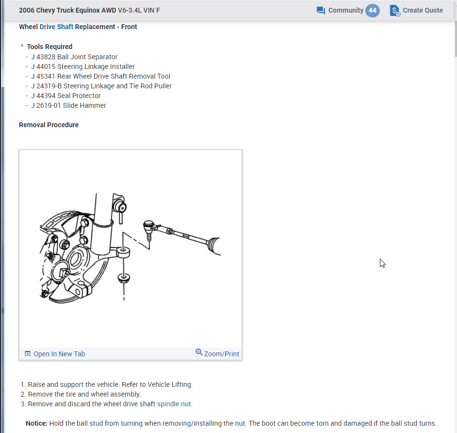

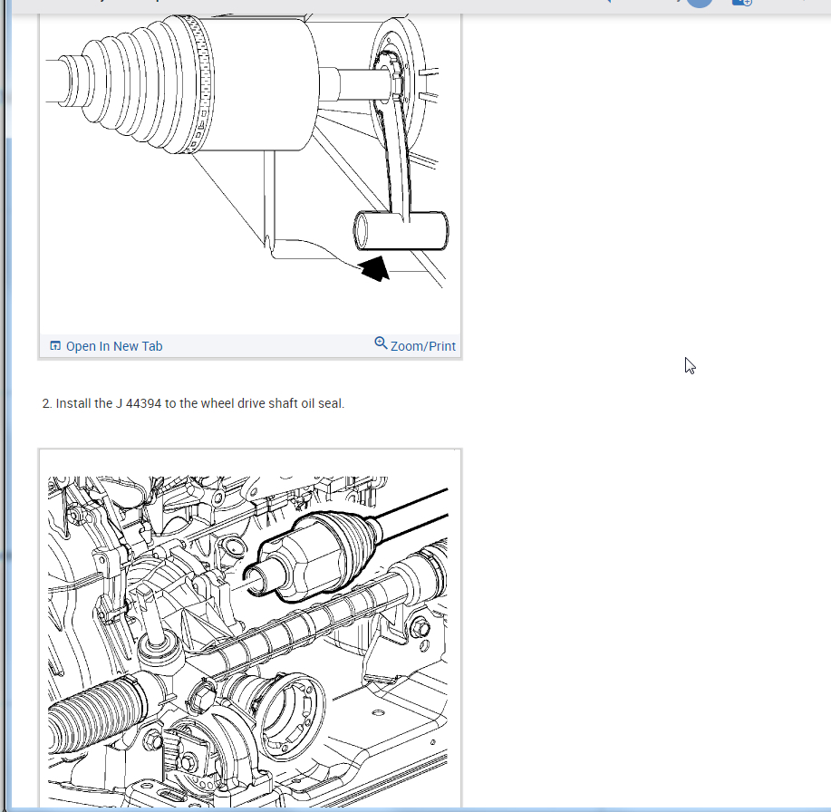

This is most likely a CV axle joint. Here is a guide that will help with this:
https://www.2carpros.com/articles/clicking-sound
https://www.2carpros.com/articles/replace-cv-axle
Also, I attached below the instructions from the manual on how to replace this. I would suggest starting here and going from there. Thanks
