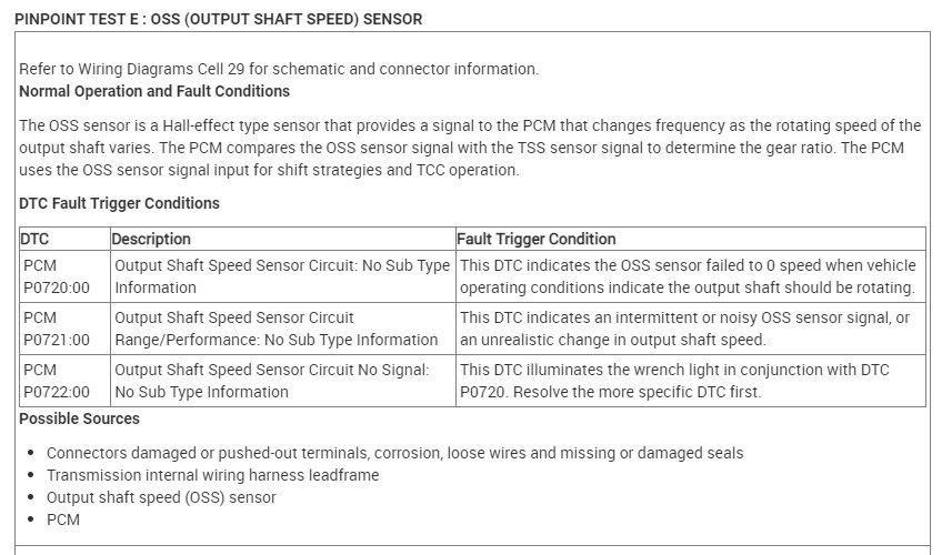

P0316,P0722,U0155,U0253,U0401, and U0452.
Jan 16, 2023 at 6:17 AM
  • 110,194 POSTS

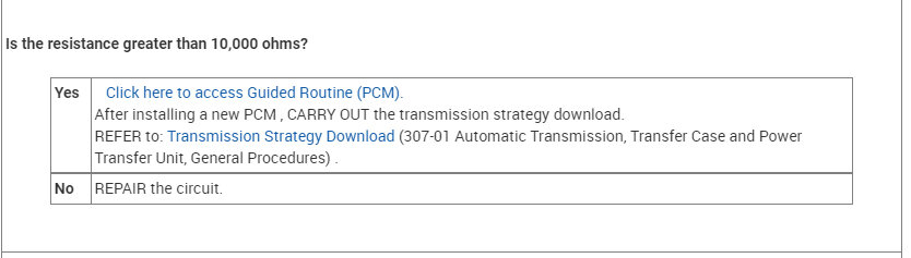

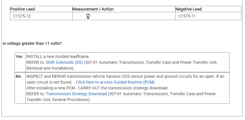

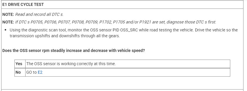

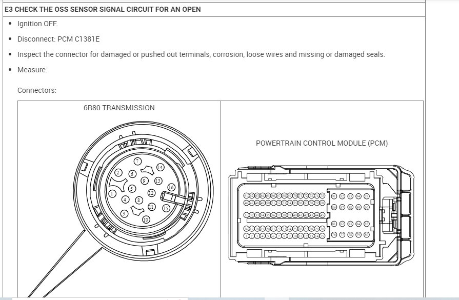

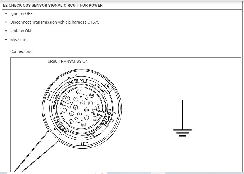

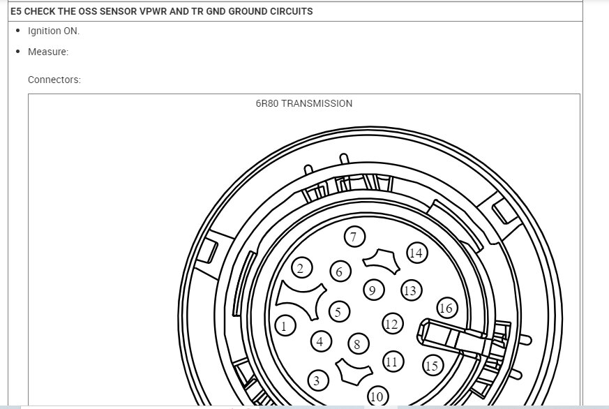

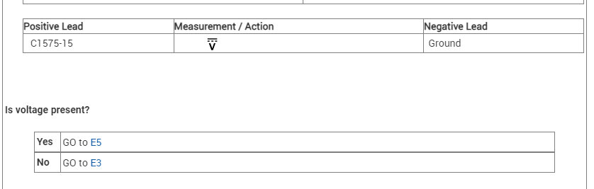

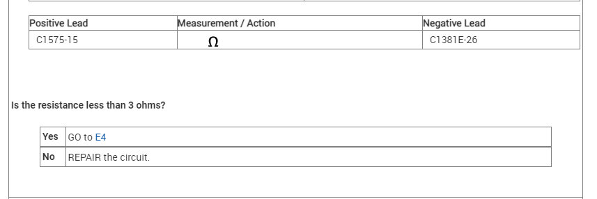

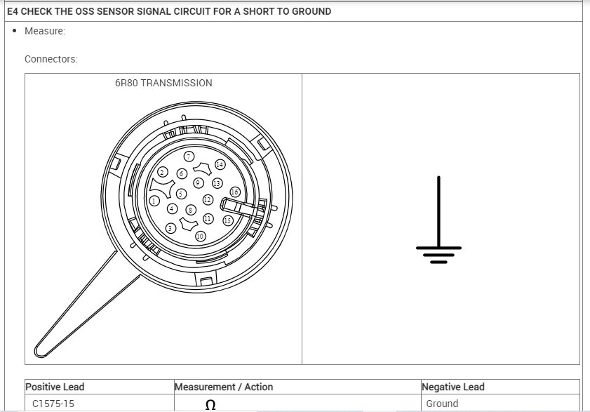

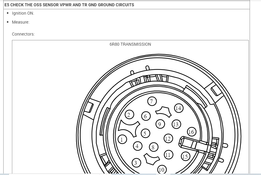

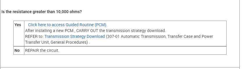

That is quite a list. LOL I have a feeling the problem is the output speed sensor. Actually, it could be the sensor, or a wiring issue related to the circuit.
When I went to code P0722, it directs me to follow the diagnostics related to a P0720.
Let me know if you are comfortable performing this.
