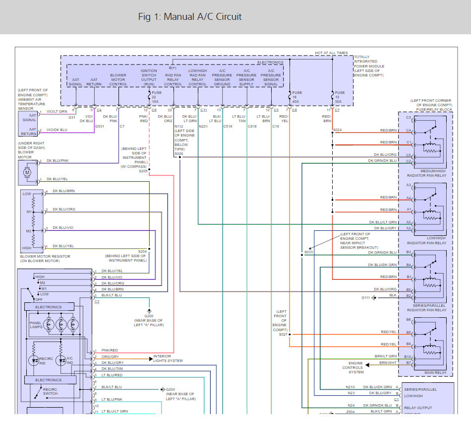

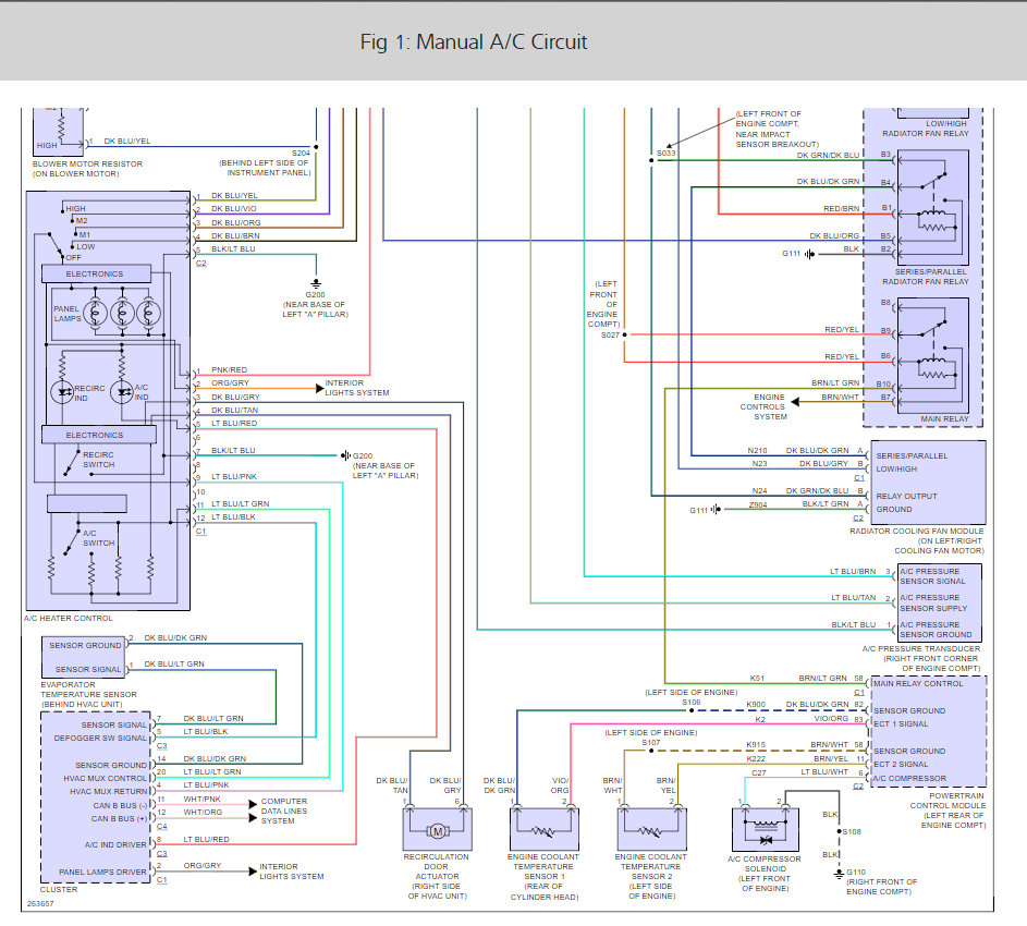

I only have heat on driver side. i have replaced the actuator, no change. i was able to move the flapper door by hand, it is not stuck or broken. i checked the cable hookups they okay, not bent. i noticed that the actuator only tuns one way no matter which setting i have the heat control on,cold or hot. is this normal?
Dec 18, 2017 at 11:11 PM
  • 55,423 POSTS
This sounds like you have a temperature sensor that has gone out which continuously tell the system that it is hot which makes the actuator only go toward cold. Here are the wiring diagrams.

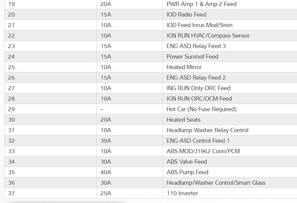

I am sorry I noticed the system is manual (not auto correct?) I would calibrate the system by turning the key on (engine off) and removing the HVAC power for 5 minutes and then turning the key off and replacing the fuse. Here is its location (below). #15 and #18
Jan 11, 2018 at 4:05 AM

I would use this test to check the wiring by diagrams above.
To see if there is a short somewhere or an open circuit. If everything checks out then the controller must be bad. (control head)
Check out the diagrams (above)
