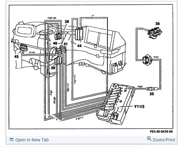

Also, can a faulty vacuum distribution block (the one behind the glove box? cause the issue? I can see the floor door opening but it looks like the others don't actuate at from the vision i have on the passenger side with the glove box out.
Nov 11, 2019 at 9:43 PM
MOTOR MASTER
  • 279 POSTS
It is possible for there to be an issue with the vacuum system when it comes to any of HVAC controls, this is why I asked if you were sure the blend door was moving. Unfortunately that is quite an elaborate system and the first suspect has been eliminated if at least one door is functioning and that is the vacuum supply to the system. I have attached a diagram of the vacuum system for the HVAC in your car, and if you can get to the switch over valve block then you can test for vacuum to the blend door when you switch it from hot to cold. From the diagram it looks like it shouldn't be that difficult to get to. The other thing you could do is supply vacuum to the hose and see if you can tell if the door is moving. What I would do if I didn't have a vacuum pump is get a piece of hose, attach it to the hose going to the blend door and suck on it and see if it moves, I would also put my tongue over the hose to see if the actuator hold vacuum. If alternately if you have a vacuum pump or can get one (around $25.00 at Harbor Freight) and use that o supply the vacuum and see if the gauge stays steady after you supply vacuum. If the actuator doesn't hold vacuum then it will need to be replaced. The other issue that concerns me more is that you are having what sounds like inconsistent temperatures in your cooling system. If the coolant going to the core isn't hot you won't get heat. That being said I again lean toward trapped air in the cooling system which could definitely cause the temperature fluctuation you are describing. I have quite a bit of experience with Mercedes and they can be extremely stubborn about releasing trapped air. The best way to purge the system is to use a anti spill coolant funnel. I have seen them on Amazon for around $20.00.
