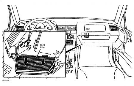

How do I change the Cabin Air Filter?
Mar 16, 2009 at 12:55 PM
GFIMOTORCARS
  • 673 POSTS
The filter is located behind the glove box. You access it by removing the under dash panel under the glove box.
https://images.2carpros.com/forum/automotive_pictures/294900_202_cabin_filter_1.jpg

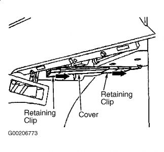

This is held on with either clips or screws. Remove this panel and you you will see the cover for the filter compartment
https://images.2carpros.com/forum/automotive_pictures/294900_202_cabin_filter_2_1.jpg
Remove the retaining clip and the filter will slide out.
