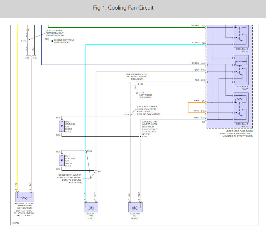

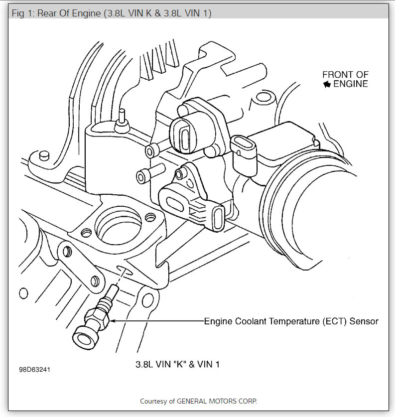

I would try replacing the engine coolant temperature sensor which controls the fans via the PCM. Here is the fan wiring diagrams so you can see how the system works and the location of the sensor with a guide to show you the steps to replace it:
https://www.2carpros.com/articles/coolant-temperature-sensor-cts-replacement

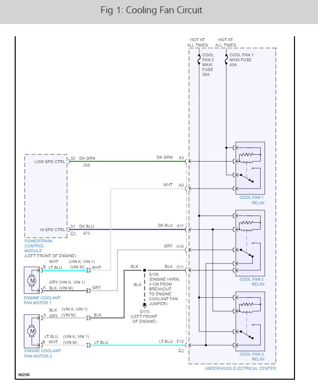

Electric cooling fans will not turn on when engine gets too hot. I checked the fuses and relays. They are good. I replaced the CTS and it did not fix the problem. I did discover that if I disconnect the electrical connector to the CTS, the electric fans will turn on and stay on. I have left the connectors disconnected temporarily so that the engine does not over heat. In doing this, I've noticed a drop in gas mileage. Please help. Oh, the radiator fluid level is good.
May 26, 2021 at 5:19 AM (Merged)
HMAC300
  • 48,601 POSTS

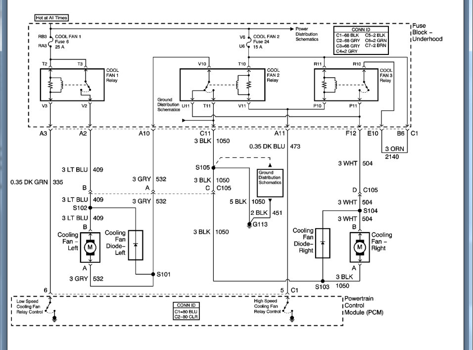

the reason your gas mileage dropped is you disconnect the cts and it doesn't control the fans. plug it back in. There are 3 relays not 2 and 2 large fuses. they all must be checked. I'm including a diagram. If it's not a relay, then you'll have to have a pro check it for a bad connection or shorted wire coming from or to the pcm.... Heres a guide on checking relays and one on testing wiring, they will help you figure this out https://www.2carpros.com/articles/how-to-check-an-electrical-relay-and-wiring-control-circuit https://www.2carpros.com/articles/how-to-check-wiring
https://images.2carpros.com/forum/automotive_pictures/406719_relay_diag_1.jpg

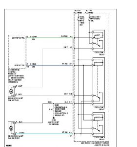

Radiator fans do not work. I have replaced all 3 relays, as well as the coolant temperature sensor. The fans do come on when connected to direct power as well as coming on when the a/c is is turned on, but they only operate at a low speed with the a/c. Any ideas?
  • 55,851 POSTS
You have two main power fuses, 30 and 40 amp in the main fuse panel, check these first, then check for power/ground at the relay, if all checks out you will need to check the electrical wires step by step with a wiring diagram below.
Check out the diagrams (Below). Please let us know what you find. We are interested to see what it is.

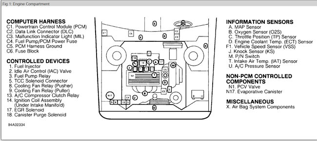

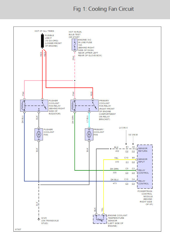

I have recently replaced the ECM thinking it is bad b/c the cooling fan and AC fan are not coming on. Even when turning on the AC, no fans or compressor. The new ECM made no difference.
The relays and fans are fine. I believe that the cooling fan relay "should" have a hot link to the relay and the ECM then grouns the other side causing the relay to close. I did not have the "hot" side on the relay and when I cut and jumped this wire to Hot, the cooling fan will turn on and off with engine temp.
Is there a fusible link in the wiring harness that supplies the hot side to the cooling fan relay? If so, where is it and what are the wire colors? I was told to look for a real along side the steering column but cannot find anything inside the passenger compartment.
In summary, ac compressor, fan and cooling fan not working. Fuses in fuse block are fine. No hot wire to cooling fan relay. Is there a fuse somewhere inline?

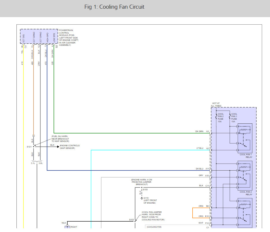

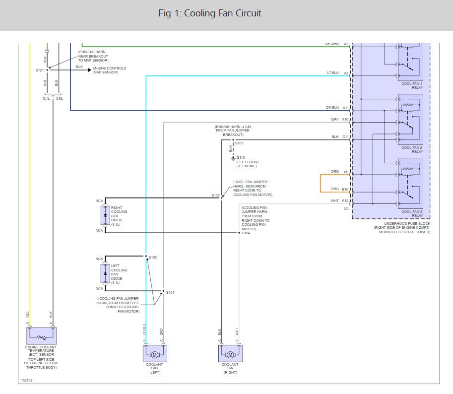

Here is the fan wiring diagrams and the relay location and a guide to help you test the relay.
Cheers
DALICH
  • 7 POSTS
Okay, judging by the wiring diagram it is looking like the 10A in-line fuse (behind the right side of dash near upper left rear of glovebox). The fuse center is located in the glovebox. I removed the glovebox where I can see all the way back to the firewall. I cannot find this inline fuse. There are a bunch of pink wires, but I cannot find this inline fuse. it is a 1995 Buick Century 4 cylinder 2.2L
I have a very good view, I just do not see this inline fuse.
Never mind....... Just found it. 3 fused links were taped together out of sight. Felt like a plug but when unwrapped I found the fuses. 10A, pink wires, blown. All fixed! thanks I love this site.
