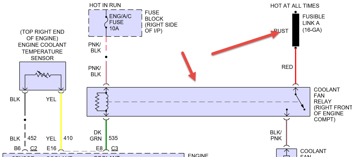

with the car running when cooling fan kicks on, but not every time, but on occasion the car will idle rough. checked fuel pressure about 40 lbs. While checking the fuel pressure I took the fuel pump fuse out then put back in and the cooling fan kicks over when inserting fuse. So my question is why would the orange wire that comes off fuel pump fuse that goes to oil pressure sender and to ecm? Would it affect the green wire that comes from ecm to the cooling fan relay? That is hot until the ecm is told to shut off power to the fan relay to turn on fan. Correct me if I am wrong. Thanks.

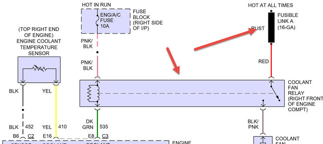

first thing the fuel pressure should be 41-47 no lower or will give problems. The wire you are talking about has nothing to do with system it may be a partially broken fusible link and was a coincidence. check the items in picture then the coolant temperature sensor wire connection and switch, some of those had problems.

When the car is warmed up it will kick the fan over just enough to get it to spin over a couple of turns by unplugging the fuel pump fuse I can unplug it and plug it back in it will spin the fan over I have unplugged the fuse and plugged it back in as many as 6 times all within a few seconds and it spins the fan everytime. It is the craziest thing I have ever seen. When just checking voltage with multimeter on the green wire of fan relay it stays stable till I plug the fuel pump fuse in then the voltage drops. I installed a new coolant sensor and the plug looks good.

The wiring going from the oil pressure sensor is to cut the fuel pump when there is no oil pressure to save the engine from internal damage. It is normal for the cooling fan to move slightly when the engine starts/fuse installed etc, the ecm controls it so a small command for the computer when activated is normal.
