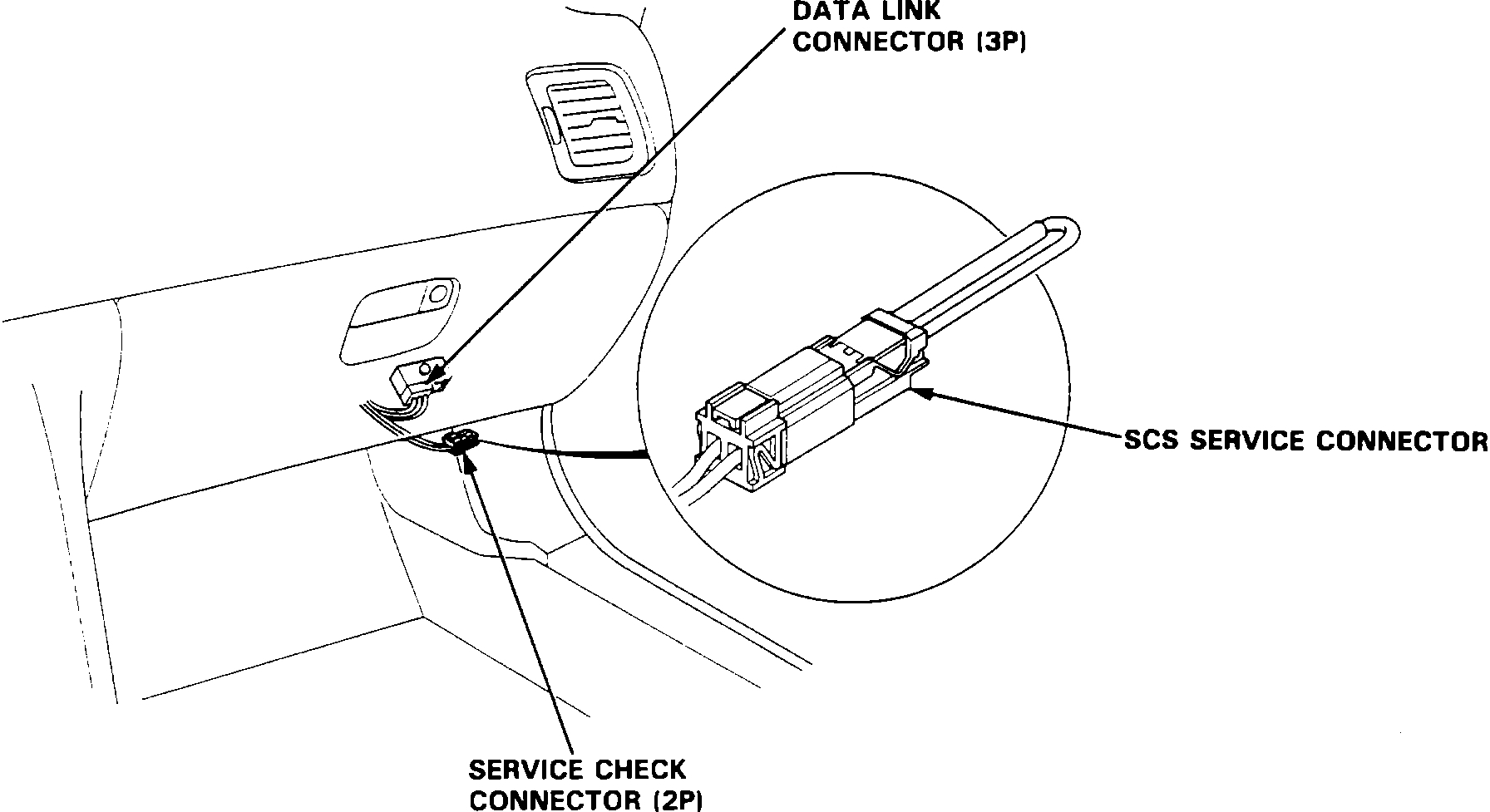

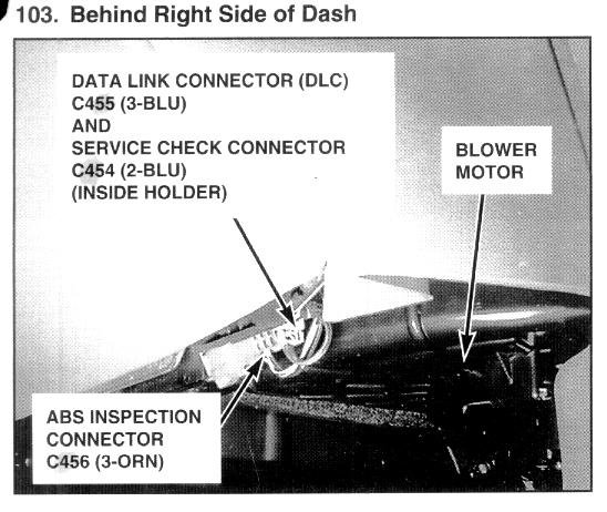

Joe, thanks for the diagnostic steps. I haven’t done a tune up recently but I did pull each plug to check it’s condition. They all four look dry and normal. I was expecting to see some carbon on the cylinder which was missing but that provided no insight. These plug wires have integral coils for each plug so I’m wondering if the low rpm missing could be due to one of them. I don’t have a check engine light illuminated so will the codes be stored? In the mean time I’m still searching for the OBD 1 connector. Compression is good and within the tolerant between cylinders.

The data link connector is on the passenger side behind the glove box. I attached two pictures for you to help locate it.
Now, if you know which cylinder is presently having a misfire, then here is what I suggest. Switch that coil with another cylinder and see if the misfire changes cylinders. You will need to scan it to do this, but if it changes cylinders, replace the coil.
