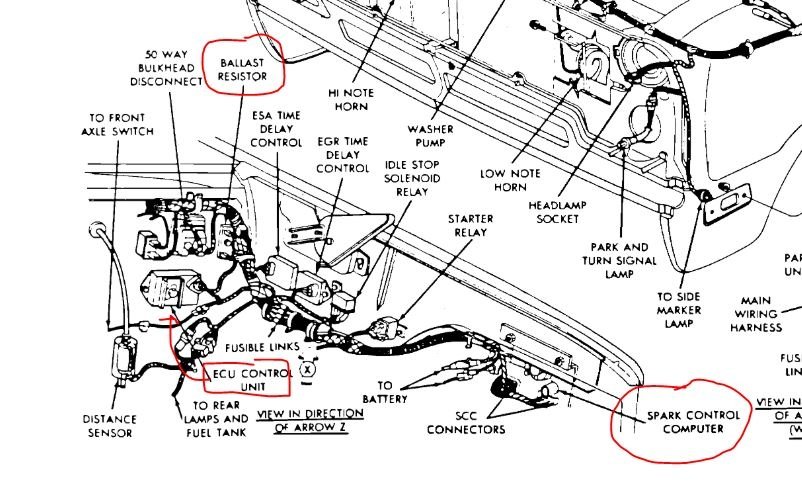

Once the truck warms up it stalls out

I've been told it's the ICM, but no one seems to be able to show me the location of it. .any advice would be helpful.

Are you referring to the ignition control module? If so, Chrysler called a spark control computer. I attached a pic for you. When you open the hood it will be on the driver's side at the front of the inner fender. I circled three different things that can cause issues; however, if you lose spark, the spark control computer is my first suspect.
Let me know if this helps.
