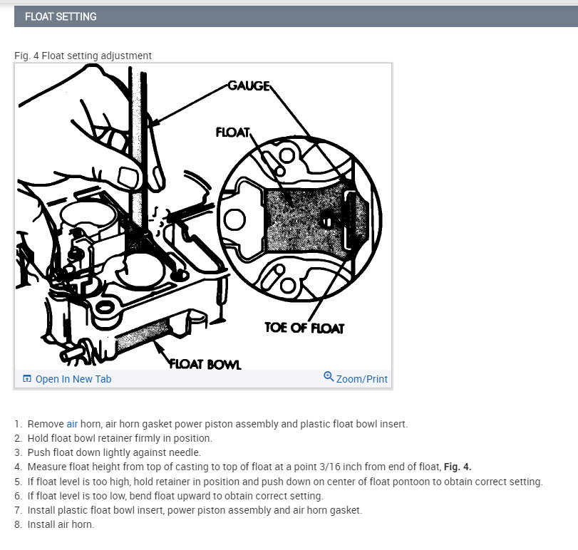

As mentioned if we can start the vehicle using starting fluid, that would point to a fuel issue. However, on your carburetor it was common for the floats to stick which would either flood the engine or starve it from fuel. So we need to check this to see if it is the issue.
