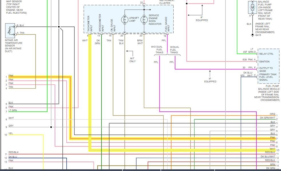

I think my signal wire for ignition module and ignition coil grounded out
DAVISMELODY6669
  • 1996 CHEVROLET SUBURBAN
  • 5.7L
  • V8
  • 2WD
  • 220,000 MILES
I used a test light to the white wire and it did not light up. How can I make it ungrounded? I have no spark. My truck only turned on once idle strong and then I tried to turn on again and nothing, no spark?

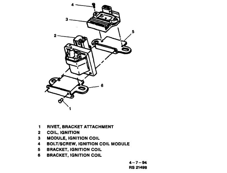

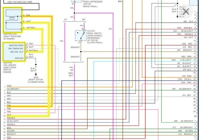

Using test light for the module I have feed and ground with key on, but when key on the white wire the signal I have no light. Clip on +battery pointing to white wire light is on, turn the key and light goes off for both module and coil connection. Is that normal?
Monday, January 6th, 2020 AT 9:14 AM
  • 52,797 POSTS
Put the clip on the ground on the battery. Test for power on both sides of the coil. Then crank the engine. The test light should flash on the negative side of the coil while cranking.
Monday, January 6th, 2020 AT 9:18 AM
DAVISMELODY6669
  • 65 POSTS
Crank and test for power feed and test the other wire that comes from the module? White and black wire? I ignore the white wire the tachometer.
Monday, January 6th, 2020 AT 10:32 AM
  • 52,797 POSTS
Yes. Test the white black wire to see if the module is working.
-1
Monday, January 6th, 2020 AT 10:39 AM
DAVISMELODY6669
  • 65 POSTS
I tested the feed on both both coil and module light stay on. Checked ground light stayed on. Checked the white/black wire to them n light stood on. And the clip was hook to (-) battery. They all got little almost nothing dim because of the amp of the starter.
Monday, January 6th, 2020 AT 11:11 AM
  • 52,797 POSTS
If the light does not flash, the module is the issue and needs to be replaced.
