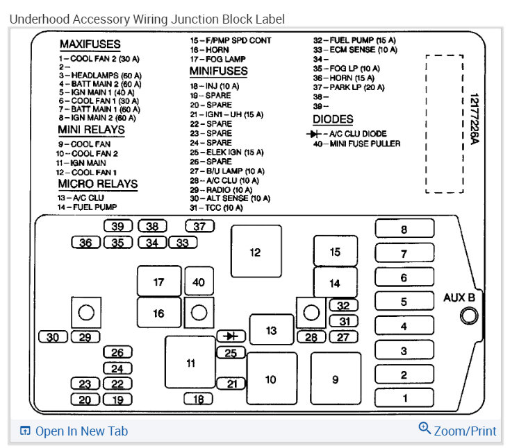

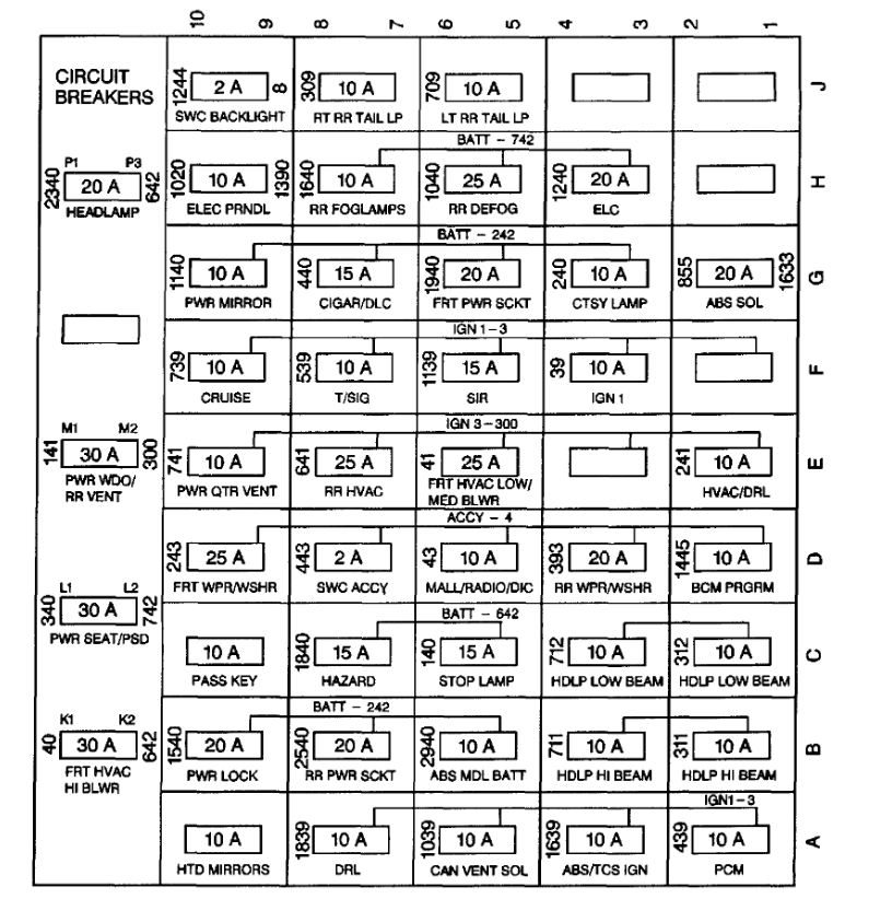

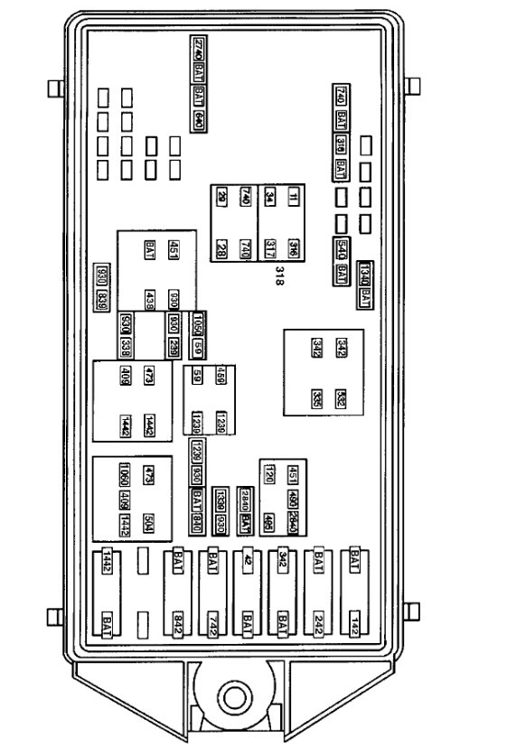

My wife was driving home one night in the dark, half way home, all of a sudden all the "white" dash lights went out. There are still a few colored lights on but all the back light went out on the instrument panel, radio, and climate control. Everything works fine, you just can't see how fast you are going, what preset button on the radio you are hitting, or if you're turning on the heater or defroster. I checked the obvious things, headlight switch and instrument panel switch don't change anything (Headlights work and I can still turn on the interior lights with the dimmer switch). I then checked the fuses and didn't find any blown, the only one that made sense for the instrument panel also included the radio and that works, so I just pull them out one by one checking them, including the fuse box under the hood.

suspect fuse
use a test light
turn lights on and check fuses
check fuse box right side of dash

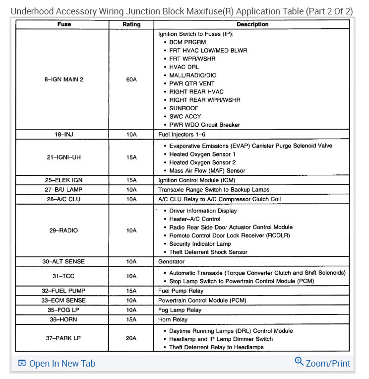

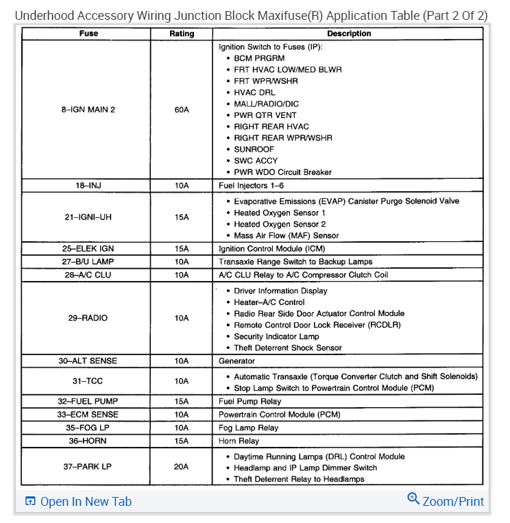

Under hood accessory wiring junction block
park light fuse 20A
If all fuses checked OK

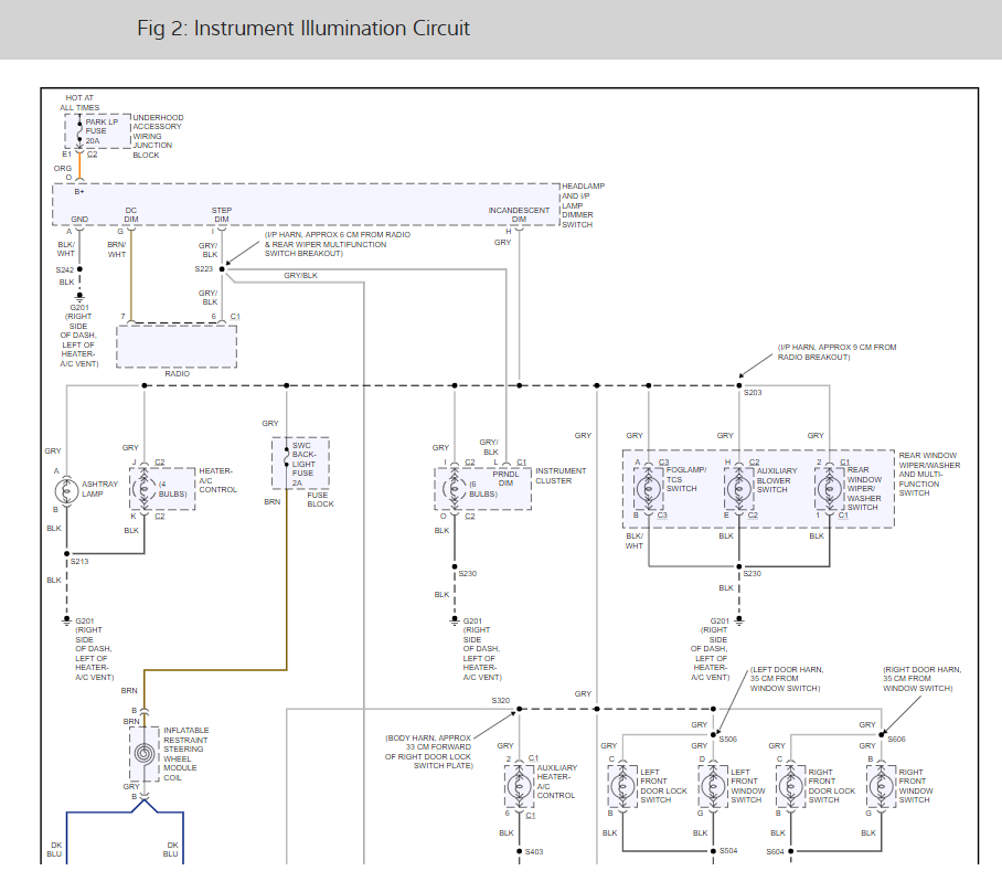

check GRY/BLK wire with light on
should have battery power
Oct 21, 2009 at 11:45 AM
DOOGALOB
You were right, it was a fuse. The obvious ones where fine, it ended up being one in the fuse box under the hood. I can't remember the exact name the manual called it but it wasn't an obvious name connected with the lights of the instrument panel. I had missed it when I checked each fuse, it was in a cluster that I had thought to be holding all the extra fuses.

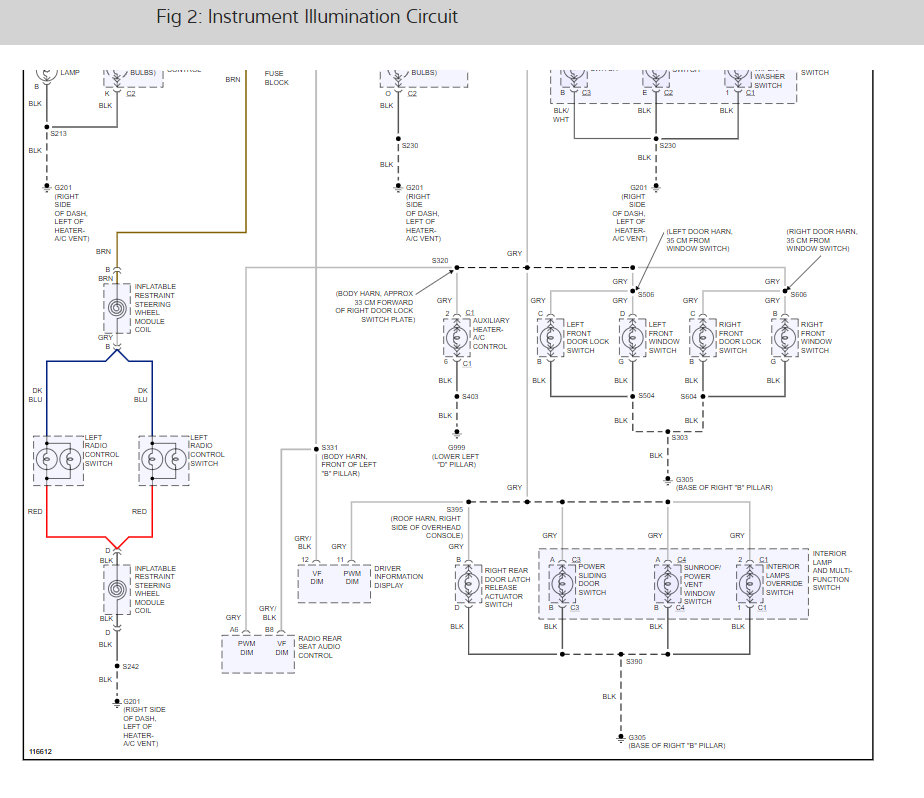

I have the same problem with my 99 olds silhouette stated above
All of my instrument panel and lights around radio are not lit up . Driving in dark can’t see cluster lights
When I turn on overhead light I can see gauges do work . Rpm gauge, speedometer , coolant needle still work
Tried everything , checked fuses.
I suspect it’s the headlight or dimmer switch
It also chimes really fast when I open door as well
Anybody have any solutions
Sep 4, 2019 at 11:47 AM
  • 55,433 POSTS

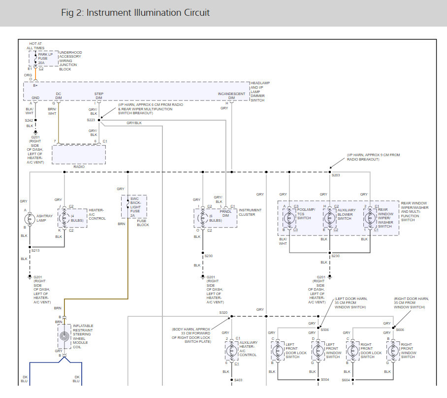

It sounds like the headlight switch is not working right but to be sure here is a guide to help check for power and the instrument light wiring diagrams so you can see what to test and how the system works.
Check out the diagrams (Below). Please let us know what you find.

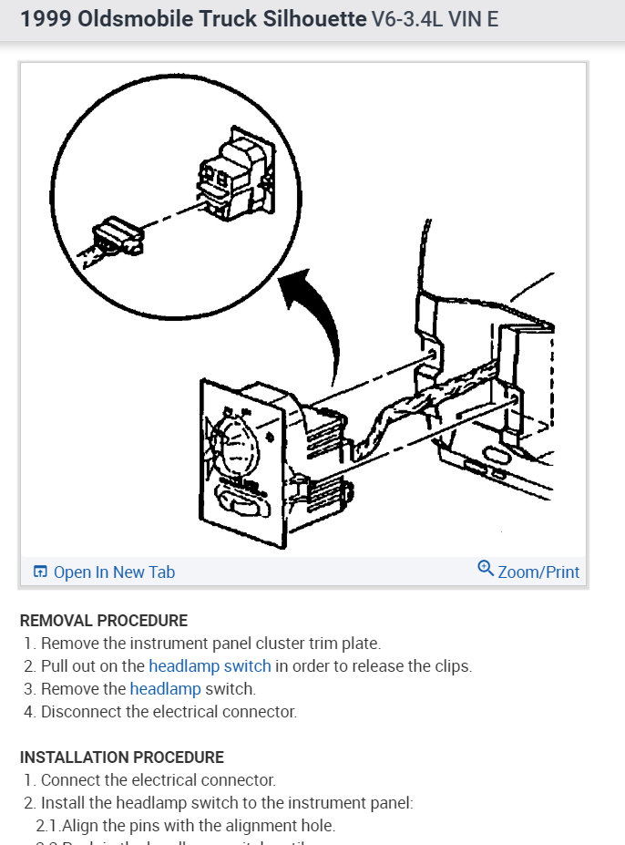

I changed the dimmer switch it did not work. This is a mystery. Any other options you can recommend

Is the orange wiring going into the switch getting power? (Key on ) This guide can help:
Oct 23, 2019 at 5:29 AM
RKIIHN

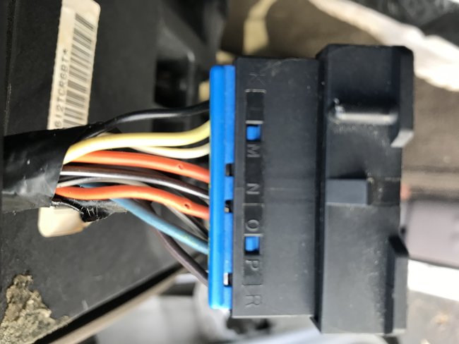

If you look at the switch plug there were 2 orange wires.
1. The orange wire with N inscribed in the plastic casting has power
2. The orange wire with O inscribed in the plastic casting had no power. I tried many times.
Hope this helps and you can help me trouble shoot.

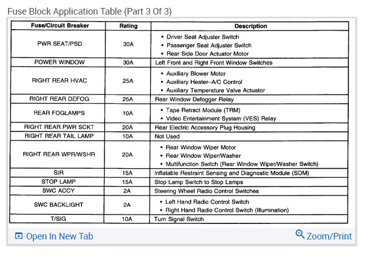

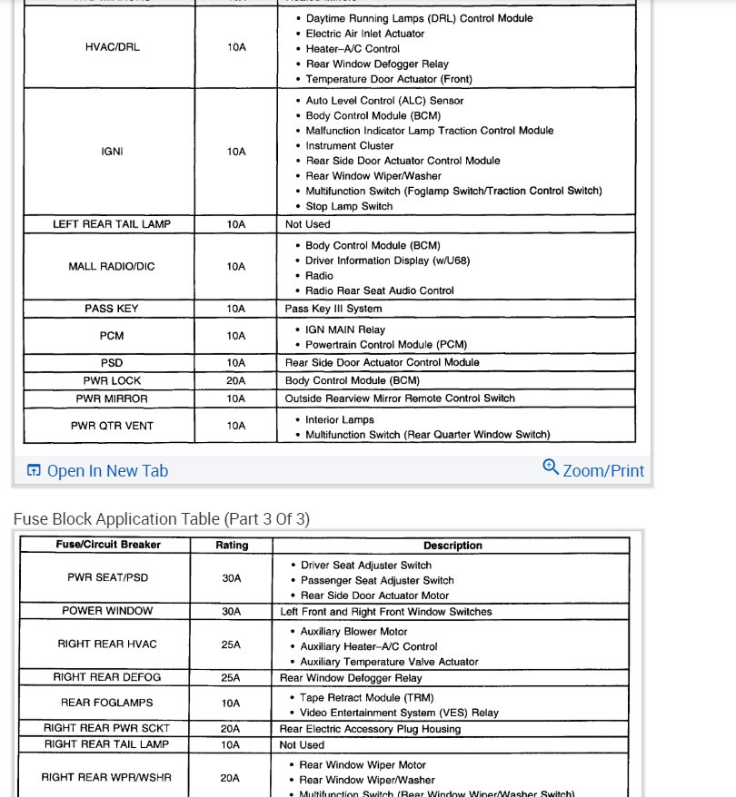

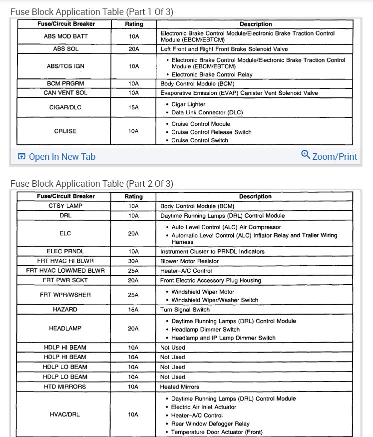

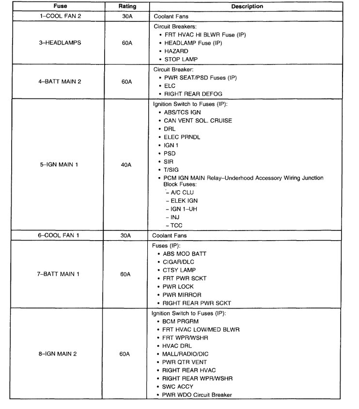

With no power is the problem can you use your test light and check fuse "Park Lp" to see if it has power key on?
The fuse location and identification are below. Check out the diagrams (below). Please let us know what happens.
Oct 26, 2019 at 5:10 AM
RKIIHN
I used the test light for checking park LP.
The test light lit up with key on.
Fuse #37 works.

The orange wire at the switch must have power for the system to work. There must be a break between the fuse panel and the switch. If you put power to the orange wire does the system come on?
Oct 28, 2019 at 3:25 AM
RKIIHN
I put power to the orange wire the instrumentation lights did not come on.
Someone said in this previous post to check the grey/black wire . Could that be issue?
Oct 29, 2019 at 6:18 AM
  • 55,433 POSTS
Do you have power at the orange wire and ground at the black and white ? If so the switch is bad, work the dimmer part of the switch.
This guide will help:
