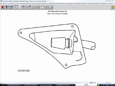

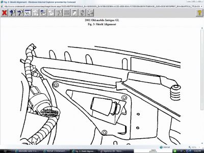

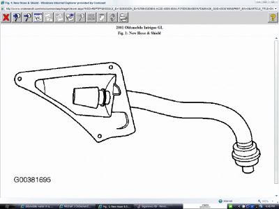

I have a 2001 olds intrigue that I heard a water bubbling sound from the left front engine. Took it to the dealer and they replace the A.I.R. pump said it had water in it and was shorted out. 2 days later I hear the bubbling noise again. Any idea where the water might be coming from before I go back to the garage
Nov 10, 2007 at 12:21 AM
MERLIN2021
  • 17,250 POSTS
There is a technical service bulletin on this problem, and revised parts are to be used to fix it here's the info! TSB Reference number: 04-06-04-037 Date of issue May 27, 2004
