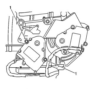

My driver side 2 vents will not blow out cold air but the rest of the vents , the 2 in the backseat and the 2 on the passenger side blow cold ...what is the problem and how can i fix it ? Thanks .

The car probably has duel zone climate control. I would remove the left side kick panel under the dash and look at the actuator for the left side(see pic) make sure that it is moving. Sometimes you can wiggle the wires around and get them to work.
https://images.2carpros.com/forum/automotive_pictures/86485_292138_1.jpg
The #'s are for the bolts that hold t on... Cly
