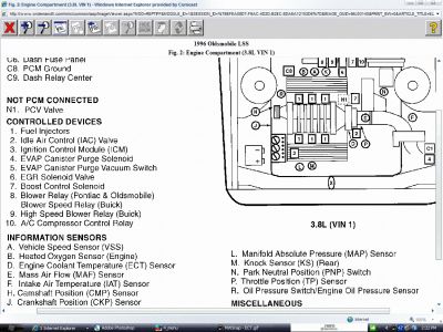

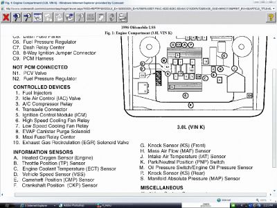

sometimes i start my car and it sputters and i have to let it run (if not it will shut off when i attempt to drive it) so i let it run for about 20 seconds and then the engine will rev up (on its own) and then it goes away and then i can drive sputter free.
3.8 liter V6 (not SC)
127,000 miles

Try this, the electronic coolat temp sensor, two diagrams, depending on what VIN you have.
https://images.2carpros.com/forum/automotive_pictures/62217_ECT_3.jpg
https://images.2carpros.com/forum/automotive_pictures/62217_ECT2_1.jpg
C location on first one D location for second one...
