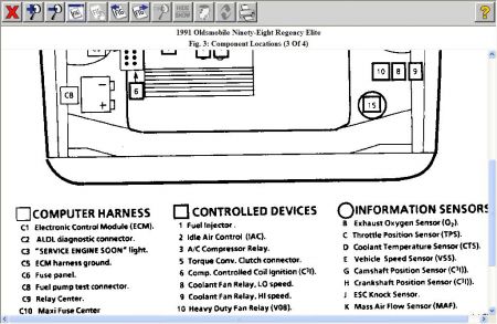

BRIANSNYDER
I checkeed the fuses first, all good. The fan works, thanks for telling me which wires are pos. and neg. So it must be the relay or a comp. problem. I would like to know which relay controls the fan? There are 6 relays under the maxfuse/relay center panel under the hood. I checked the one directly under the 40 amp fuse, but it wasn't it. I am having trouble getting some of them off without cracking them. Is there any secret trick, and which one is the exact relay? Thanks a bunch for your help so far.
Jun 5, 2008 at 12:24 PM
  • 75,992 POSTS
See 8 and 9 fan Hi/Low relays below

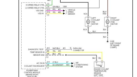

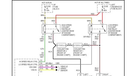

BRIANSNYDER
I checked the relay and its not it. I jumped the red main wire and the black/red wire at the relay and the fans turned on. I checked the brown wire with my multimeter and it has power with ignition on. autozone.com said it was either an open circuit or an ecm ground, but I have no idea where to look for those. Is there any way to ground the ecm again and where is the ecm located and the ground for it? You've been a ton of help so far. I might just wire the fan manualy, but I don't want to damage anything on the computer. I just think its wierd that if it is a bad ground there is no diagnostic light coming on. Thanks again.
Jun 7, 2008 at 2:25 PM
  • 75,992 POSTS
Troubleshoot the fan circuit see below-The computer grounds the relay-when it sees the coolant temperature sensors input signal requiring the fan to come On.
