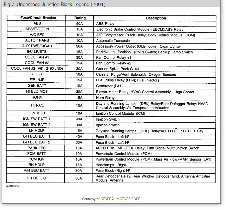

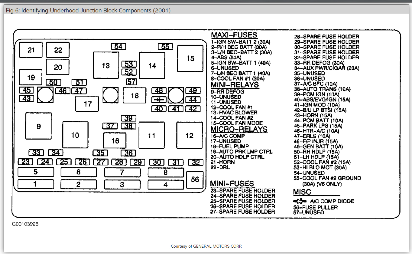

I have a 2001 oldsmobile Alero and the tail lights, dash illumination lights or parking lights are not working. I have checked fuses and bulbs and am not sure what to do next....any help in remediation this problem is greatly appreciated. Also...could you tell me where the a/c recharge port is.
Aug 28, 2007 at 12:13 PM
NICOLEALEROOWNER01
There is a lamp control relay that is not working right here is a guide to help you test it and the location of the relay below.
Oct 3, 2007 at 8:57 PM
MARVCLOTT
  • 0 POST
Thanks for this post I had this problem and got a new relay for $24.00 all fixed! I love this site.
