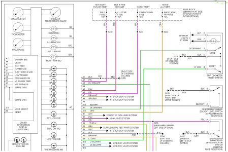

CAR WOULD NOT START. AAA CAME TO JUMP START CAR. HOOKED UP WHAT IS SUPPOSED TO BE A FAIL SAFE JUMPER PACK. TURNED ON KEY GUAGES STARTED TO SPIN. TOOK TO A FIRESTONE STORE & HAD A BATTERY INSTALLED. GUAGES ARE STILL MESSED UP. TEMP GUAGE WORKS BACKWARDS, FUEL GUAGE IS PINED ON BACK SIDE, ODOMETER WENT FROM CORRECT MILLAGE TO 388670 SOME TIMES IT SAYS 9999999, TRIP METETR 10TH DIGIT RUNS LIKE 10TH'S, OIL LIGHT COMES ON STAYS ON THEN BLINKS APPOX. 2 MIN, THEN GOES OUT & GEAR SELECTOR LIGHTS IN DASH DON'T MOVE 3 STAY ON. DISCONECTED BATTERY TO REST COMP, DIDN'T WORK. PLEASE HELP! IT'S MY DAUGHTERS CAR.

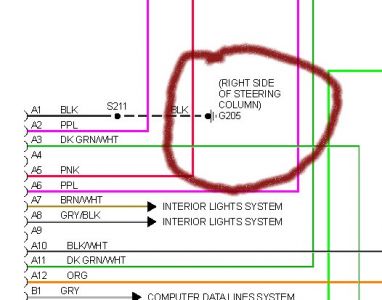

I'll see if I can get a procedure, but I am expecting the cluster is bad. Check this ground:
https://images.2carpros.com/forum/automotive_pictures/30961_clus2_1.jpg
https://images.2carpros.com/forum/automotive_pictures/30961_clust1_1.jpg
If it is good, you 'll need to get the codes with a scanner to find out which way to go. Post the codes and we may be able to go further.
