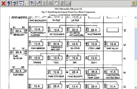

HI, I have a problem with my van. When i take off and go like 40 to 50mph and let go of the gas pedal, the van still stays at that speed, unless i apply the brakes, then it takes a little longer to stop. Also, if i'm in a dead stop, and not pressing the gas pedal, the van slowly goes to 30mph, by itself. Other than that, the engine runs perfect, even when in park. I wanted to know if anybody knows what the problem could be? I would appreciate any kind help on this. Thanks.

The cruise control has to be set to activate it. Find the fuse no.739 10amp in the instrument panel fuse block and remove it this will make it inoperable and see what happens Could also be the throttle position sensor way out of calibration fooling the computer that the engine needs fuel when not needed.
https://images.2carpros.com/forum/automotive_pictures/12900_cruise_1.jpg

Hi, Thank you for your kind help. One thing i forgot to mention is, when i bought the vehicle yesterday, it was running with the low fuel light on, for about 20mins. We put gas and then drove on the highway to go home, we turned the cruise control on, it worked. Then after 30mins of highway driving, we came to city limits, which was 45mph or less. Then this started happening. I am disabled, with a leg injury, and i live on limited income, and if i take it to a dealership, they might start guessing, and charge me with parts, not needed to be fixed. I would appreciate kindly, if you can help me with this problem. Thank you, again.
