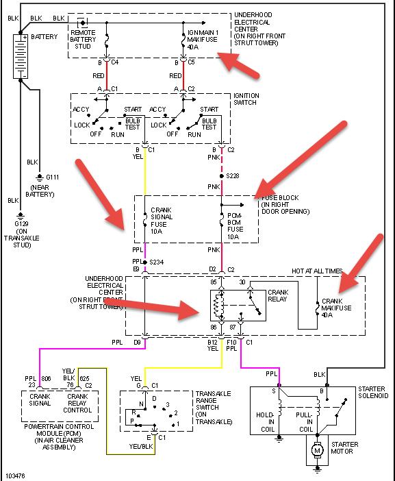

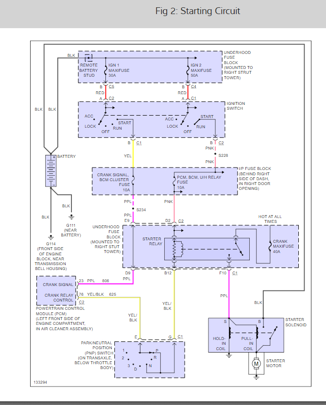

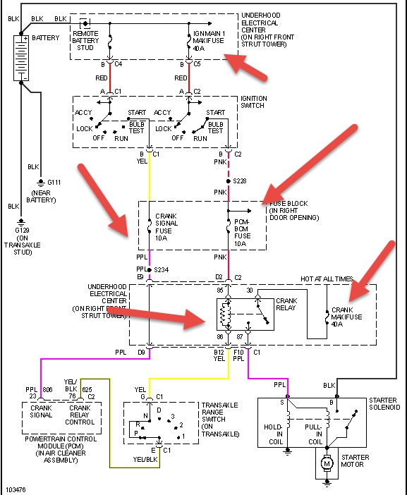

Okay here is my nightmare: Customer's car would not start after sitting overnight. Turn the key on and everything is normal. If you try to start it you get nothing. I tried a new ignition switch with no luck. So I put the old one back on. I also tried the lock cylinder with the pass lock on it because the key would hang up and you could partially remove the key with it on. Still nothing. It will turn over if you jump the starter terminals across but will not start. I tried a BCM and reprogrammed the pass-lock security system again, which takes over thirty minutes, and still the same symptom.
No remote starter or any other aftermarket parts. BCM does not have anything to do with the starting system. No codes. Ignition switch is throwing all the right voltages. The problem is in the starter relay. It has b+ through the 40 amp fuse in the power distributor box and at the relay terminal. The system works like this. Ignition switch sends two signals to the PCM, a crank signal and a crank relay signal from the PNP switch, this signal tells the PCM to ground the relay which sends the 40 amp power to the purple wire that goes to the S terminal on the starter. I have correct power to all wires except the PCM is not grounding the wire that switches the relay. So after triple checking all wires, one would say PCM, so I got one and had it programmed and still same symptom. I have a fellow tech that works at a GM dealer and he does no have an idea either. Anyone want to give it a shot?
Please help!
Sep 7, 2010 at 4:47 AM
BMRFIXIT
  • 19,053 POSTS

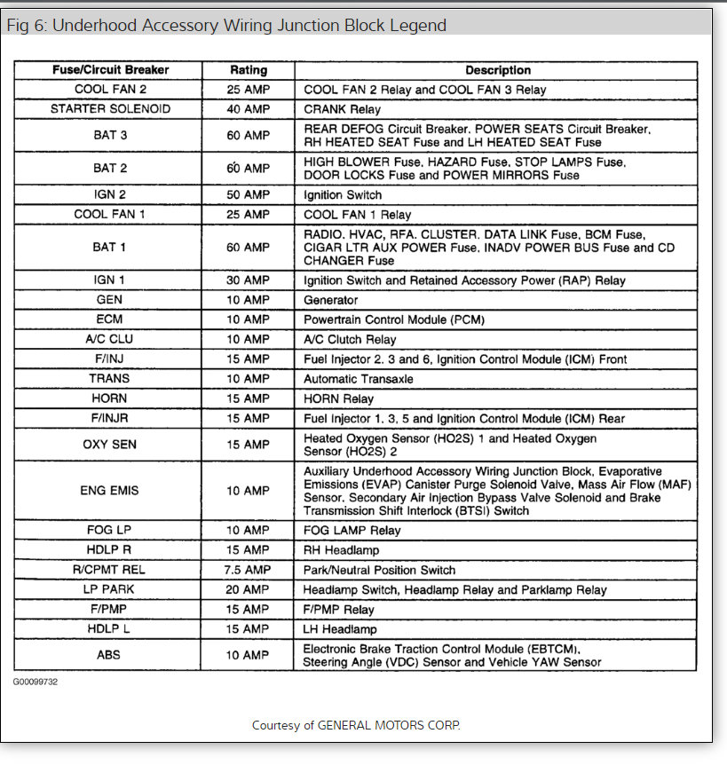

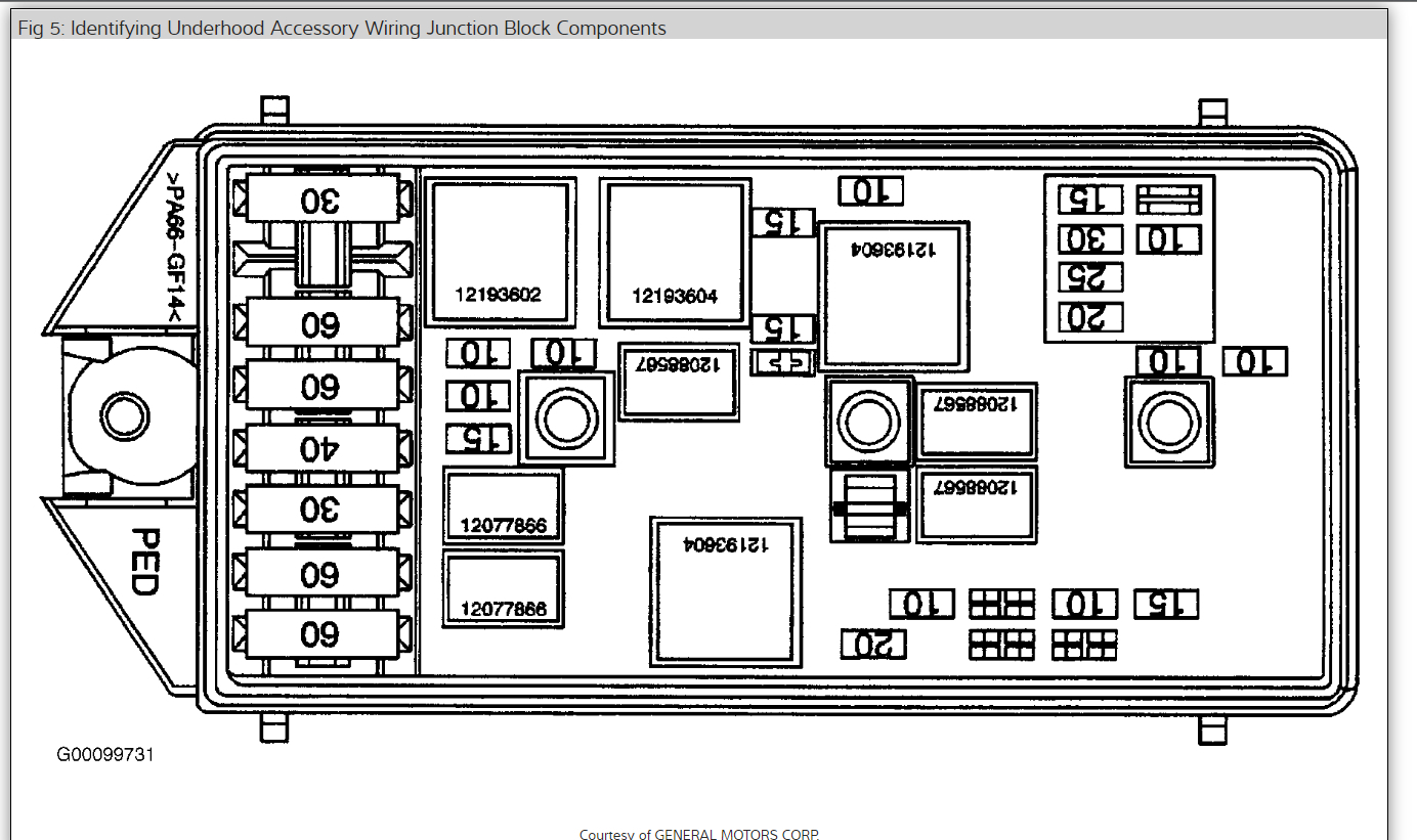

There is a starter relay that sounds like it is not working. Here is a guide and the starter wiring diagrams to help you test and see how the system works:
Check out the diagrams (below). Please run some tests and get back to us.
Cheers
Sep 8, 2010 at 11:27 AM
JBROWN3912
  • 11 POSTS
I wish I would have thought of that before the relay was melted. So I replaced it and the car is fixed! I love this site thanks again. :)

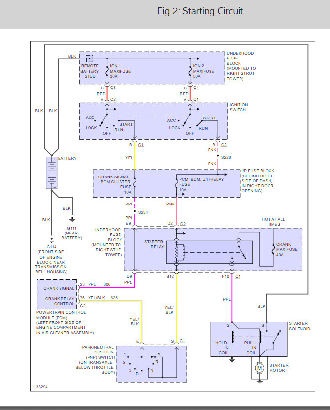

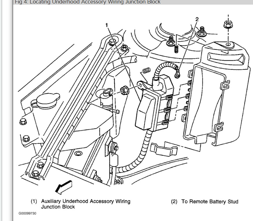

If you are saying the starter motor will not crank, I would have check voltage and ground for the starter motor.
Give me a second for posting starter wiring.

There is an early and late production starter circuit, I do not know which one you have? At the starter, black wire is battery voltage, hot all the time. The purple wire S terminal at the starter, goes hot with the key in the crank position, that circuit is wired through the starter relay. You may need to check voltage and ground for the control side of relay.
I would rather see you do some voltage and ground testing instead of trying different parts. There is also a neutral switch involved.

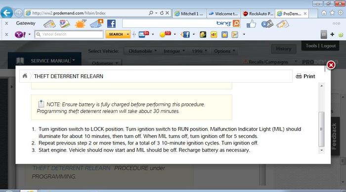

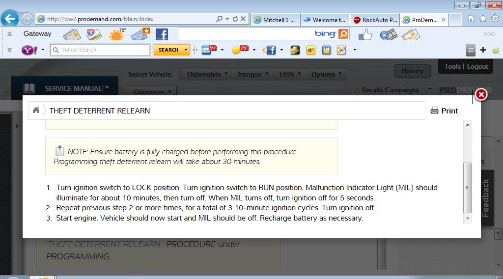

AUGUSTINA
I just replaced ignition because it locked up, lights are coming on but car will not crank or start.
Jul 21, 2018 at 8:41 AM (Merged)
SATURNTECH9
  • 30,869 POSTS
So the theft light is on?
AUGUSTINA
Yes, the security light is coming on blinking.
SATURNTECH9
  • 30,869 POSTS
Here is the pass lock relearn.

The only time power will go to the "S" terminal is when it starts and no other time. If it is not doing that then check the items in picture.
