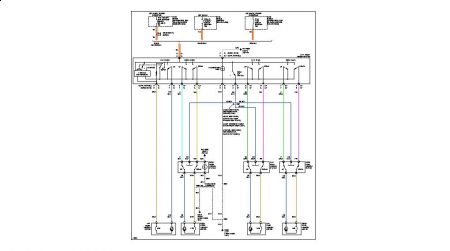

my car windows stop working, first it was the driver side then the other quickly followed. I have tried cleaning the wires of the master switch, but it is still getting no power. Can you tell me what is wrong whit it and how can I fix it?

Do you have a sunroof if so try opening it unable to check the power window circuit breaker behind right side of dash on right door opening
You should have power on the yellow wire on the master switch wiring harness, no power there were right back to the breaker. Power there master switch
https://www.2carpros.com/forum/automotive_pictures/12900_power_window_master_switch_EWD_1.jpg

I don't have a sunroof, but I did check the window fuse and it is good

Is this the 30amp fuse? Did you inspect it or test it for power?

I test it using a fuse tester
I don't know the amp of the fuse.
But as far as I know it was working with that one

How about the yellow wire on the wiring connector on the master switch does it have power?

No, neither do the other wires get power

If the master switch is properly grounded then you have an open circuit between the switch and the circuit breaker 30amp-use the diagram to trace it

How will I determine that?

The yellow wire is suppose to have power at all times at the master switch wiring connector. Earlier you stated that there's no power at the switch, get somebody that has an electrical experience to help you this can be a nightmare
