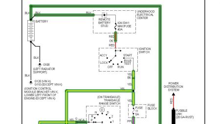

1996 Oldsmobile Cutlass No start problem
MHICKEY7
  • 1996 OLDSMOBILE CUTLASS
  • 6 CYL
  • FWD
  • 150,000 MILES

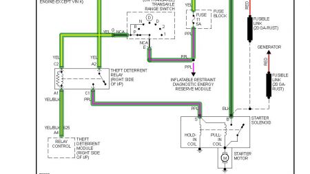

The engine suddenly stopped running while driving and would not restart. Inst. Lights are on. The only electrical items working are power windows and wipers. Nothing else will work. I can start the engine by crossing selenoid with screw driver with ignition on, but the car is otherwise electrically dead, ie: no turn signals, brake lights, etc. There is no power to "S" terminal at selenoid with ignition on. While checking ignition switch under dash I noticed that the switch actuating rod comming from the key does not move while turning the key. Would this keep the ignition switch from working? I suspect ignition swirch or nuetral safety switch.

Sir
I recommend you check fuse no.11 5amp in the fuse block. this fuse powers up the NSS/TRS and then the auto theft deterrent and to starter purple wire at starter solenoid. See below if further assistance is need all you got to do is ask and I shall return-Thank You for the donation.
https://www.2carpros.com/forum/automotive_pictures/12900_ss1_1.jpg
https://www.2carpros.com/forum/automotive_pictures/12900_ss2_1.jpg
