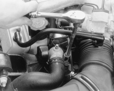

If replacing the water outlet, detach the radiator hose from the outlet.
Unfasten the water outlet attaching bolts and remove the water outlet.

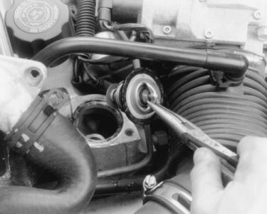

Remove the thermostat. Remove and discard the gasket.
Thoroughly clean the manifold water inlet and water outlet mating surfaces.
To install:
Position the thermostat into the inlet manifold.

Install the water outlet to the inlet manifold, then tighten the attaching bolts to 18 ft. lbs. (23 Nm).
Attach the radiator hose to the water outlet housing.
