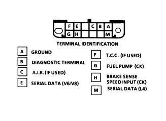

Hi, thanks for the donation. How long since a tune-up? Yes, you need to do testing when the problem occurs. Check trouble codes, you don't need any special tools. You can place jumper wire between A & B terminals at datalink connector, then, turn the key till the dash lites come on, no further. The mil starts flashing, you count the flashes to get the codes. Your looking for two digit codes. Below is GM generic aldl.
https://www.2carpros.com/forum/automotive_pictures/170934_obd_1_datalink_connector_6.jpg
