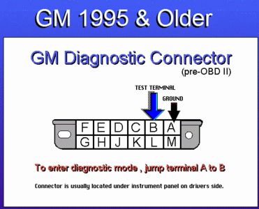

Here's how to check those codes...
https://www.2carpros.com/forum/automotive_pictures/62217_GM_DLC95_Older_2.jpg
Cross these two terminals as shown, then turn the key on. Count the flashes, a 22 will flash as 2 flashes then a short pause, then 2 flashes, if more than one code is stored, the pause will be longer. The codes will display three times and end with 12. Write them down and post here.
