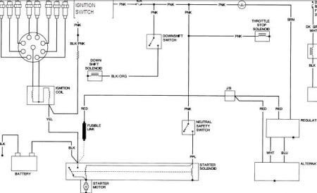

i have a electrical issue with my 69 olds, not sure where the wires go from the solenoid, on the solenoid there is a "R" and a "S" ....i think the S goes to the Starter Relay, and the R goes to the COIL????
which ever one goes to the coil...is it the POSITIVE side of the coil also??
i have a grouind wire from my batter to the frame and its MELTING????
i did replace the horn relay and i am waiting for the starter relay (behind the brake booster)....
i also replace the voltage regulater....(could this be damaged due to the problems i llisted also???

Welcome, the oldest I could find was 1970.
https://images.2carpros.com/forum/automotive_pictures/170934_69_olds_cutlass_1.jpg
S terminal should be the purple wire. I can't guarantee these old wiring diagrams? I found some old delco remy ignition wiring circuits, for two wire and three wire ignition switches, it shows different from the diagram?
