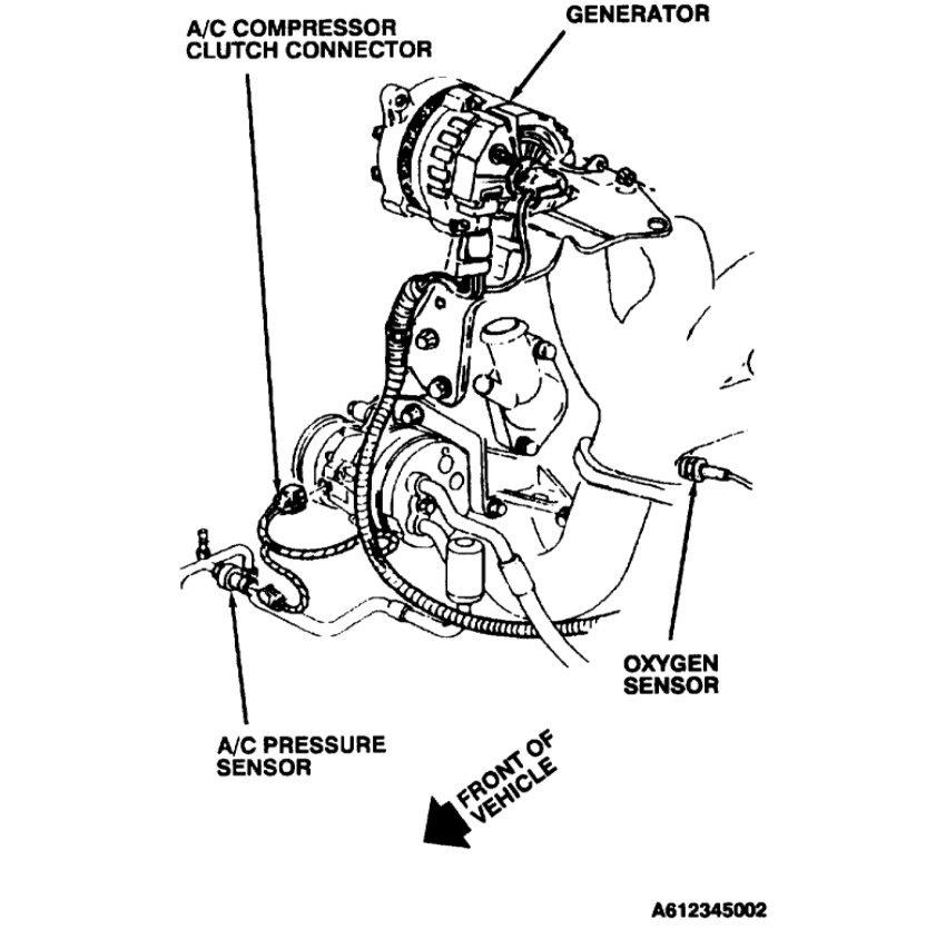

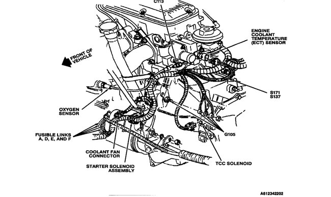

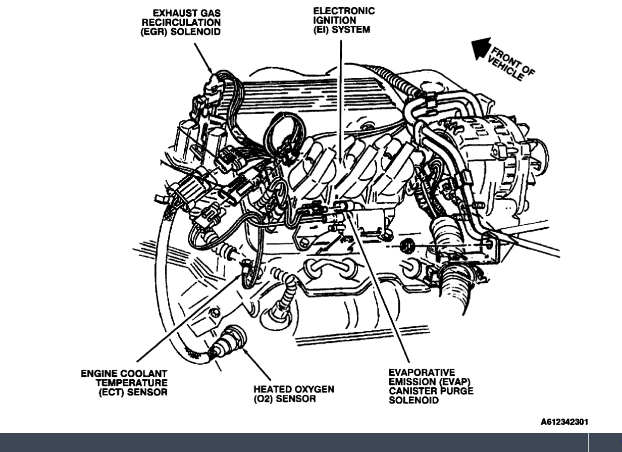

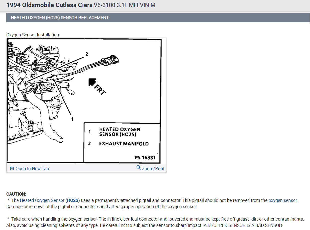

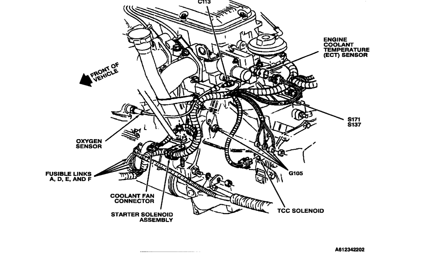

oxygen sensor location and replacement?
1994 OLDSMOBILE CIERA
105,743 MILES • 6 CYL • FWD • AUTOMATIC
SWEDE7703
Where is this located on engine and how do you replace it.
RMF
Aug 29, 2009 at 6:58 AM
  • 110,244 POSTS
It is on the exhaust system. Basically, you remove the wire to it and it screws out of the exhaust. Here is a guide that can help you change it out with diagrams below to show you how on your car.
https://www.2carpros.com/articles/how-to-replace-an-oxygen-sensor
