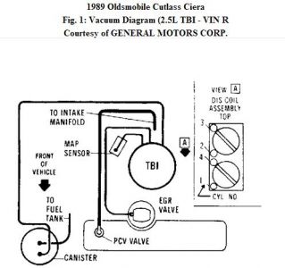

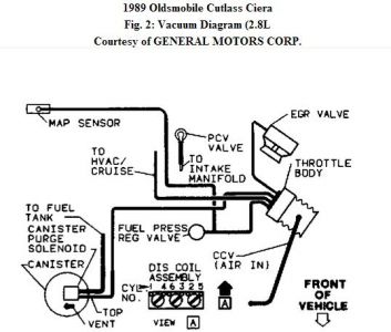

I recently replaced the head gasket on this car. I took the vacuum hoses off and can not find a site or someone that knows where they go. I was wondering if you knew where they went and could send a diagram or something for me. I sure would appreciate it.

https://images.2carpros.com/forum/automotive_pictures/261618_Noname_364.jpg
https://images.2carpros.com/forum/automotive_pictures/261618_Noname2_98.jpg
