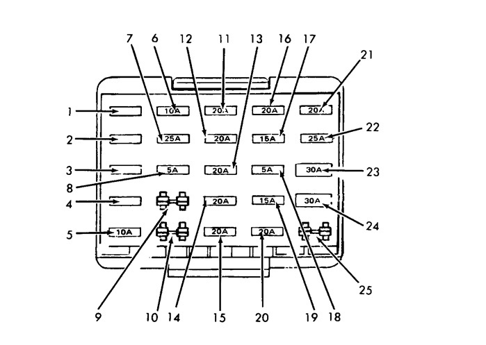

I have a 1985 oldsmobile 98 regency brougham and I took out the old non working radio and installed a new one, but i done all of this with the battery terminals left on, now the radio works fine but the car just turns over, like it's not getting any spark, it will not start, what could cause this

Check fuse 9--15amp in the fuse, is it blown, Use a voltage tester, any voltage there with the key on?

Sorry for my ignorance but will a multimeter do the same thing?and where might I find the ignition module? your probably bangin your head at these questions but i really appreciate your help!! Also my fuse box dosent exactly look like that I dont know if that makes a difference, the #5 10 amp is not mine, im also a little confused as to why the #9, 10, and 25 fuses look the way they do. Thanks again.

Ok so I have spark on the plugs, there is 12 volts on the ignition module wire, and there is gas getting to the injectors, I also have 12 volts on the wire connected to the injectors, but in my fuse box there are two fuses that have to current going to them, and they are not blown, it would be # 8 and 25 on your diagram, thanks again for the help I am stumped!!!

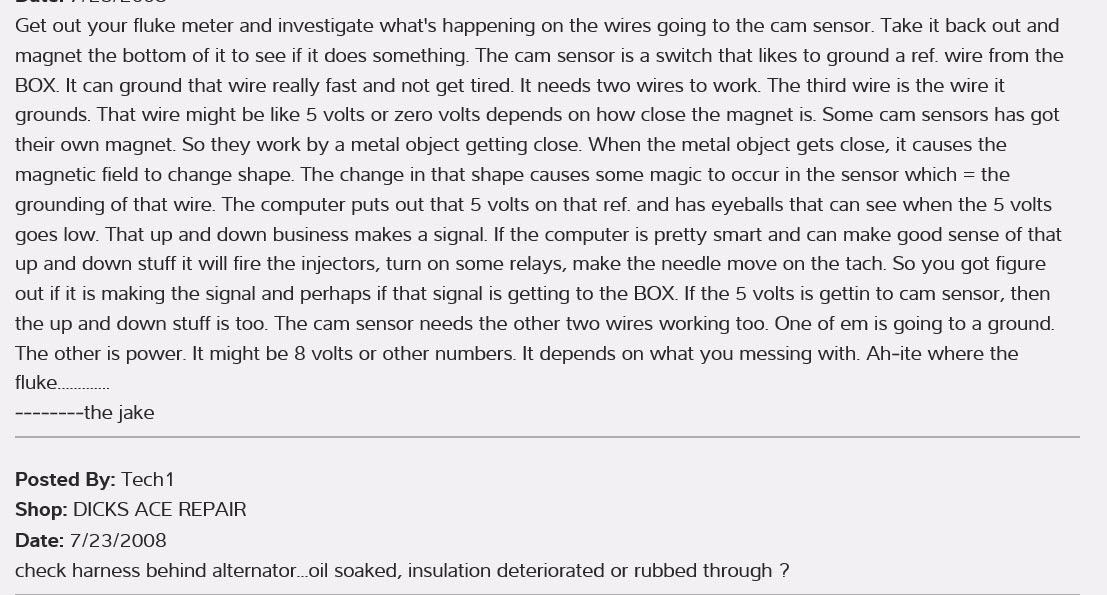

those older cars the temp sender had two wires yellow and black and they would go bad form several things, you have a problem with the prom unit or ecm as well as cam sensor from your posts of codes. you probably also have very low fuel pressure the code 31 and 66 don't effect the engine running it's either a short in the system or a bad switches. the knock sensor has only one wire see pic on how to diagnose cam problem which may be more your problem due to age.coolant temp is single arrow knock sensor double
