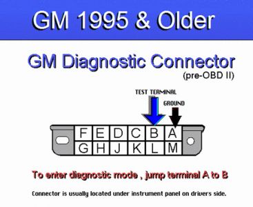

The "Service Engine Soon" light on the dash has been coming on and off at various times while driving fast or slow. The manual said that it means there's a problem with the emissions control system. I need to know what I can do to fix the problem before it gets worse. I can't afford to take it to a shop. Please help.
Aug 13, 2009 at 8:20 AM
  • 75,992 POSTS
Jumper B to A on the diagnostic link connector and read the flashes-see below
https://images.2carpros.com/forum/automotive_pictures/12900_GM_ALCL_39.jpg
