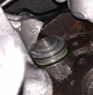

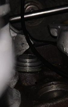

I don’t believe the shaft moved out of place, but I had to change the o ring on my oil pump drive (first picture) and I can’t get it to fall in all the way. Which direction does the flat side face because maybe i put it in wrong? It falls into place just not all the way. Is the part that holds it down (second picture) supposed to push it the rest of the way?
Feb 17, 2022 at 6:52 AM
  • 110,241 POSTS
Ariana,
Great to hear from you. LOL I can only imagine how frustrated you are. LOL

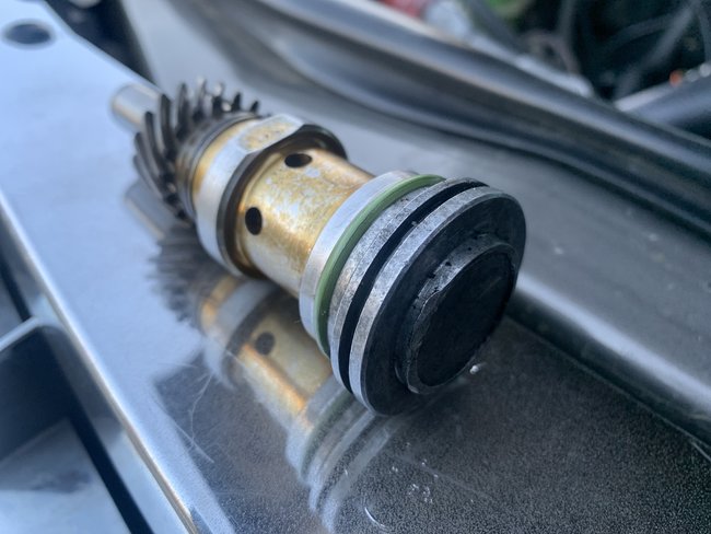

Okay, two things have to happen. There is an intermediate shaft that fits into the bottom of your first pic. See pics 1 and 2 below. If possible, with a mirror and light, look inside and determine if that is straight on to the drive you have. If it is, the next possibility is getting the teeth on pic 2 below to align (oil pump drive shaft).
Next, I doubt the intermediate shaft is the issue. Instead, I suspect the teeth are not aligning. Do this. Install the drive shaft as you have until it stops. If it doesn't seat fully, move the crankshaft slightly back and forth until it does.
Make sure to put engine oil on the new o-ring before you install it.
Pic 3 below shows how it works inside. The circled part is the intermediate shaft. The arrow is pointing to where the gear has to align.
Let me know if this helps.

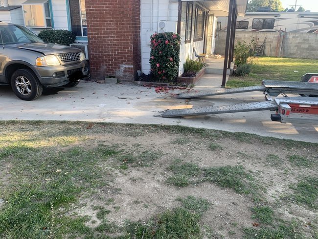

I can’t move my car and pushing isn’t working out. So, I just wasted money I didn’t have in the first place because I couldn’t get my car into the tow and the place, I was going to take it closes in an hour. Without a repair estimate from a mechanic shop AAA won’t further my claim. That guy ruined everything I worked so hard on and there’s nothing I can do about it. So, thanks for all your help. I really appreciate it. It’s been a really long process, but I think it’s over.

It's never over until you want it to be. What do you mean by not being able to get it into the tow? Can't someone help you push it?

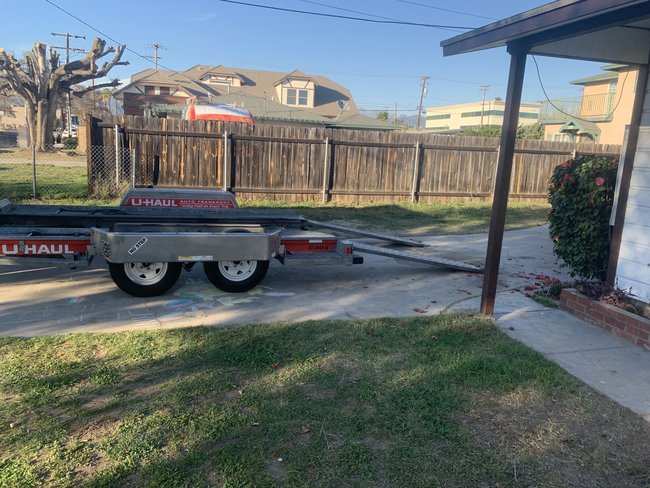

I’ll upload a picture of what I’m talking about. And no, I don’t have anyone to help me. That’s why I did the engine by myself too. I don’t know why I didn’t think about how i would get it onto the u-haul before I rented it.

If you have something to pull the trailer with, hook up the trailer. Next, if you have a come-along great; otherwise, see if you can get someone to lend one to you or find a really cheap one that is still good. LOL
Locate a support on the trailer that is very strong at the front and connect the come-along to it. On the opposite end attach it to a tow hook or the frame so you can pull it (slowly) onto the trailer.
On a flatbed tow truck, they use a winch that is much stronger and faster but does the same thing. I do, however, recommend having someone in the vehicle in the event of the tool breaking. You will need them to hit the brakes.
I attached a pic below of what I'm talking about. I feel really bad. I wish I had been there to help you. Please let me know if there is anything I can do to help or if you have any questions.
PS: You are human. That's why you didn't think before renting the U-Haul. We all do it.

Thank you for the kind words. I didn’t have anything to pull my car. No chain or anything. And I tried to have someone help me, but it resulted in my driver's door being dented and almost coming off the car. I only had a 3-hour window to get it to the shop. I already returned the U-Haul. Thank you though. Maybe I’ll save up for a mobile mechanic or something.

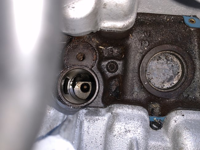

Are you able to get a short screwdriver in to turn the shaft?

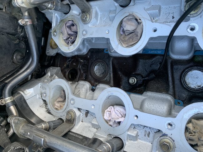

Screwdriver in from where? Here’s a pic of what I’m looking at. A lot of oil leaked from the pump drive. You can see it all over, lol.
Feb 23, 2022 at 6:51 AM

|f you look down where it mounts, it should look like the attached pic. Is that what you are seeing? If so. Try to get a small set of needle nose pliers on the shaft and see if they will gently move.
See pic below.
Feb 23, 2022 at 10:55 AM
ARIANADANIELLE5345
  • 402 POSTS
Yes I can move it.
Feb 23, 2022 at 11:28 PM
  • 110,241 POSTS
Try adjusting it in different positions to see if it allows things to seat fully.

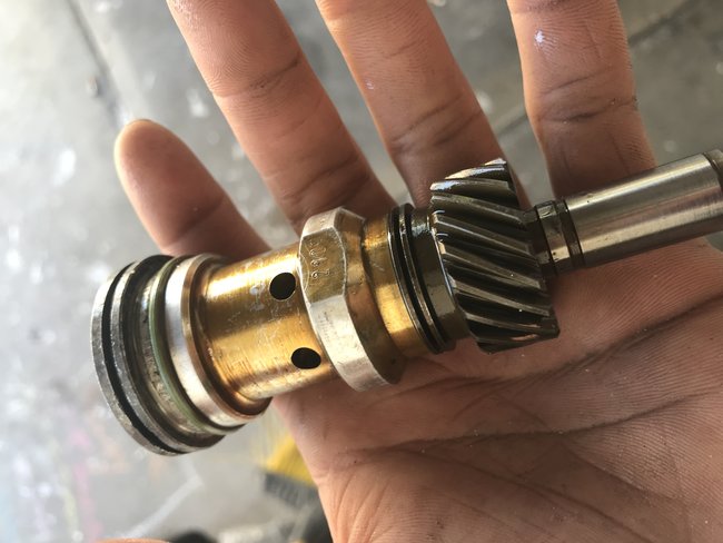

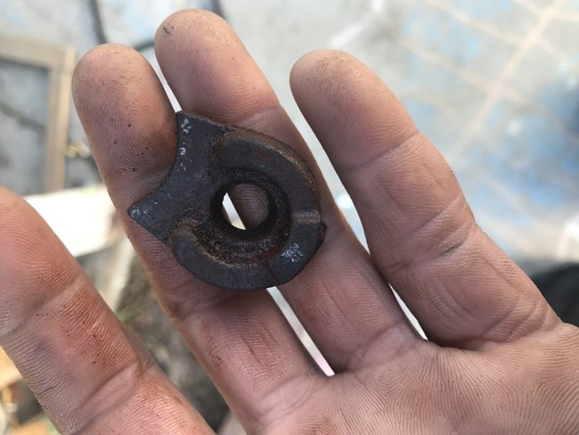

Maybe it’s the wrong o ring?
Mar 4, 2022 at 11:40 AM
  • 110,241 POSTS
Is this the same o-ring you removed with it, or have you installed a new one? Also, when you install it, are you lubricating the o-ring?
Mar 4, 2022 at 12:08 PM
ARIANADANIELLE5345
  • 402 POSTS
I thought it was the same one because it seems like it fits but maybe not. It’s green and pretty thick and yeah, I put clean oil on it.
Mar 5, 2022 at 2:57 AM
  • 110,241 POSTS
If it's the same one, it should be fine. However, if it isn't the original, it can be causing a problem for you.
If possible, send me a pic of the o-ring. Also, do you have any laying around that may have been mixed up with the one you are using?

By the way, here is the o ring:
Mar 6, 2022 at 10:48 PM
  • 110,241 POSTS
That doesn't look too far off. Were you able to compare it to a new unit to confirm if it is correct?
