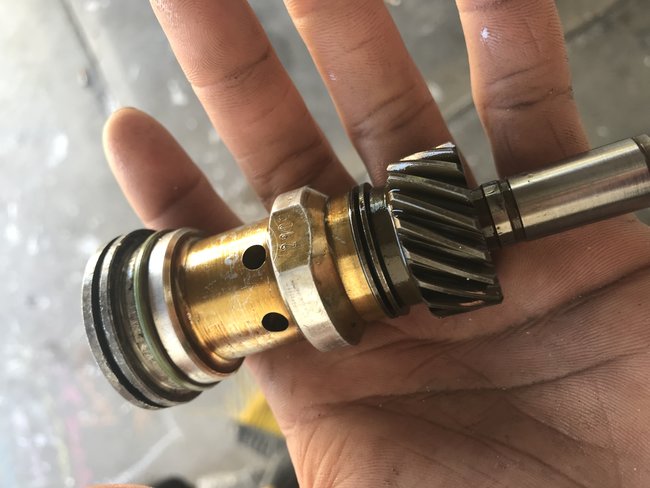

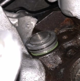

I don’t believe the shaft moved out of place, but I had to change the o ring on my oil pump drive (first picture) and I can’t get it to fall in all the way. Which direction does the flat side face because maybe i put it in wrong? It falls into place just not all the way. Is the part that holds it down (second picture) supposed to push it the rest of the way?

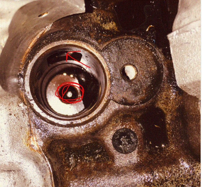

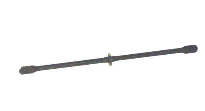

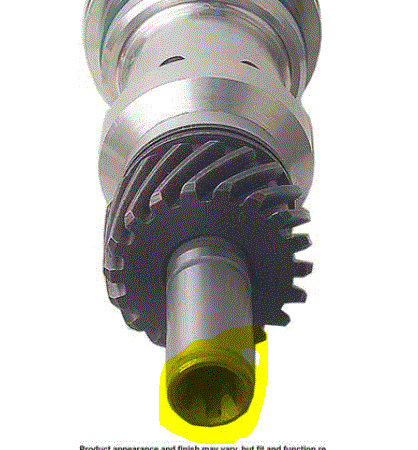

Okay, two things have to happen. There is an intermediate shaft that fits into the bottom of your first pic. See pics 1 and 2 below. If possible, with a mirror and light, look inside and determine if that is straight on to the drive you have. If it is, the next possibility is getting the teeth on pic 2 below to align (oil pump drive shaft).
Next, I doubt the intermediate shaft is the issue. Instead, I suspect the teeth are not aligning. Do this. Install the drive shaft as you have until it stops. If it doesn't seat fully, move the crankshaft slightly back and forth until it does.
Make sure to put engine oil on the new o-ring before you install it.

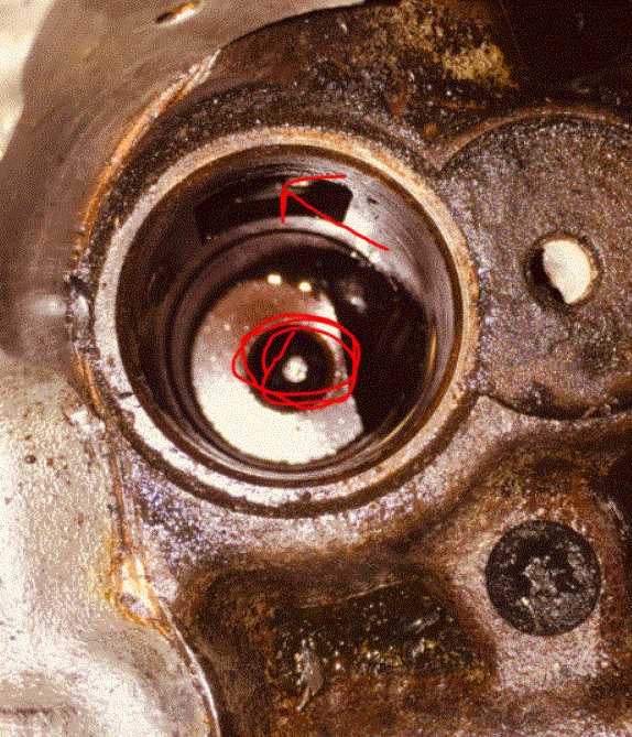

Pic 3 below shows how it works inside. The circled part is the intermediate shaft. The arrow is pointing to where the gear has to align.

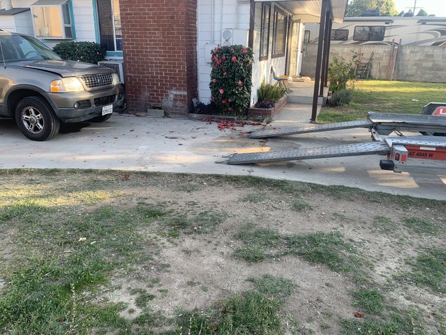

I can’t move my car and pushing isn’t working out. So, I just wasted money I didn’t have in the first place because I couldn’t get my car into the tow and the place, I was going to take it closes in an hour. Without a repair estimate from a mechanic shop AAA won’t further my claim. That guy ruined everything I worked so hard on and there’s nothing I can do about it. So, thanks for all your help. I really appreciate it. It’s been a really long process, but I think it’s over.

It's never over until you want it to be. What do you mean by not being able to get it into the tow? Can't someone help you push it?

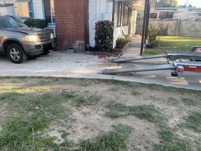

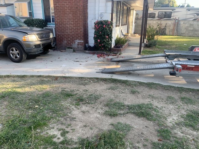

ARIANADANIELLE5345
  • 402 POSTS

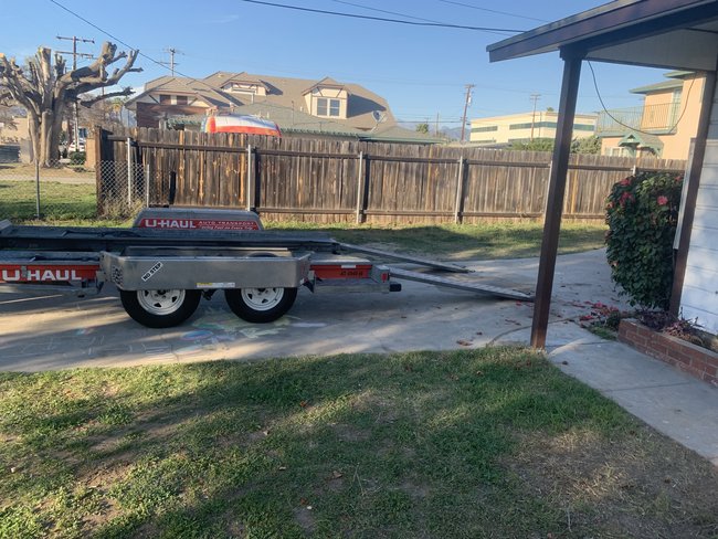

I’ll upload a picture of what I’m talking about. And no, I don’t have anyone to help me. That’s why I did the engine by myself too. I don’t know why I didn’t think about how i would get it onto the u-haul before I rented it.

  • 110,194 POSTS

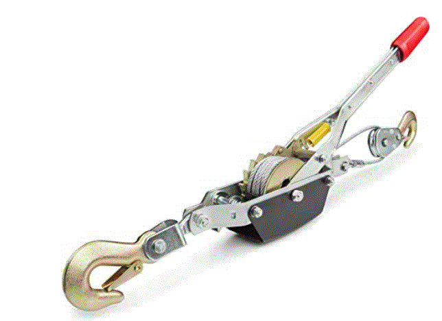

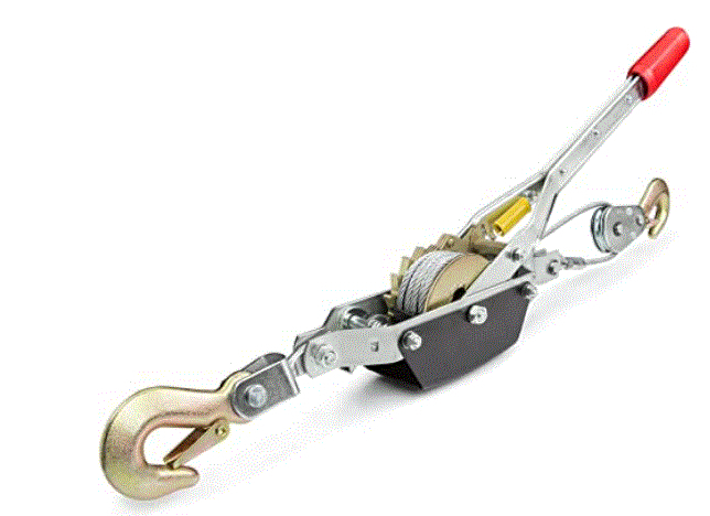

If you have something to pull the trailer with, hook up the trailer. Next, if you have a come-along great; otherwise, see if you can get someone to lend one to you or find a really cheap one that is still good. LOL
Locate a support on the trailer that is very strong at the front and connect the come-along to it. On the opposite end attach it to a tow hook or the frame so you can pull it (slowly) onto the trailer.
On a flatbed tow truck, they use a winch that is much stronger and faster but does the same thing. I do, however, recommend having someone in the vehicle in the event of the tool breaking. You will need them to hit the brakes.
I attached a pic below of what I'm talking about. I feel really bad. I wish I had been there to help you. Please let me know if there is anything I can do to help or if you have any questions.

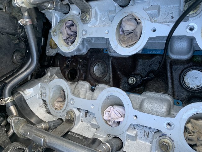

I still can’t get the oil pump drive in. I even took my intake manifold off and still can’t get it to go in all the way. I think I'm going to have to take the upper oil pan off and take the oil pump and shaft out. That way I can put the drive in first and then install the pump and shaft back in.

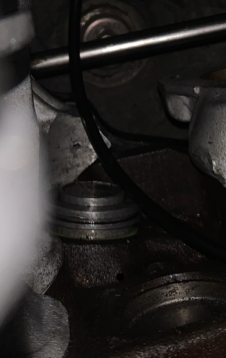

Yes. I don’t know what else to do but I really don’t want to take the cradle off again. That means a whole lot of work. I just can’t get it in. It is almost in but not all the way. It’s lining up with the gears and everything it just won’t go all the way in.
Feb 22, 2022 at 8:00 PM
  • 110,194 POSTS
Are you able to get a short screwdriver in to turn the shaft?
Feb 23, 2022 at 2:02 PM
ARIANADANIELLE5345
  • 402 POSTS

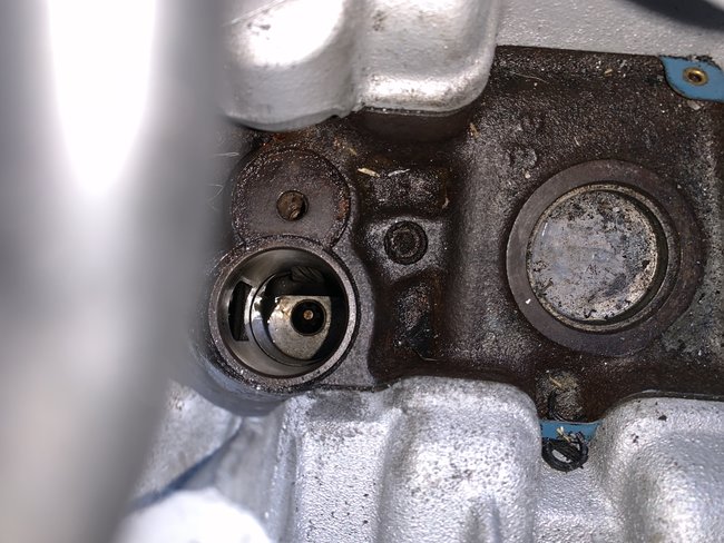

Screwdriver in from where? Here’s a pic of what I’m looking at. A lot of oil leaked from the pump drive. You can see it all over, lol.
Feb 23, 2022 at 2:51 PM

  • 110,194 POSTS
|f you look down where it mounts, it should look like the attached pic. Is that what you are seeing? If so. Try to get a small set of needle nose pliers on the shaft and see if they will gently move.
See pic below.
Feb 23, 2022 at 6:55 PM

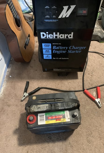

Thank you but I’m for sure running out, lol. I tried adjusting it but still can’t get it. I’m just going to bump the starter. The only problem now is that when I went to charge my battery, the cables got warm, so I took them off. My multimeter reads 11.63. Is that enough to bump the starter?

Which cables got hot? Was it the ones on the charger or the vehicle? And yes, that voltage should allow you to bump it. However, moving the crankshaft pulley should do the same thing.

The battery wasn’t in my car when i was charging it. It was the cables on the charger.

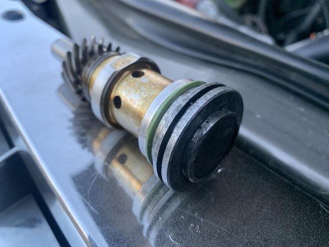

I have a lot lol. I ordered individual parts before I realized I needed to rebuild the engine, so I bought an entire engine gasket set so now I have backups for pretty much every gasket. Maybe I’ll go into the local auto parts store and ask to see an oil pump drive for my car and make sure it looks the same. If it does, then I’ll just take the upper oil pan off and do it from underneath.

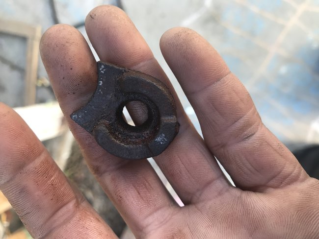

By the way, here is the o ring:
Mar 7, 2022 at 6:48 AM
  • 110,194 POSTS
That doesn't look too far off. Were you able to compare it to a new unit to confirm if it is correct?
