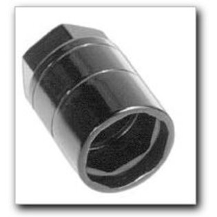

Some people pull them out with channel-lock pliers, you risk "egging" it and messing up its operation.
A regular socket will not fit it.
This is what you should use, it fits perfectly. Some of these are "stepped", the step will fit other sensors with the same design but have a different diameter. (useful on other repairs)
http://shop.advanceautoparts.com/p/autocraft-1-1-1-16-oil-sender-unit-socket-ac653/10051056-P?searchTerm=oil+pressure+switch+socket

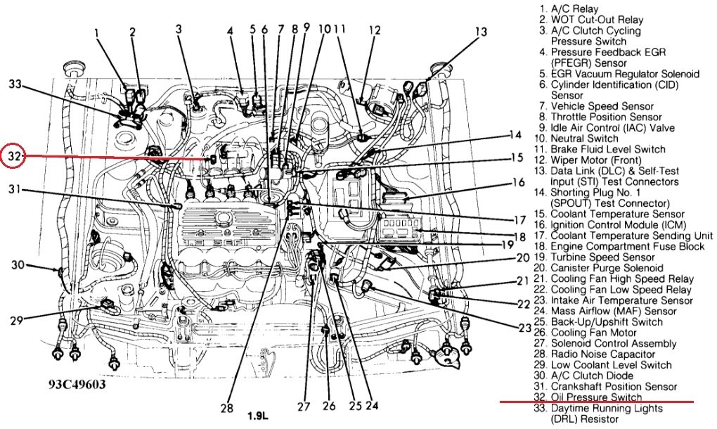

Right side of the block, near the oil filter.
I was able to obtain you a component location diagram from "Prodemand".
This should be a really easy repair.
Post us as to your progress,

I tried getting the old one out today went to advanced and bought the socket but the socket doesn't seem to fit snug I've read online that some claim the starter is in the way but that doesn't seem to be it just the fact that the socket is not tight on sensor let me know wat you think thanks
Sep 14, 2016 at 6:06 PM
CJ MEDEVAC
  • 11,004 POSTS
Does it fit the new one snugly?
You do have an oil light not an oil gauge?
The tool is stepped for 2 different sizes, could it be you are on the bigger step and need to be on the smaller?
Reckon the old one was installed with pliers and they "egged" it? Now it won't slide into the socket?

The new one that I bought fits in there but it seems to have to go deep in there to fit it I bought the exact one you showed me at advanced I didn't know how it could be two sizes considering the ratchet end only fits in one side the of the pressure socket?

I feel like it has to go over the sensor more to snug but it can't cause the blocks there so idk can I jus turn the socket around?
Sep 14, 2016 at 6:55 PM
MATTTYW20
  • 113 POSTS
I think I'm gonna get an 11/16 socket tomorrow and see if that fits better

This ain't your particular socket but similar
Got pic below off of the net, it was clear to see
Notice the 2 sizes at the open end of the socket (like a step), the socket will fit 2 different sensors.
I thought the one I suggested (I looked it up on their site) was the same as it said it would fit 1" and 1-1/16 (if either is the size of your sender)
