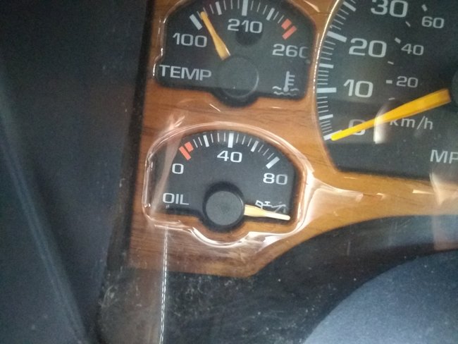

Oil gauge it at 40 except when I accelerate it maxes out.
Sep 24, 2019 at 4:46 PM
TJBORRMAN
In park at idle.
Sep 25, 2019 at 3:20 AM

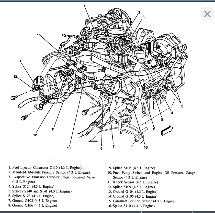

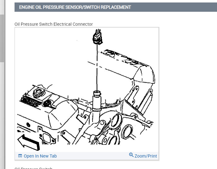

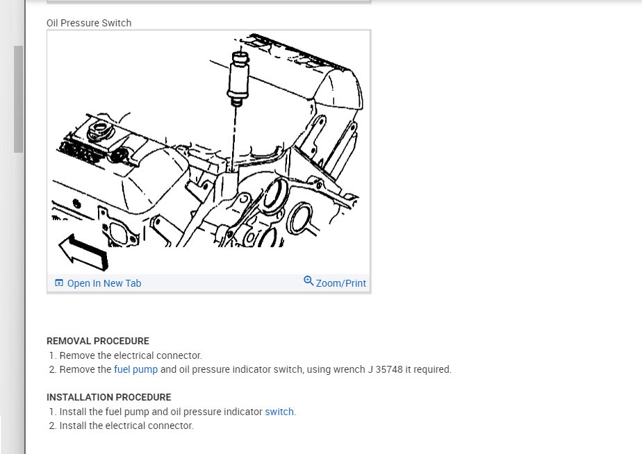

Oil pressure gauge being maxed out directly after an oil change points to a possible oil issue in the oil change. However, the fact that this is not just maxed out, but the gauge is fully in the pegged state points to a sensor issue.
However, if you need to change the oil again just to be sure then here is a guide that will help just in case you need it:
https://www.2carpros.com/articles/how-to-change-engine-oil-and-filter
If this all checks out, then I would suggest changing the sensor because this is a common issue.
