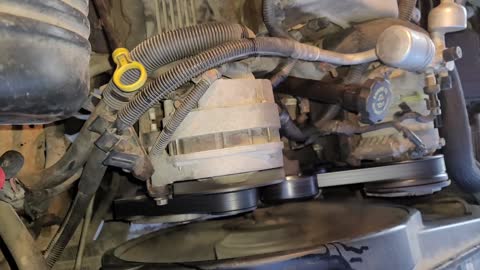

Was driving the truck hard and when I parked to turn off the engine shut off by itself. engine does not sound right and oil pressure goes to zero at an idle.

If the pressure is showing low, do you hear any knocking or ticking from the engine when running? This guide can help us fix it
https://www.2carpros.com/articles/engine-has-low-power-output
Take a look through this link and let me know if anything mirrors what you are experiencing.
https://www.2carpros.com/articles/engine-noises
I'm not sure how hard you were running it, but there is a chance you could have spun a rod or main bearing.

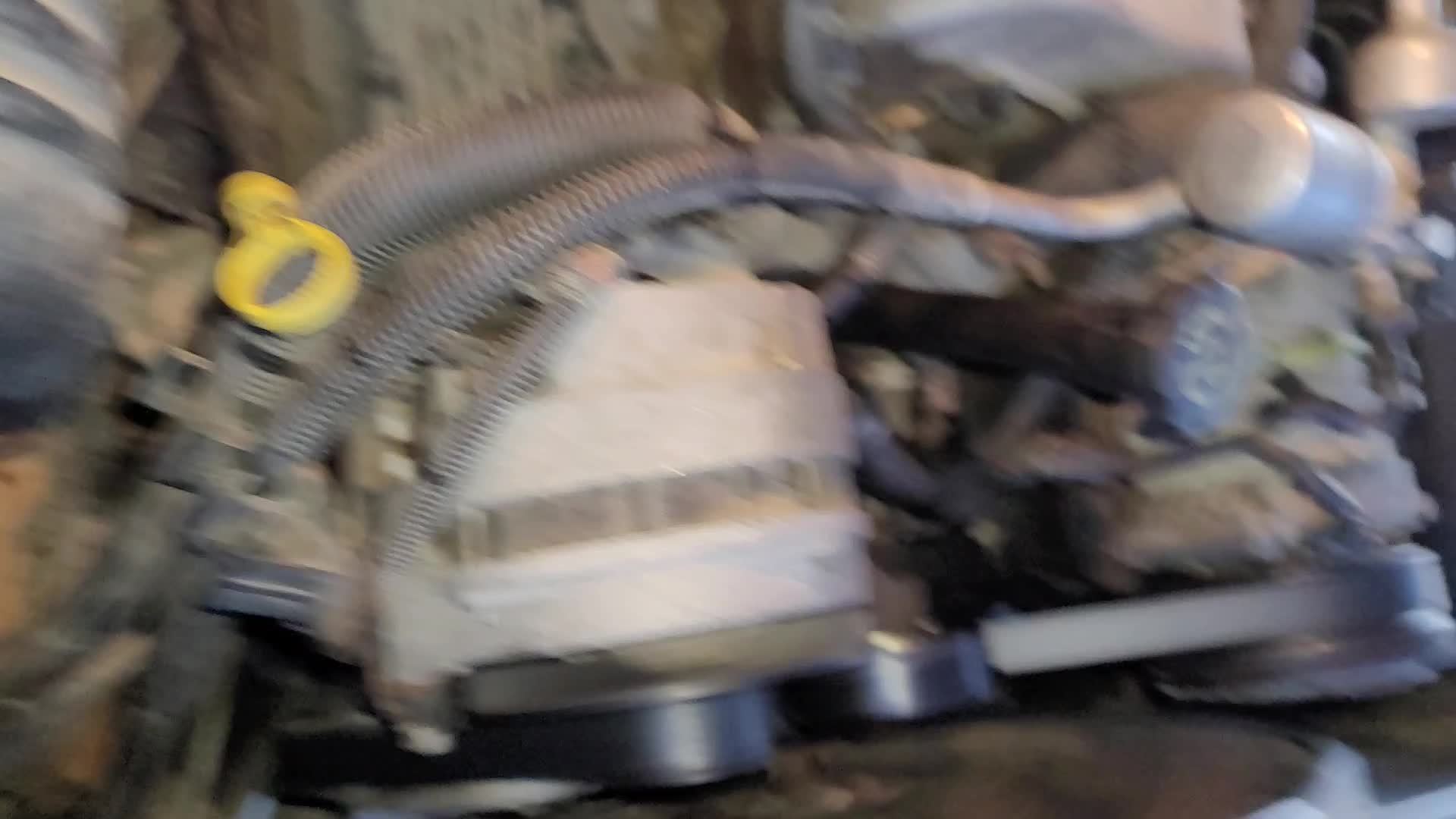

This is about halfway to normal operating temperature it gets worse and worse as temperature climbs.
Dec 19, 2020 at 7:19 AM
  • 110,240 POSTS
That sounds like one of the main bearings which would explain the lower oil pressure. We have two choices at this point. Remove the engine and inspect clearances on the main journals and rods which will likely lead to rebuilding the engine or finding a good used engine.

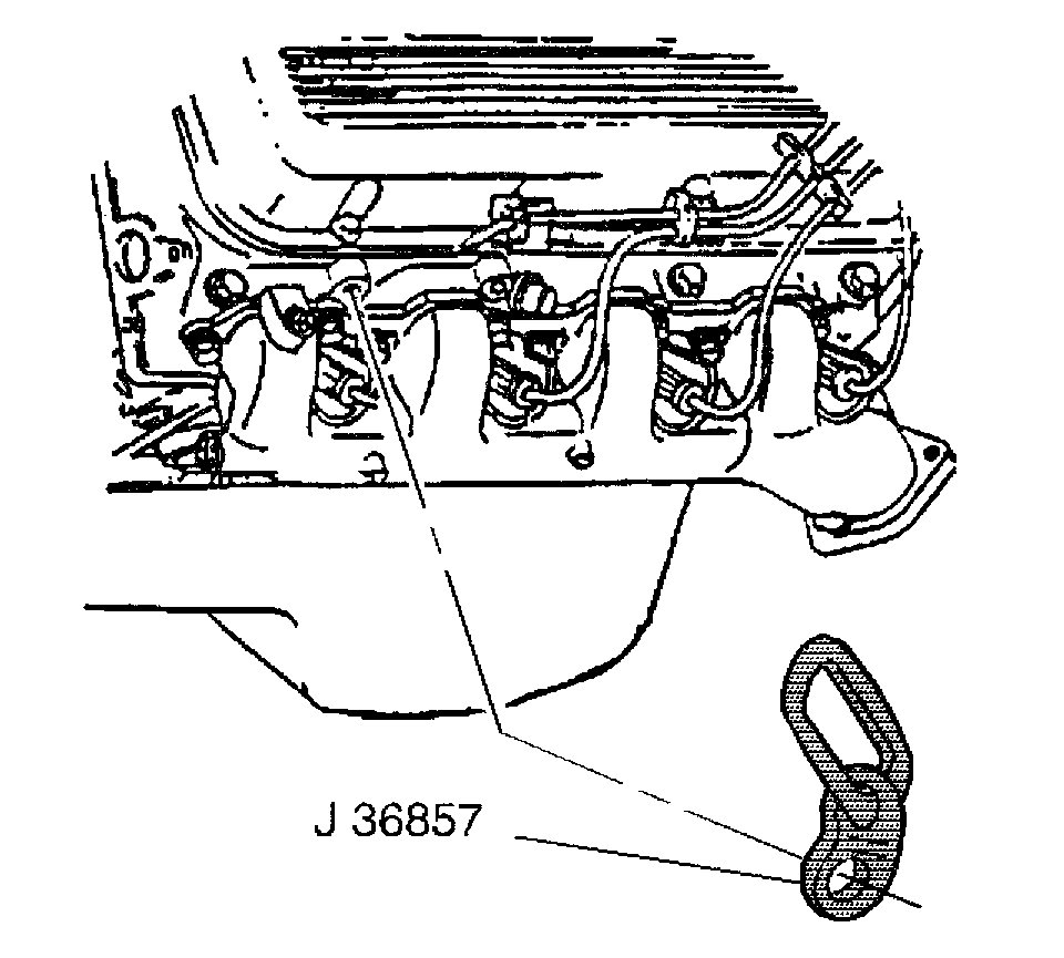

As far as the engine, here are the directions for removal and replacement. The attached pics correlate with the directions.
_________________________________
1998 Chevy Truck K 2500 Truck 4WD V8-454 7.4L VIN J SFI
Engine Removal and Installation
Vehicle Engine, Cooling and Exhaust Engine Service and Repair Procedures Engine Removal and Installation
ENGINE REMOVAL AND INSTALLATION
See pic 1

31. Attach J 36857 to the rear of the right cylinder head.
Install the attaching bolt and washer. Use GM P/N 9428217 with GM P/N 15650963.
Tighten the lift bracket bolts to 40 Nm (30 ft. lbs.).
NOTICE: Refer to Fastener Notice in Service Precautions.
32. Remove the front engine mount through bolts.
33. Remove the engine with a suitable lifting devise.
34. Remove the generator mounting bracket from the engine block.
35. Remove the air conditioning compressor/power steering mounting bracket from the cylinder head.
36. Remove the lift brackets from the cylinder head.

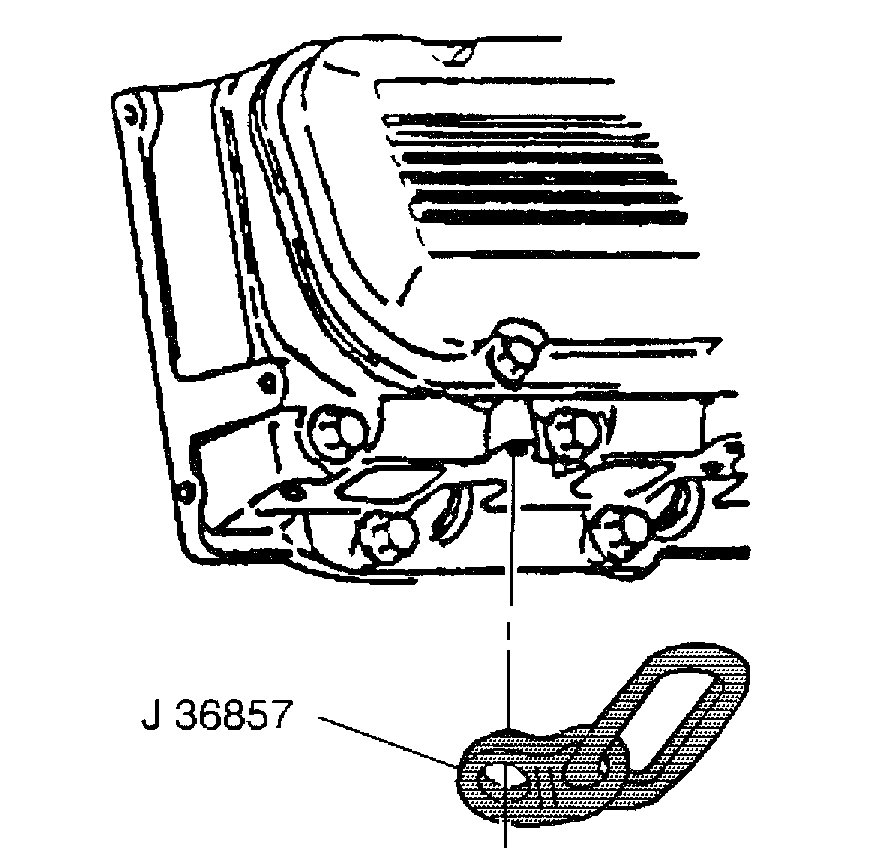

see pic 2

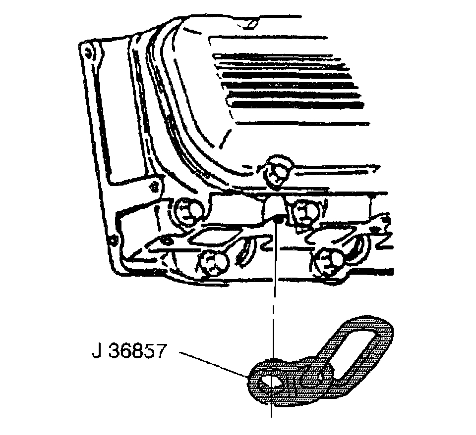

see pic 3
2. Attach J 36857 to the left front cylinder head.
