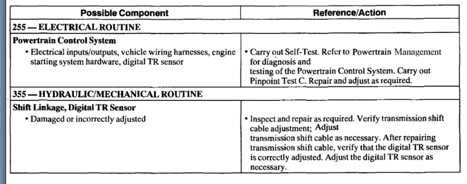

my car also has a self diagnostic test. i did the test and on the oil test it read 255 engine off and 000 engine on and also i took the hose and the PCV valve off to clean it it was full of oil.

I think you are talking about the key on engine off test. This code points to an issue as talked about below but it does not account for an oil pressure issue. It could be a sensor issue as this is an input to the PCM but again, this is why we need to confirm the oil pressure is okay with a mechanical gauge when this happens.
