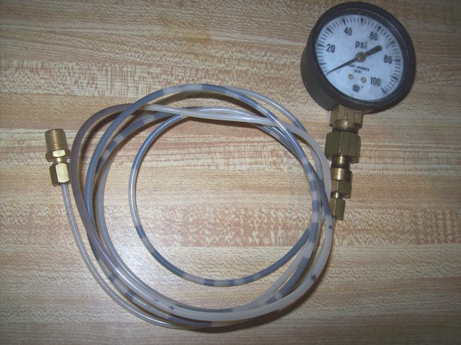

You can remove the oil pressure sender and install a mechanical pressure gauge to see exactly what the pressure is. My gauge has a long tube and I am able to run it out from under the hood and in the seat beside me.
From your description, it just sounds like normal/prolonged wear, the mechanical gauge will most likely tell the same story.
Last picture is of my gauge.

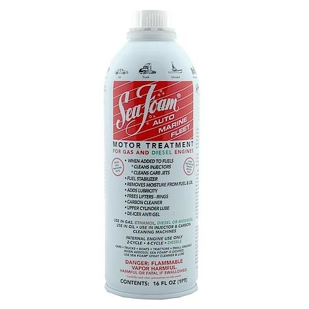

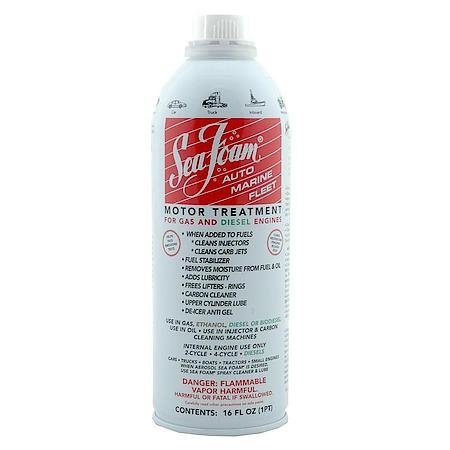

About three hundred miles before your next oil change, pour 5oz. of "Seafoam" into your oil fill hole (into the oil). This may get rid of some of those noises you are hearing such as lifter/rocker arm rattle during that three hundred mile cleaning.
Picture one below.
Pour the remainder of the Seafoam bottle into your gas tank.
Here is a link from their site:
https://seafoamsales.com/wp-content/uploads/2017/04/HOW2_Adding-Sea-Foam-to-Crankcase-Oil.pdf

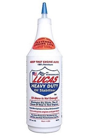

Let's substitute that last one for a quart of "Lucas Oil Stabilizer"
Picture two below.
I run a bottle every time I change oil, my Jeep sounds great!
You can leave this in until your next oil change, use it each and every change from now on.
This should improve oil pressure and maybe lessen oil consumption.
