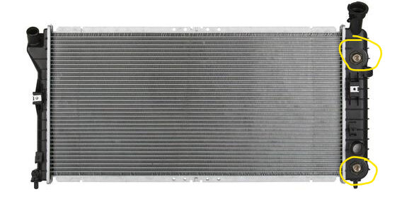

My car recently started making a bit of a whirring noise when accelerating at low speeds/first gear. No noise at higher gears or acceleration after that. No noise when revving in neutral. Mechanic originally said the noise is probably a tin shroud vibrating against something when i took it on Monday dropping off our family vehicle for a different issue.
Decided to check fluid levels, and it appears to have something mixing in the coolant. I have no idea how long it has been doing that, no one ever noticed before on oil changes or checks. I took the car back on Tuesday while picking up our family vehicle.
Does not appear to have coolant mixing in oil at all. I do not believe this model has a transmission coolant heat exchanger but i don't think that transmission would look brownish in the coolant anyhow, would it?
The mechanic said it would cost 7 to 8 thousand to replace the engine and is probably not worth it...
I'd like a second opinion, since they didn't really take much apart or do much more than research on some analytics resource is what they told me. Are they probably right?
I know a cracked block could be a cause, they said head gasket is unlikely issue since its only oil in coolant and not the reverse. Other than that, I am no mechanic...

Some came with the trans cooler, others did not. I am going to send over a picture. See if there are 2 lines on the passenger side of the radiator.
If there is, then the fluid could be transmission fluid mixing with the coolant and the whine you are hearing under acceleration could be the transmission.
Let me know what you find on the radiator.

I will look when i pick it back up from the mechanic here in a bit. Would the coolant look like brown/beige if it were transmission fluid though? I will add pictures when I pick it up.

Usually, you will see it floating on top of the coolant and it would be red, sometimes reddish brown. But I would say it would depend on how bad it is and how long it has been driven like that.
But when you get back send me a couple of photos if you could and let's see what we can find out.
