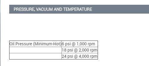

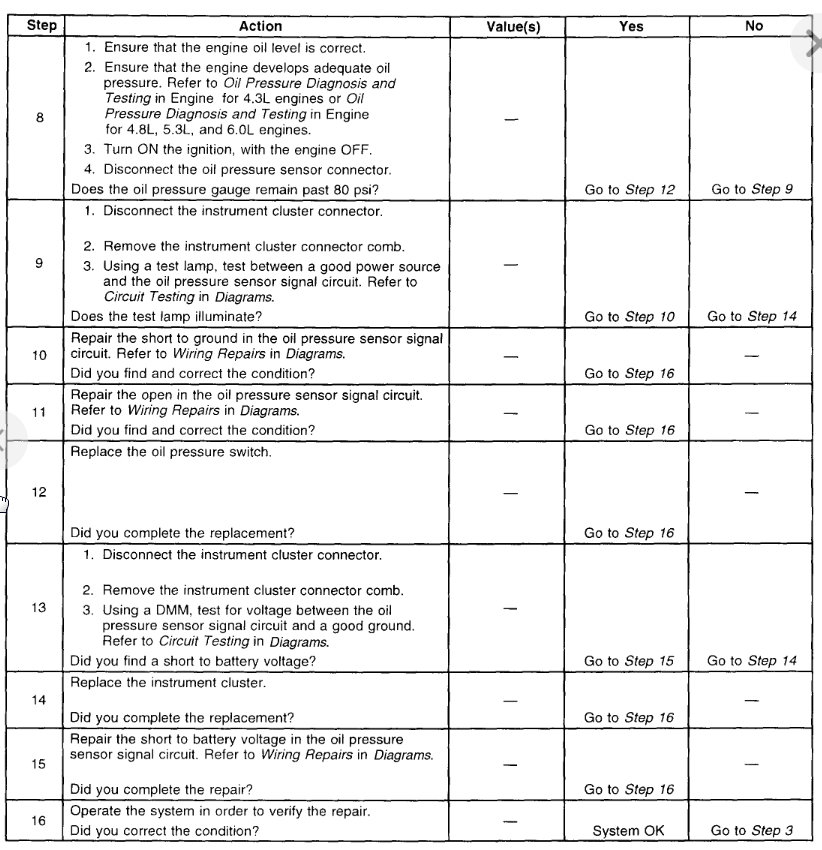

No water mixed with oil though. No milky oil caps or dipstick. No drivability issues whatsoever. The truck runs like a top. I do have low oil pressure. I crank the truck up and the pressure sits at 8. It doesn't drop or rise. I'd like to know why oil is in my coolant? I seen a video of someone replacing the oil cooler? What would that have to do with it? Thank y'all.
Feb 5, 2020 at 2:19 AM
Just so I am clear, you only have oil in the coolant and no coolant in the oil?

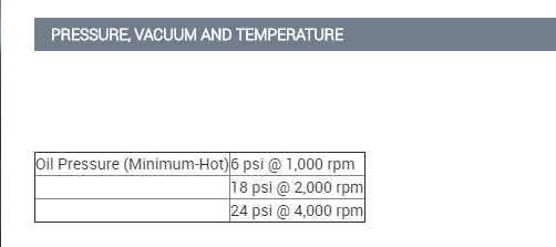

As for the pressure, your spec is attached but if you have 8 PSI at idle then that is actually oayk. I am a little surprised as it does seem low but according to the spec it is okay.

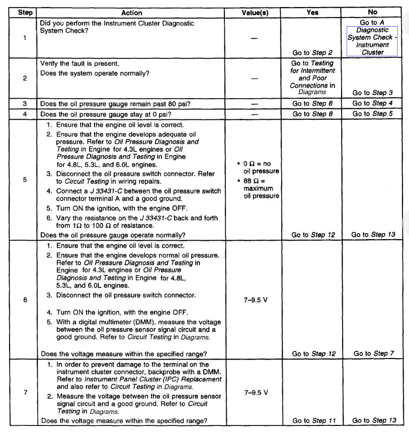

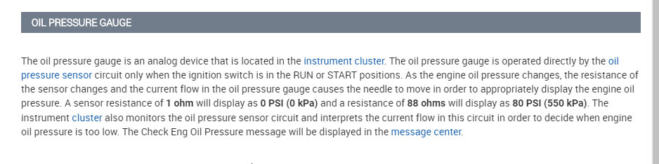

You are correct. There is no coolant inside the oil cap or on the stick. When I changed the oil, there was none in there either. 6 psi may be normal at idle but like I said, the reading does not change, no matter what the rpm's are. It's fixed on 8. I highly doubt it's normal.
Feb 5, 2020 at 9:05 AM

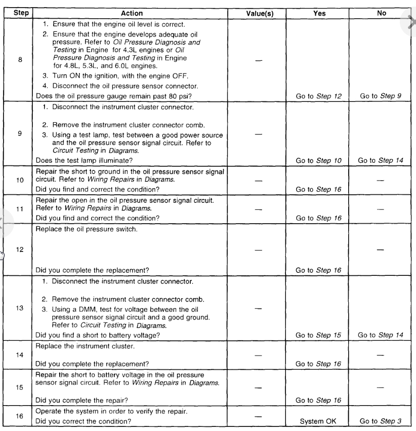

Sorry I missed that. I thought it was just at idle. If you have low oil pressure, it is one of three things. First, faulty sensor, wiring or gauge. We need to hook a mechanical gauge to the engine and confirm the reading is correct.
If it is then it is either a faulty pump or excessive clearance in the bearings. The pump creates pressure by the resistance it has to overcome when forcing the oil in the oil galleys and between the bearings.

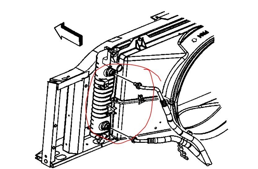

There's a lot of oil in the coolant. You also smell it every time you get out of the truck. It smells burnt. You don't see any possibility of a leaking oil cooler in the radiator?

I just saw that this engine has an oil cooler.
The engine oil cooler is located in the left side of the radiator. Engine oil flows through the cooler and reduces the temperature of the engine oil. The cooled engine oil then returns to the engine.
Good chance you need a radiator.
