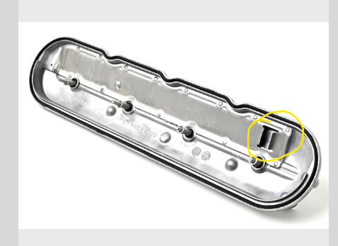

Also, on the valve cover there is a baffle. It's possible it got clogged behind it or the weep hole on it is clogged and the oil can't leave fast enough.

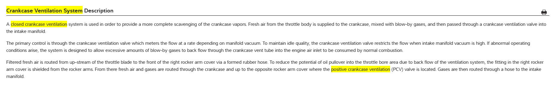

I did find something interesting though. According to my information, air is sucked through that hose into the right rocker cover via that formed hose. To reduce potential oil pullover into the throttle bore due to backflow of the ventilation system, the right rocker arm cover is shielded, that baffle, from the rocker arms. From there fresh air and gases are routed through the crankcase and up the opposite rocker arm cover where the PCV is located. Gases are then routed through a hose to the intake manifold.
So, there might be something affecting that process. Maybe vacuum. Vacuum does get lower as engine speed increases so that would make sense that it would happen more when under load like towing or WOT. I would measure vacuum using that hose coming out of the driver's side rocker cover to the intake and see what you get for a reading. If there isn't enough vacuum or it isn't pulling it around the engine for some reason the intake would end up sucking air from the hose instead of providing it and the oil along with it.
Maybe it wasn't doing it before because the parts were old, so oil was restricted.

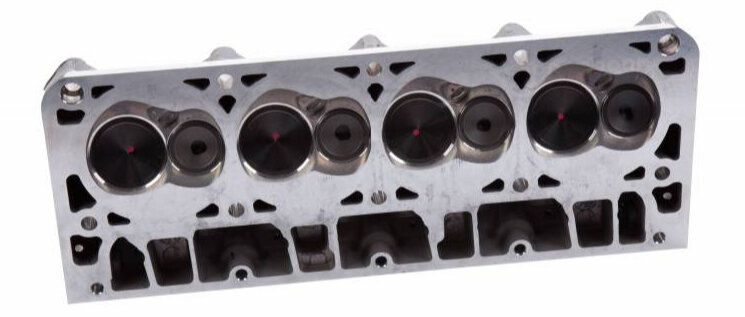

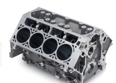

Hello BBOYLILROB,

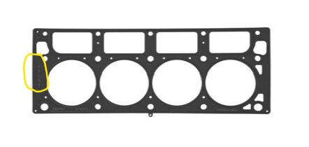

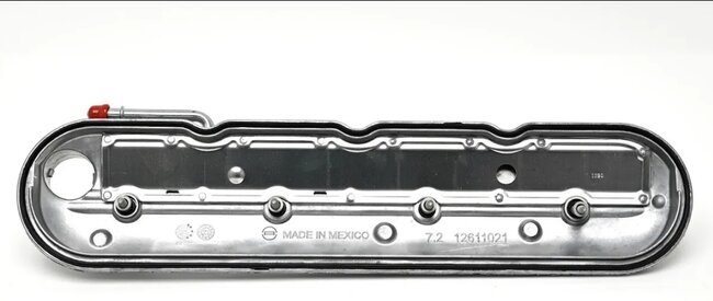

So, the head is symmetrical, but the gasket can only go on one way. I added a picture of the head gasket from Fel-Pro. I don't know if you can see it on the gasket, but it says "front", but it looks like it would block off coolant passages. So thankfully I don't think that's the issue otherwise it would be overheating.

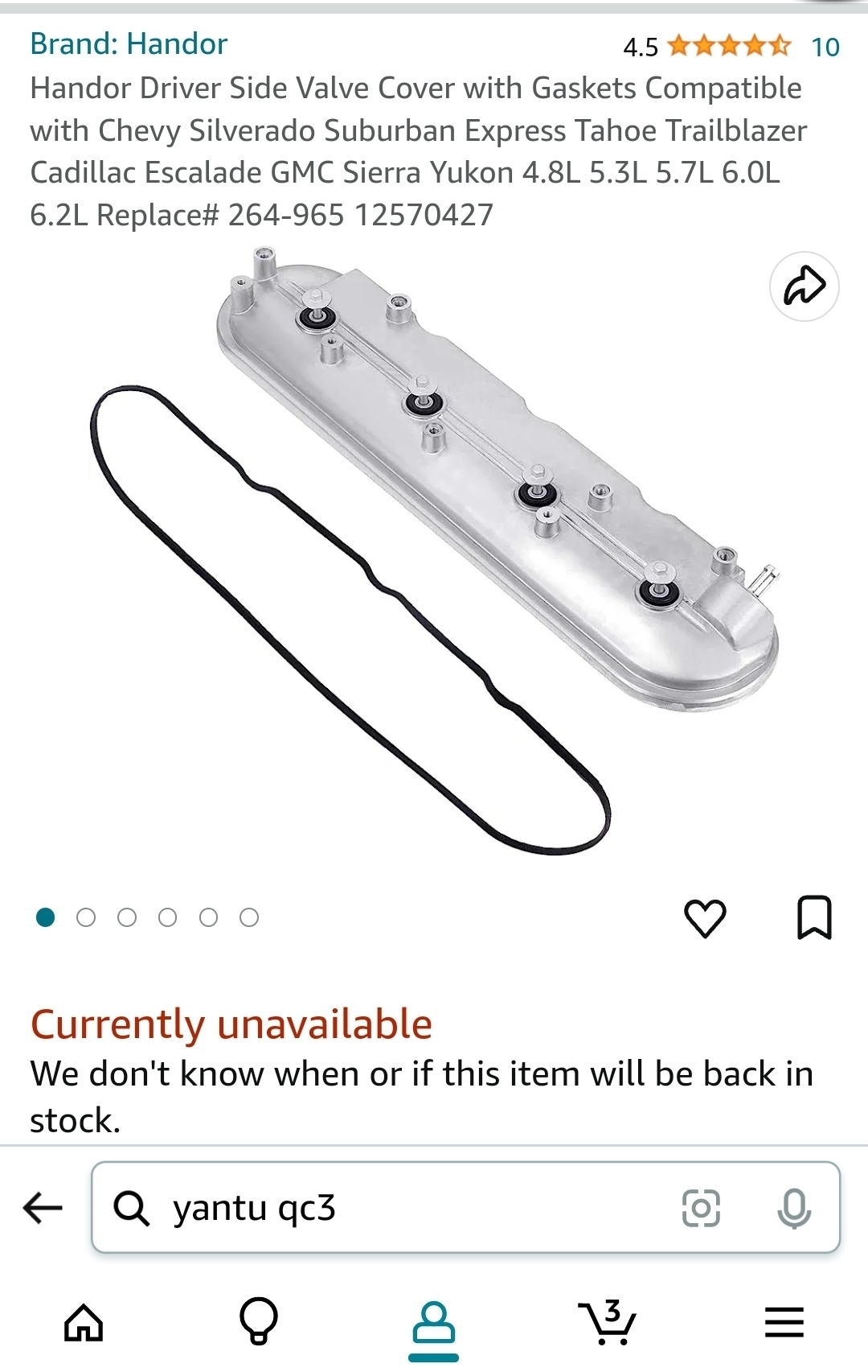

You are going to laugh but the driver side valve cover and the tube that connects the valve PVC to the top of the intake manifold are brand new also. The valve cover has less than 100 miles on it and the tube that hooks them together has about 5 miles on it. The only thing that i could check that isn't clogged is the plastic entrance at the top of the intake manifold I'm sending picture of it.
That's where it connects, and the intake manifold is still original from the car.

Lol. Well, that's good, at least we know that's good too. It might be worthwhile to check the port though.
I found another TSB on oil consumption. I want to see if the part numbers you got are the updated ones.
Do you have the part number for the valve covers you bought?

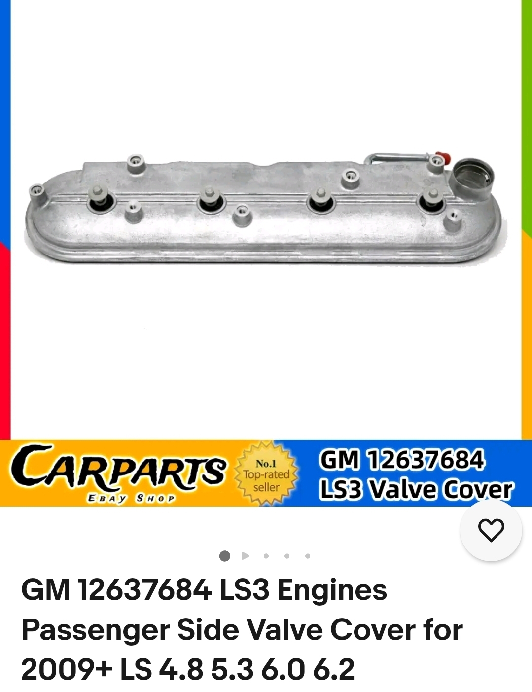

The passenger side i know says 2009+ but the covers are identical except the oil spout is actually different. The driver side is supposed to be the updated part per some bulletin.

Hello BBOYLILROB,
Do they both have a baffle in it that looks like the one in the image?
Thank you,
Brendon
Jun 9, 2023 at 8:44 AM
BBOYLILROB
  • 22 POSTS
Yeah the one with baffles are the upgraded version per some bulletin.
Jun 9, 2023 at 8:57 AM
BRENDON S
  • 653 POSTS
Hello BBOYLILROB

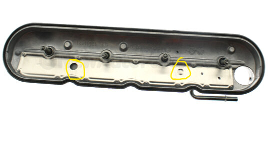

The part number you sent me for the passenger side has a different baffle. In the bulletin they only show an upgraded part for the driver's side, which you have. There was nothing done to the passenger side. The number you sent me looks like the old version. I'm wondering if this is what might be causing the issue.
Looks like it's got 2 big holes in it and nowhere for the oil to drain well enough. If this is the case drilling those holes, we talked about earlier might fix the issue.

I got all the updates parts as far as i know. This is the bottom of the one installed in my truck.

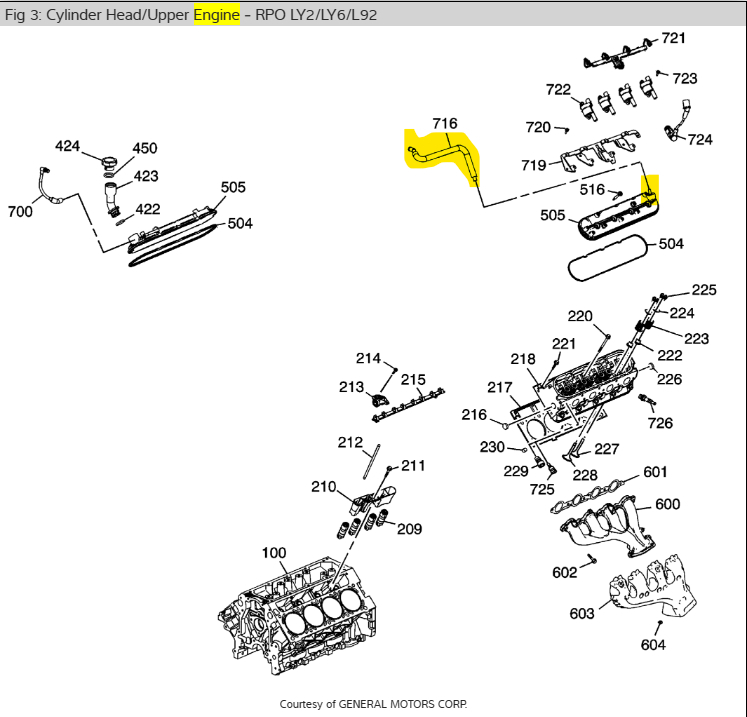

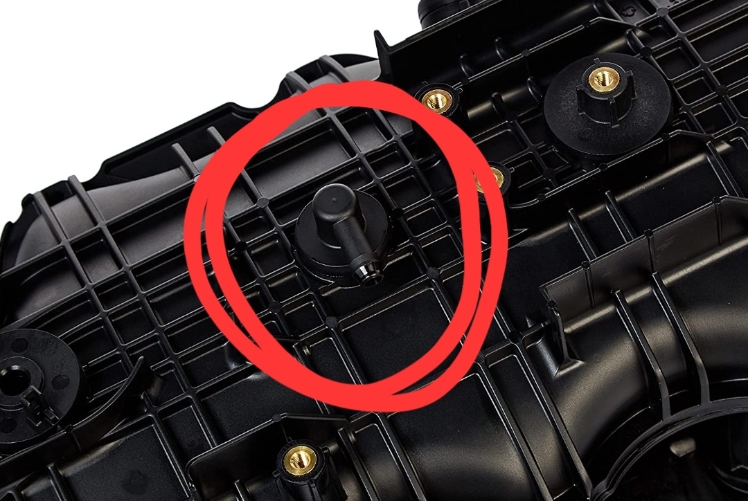

There is a PCV valve in that fitting, sounds like his is stuck open and it's sucking in oil under heavy vacuum. It also sounds like it's pulling a lot more vacuum through the crankcase than it should be. Check that the intake air side is open and that the valve is okay, he mentions it attaching to the cold air intake that doesn't sound correct. Also reference TSB PIP3343F.
Jun 9, 2023 at 10:07 AM
BBOYLILROB
  • 22 POSTS

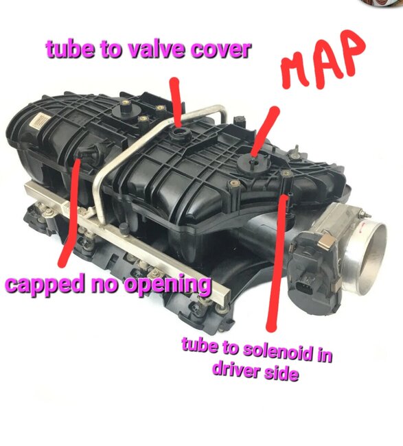

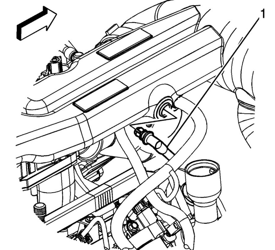

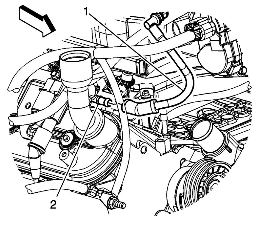

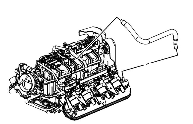

Mine has the 6.2 engine which doesn't connect the passenger valve cover to the intake manifold but instead connects to the air intake tube between the mass sensor and the throttle body. All parts are brand new so no clogs or failed things.
Jun 9, 2023 at 10:21 AM
BBOYLILROB
  • 22 POSTS

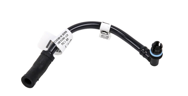

They sold me the tube in the diagram going from passenger side valve cover to the manifold in that diagram but in my 6.2 there is nowhere to plug it in the manifold. When i replaced the original air intake box to a cold air intake system there was a rubber tube that ran from the valve cover passenger side to the air intake tube and the cold air intake had a nipple in the same location where that rubber tube fit. Ran 3-4 years without a problem until i took the heads out for an unrelated problem and the 2 times I've put it back together i get oil into the intake tube from the valve cover tube.

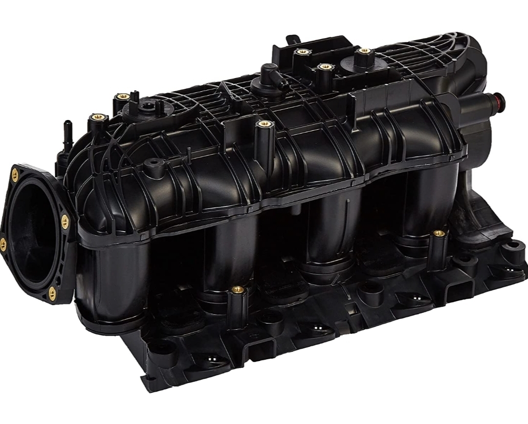

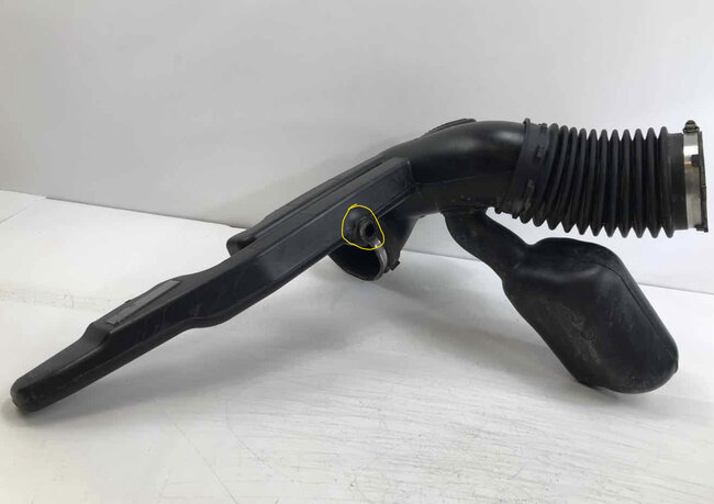

Is this the intake and tube you used to have?
Thank you,
Brendon
Jun 9, 2023 at 10:48 AM
BBOYLILROB
  • 22 POSTS
I'll be completely honest with you, i don't remember i changed it 5 years ago and i don't remember. But in the instructions of the new intake said put this hose from the valve cover nipple to the air intake tube nipple. It is possible that's the OEM part but i don't recall. But again, it never had this issue until i took the heads off and put it back together.

The picture of the cold air intake yes that's the house where the oil comes from the valve cover to the intake tube and then gets sucked into the intake manifold, they the throttle body.
