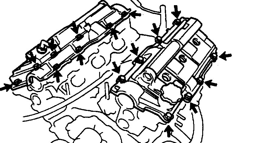

I just discovered a wet sign around the valve cover of my engine, after touching I discovered it is oil. What could be responsible for such?
Do I have to change the valve cover seal/rubber?
I also have the check sign on my car meter board for over four years now.

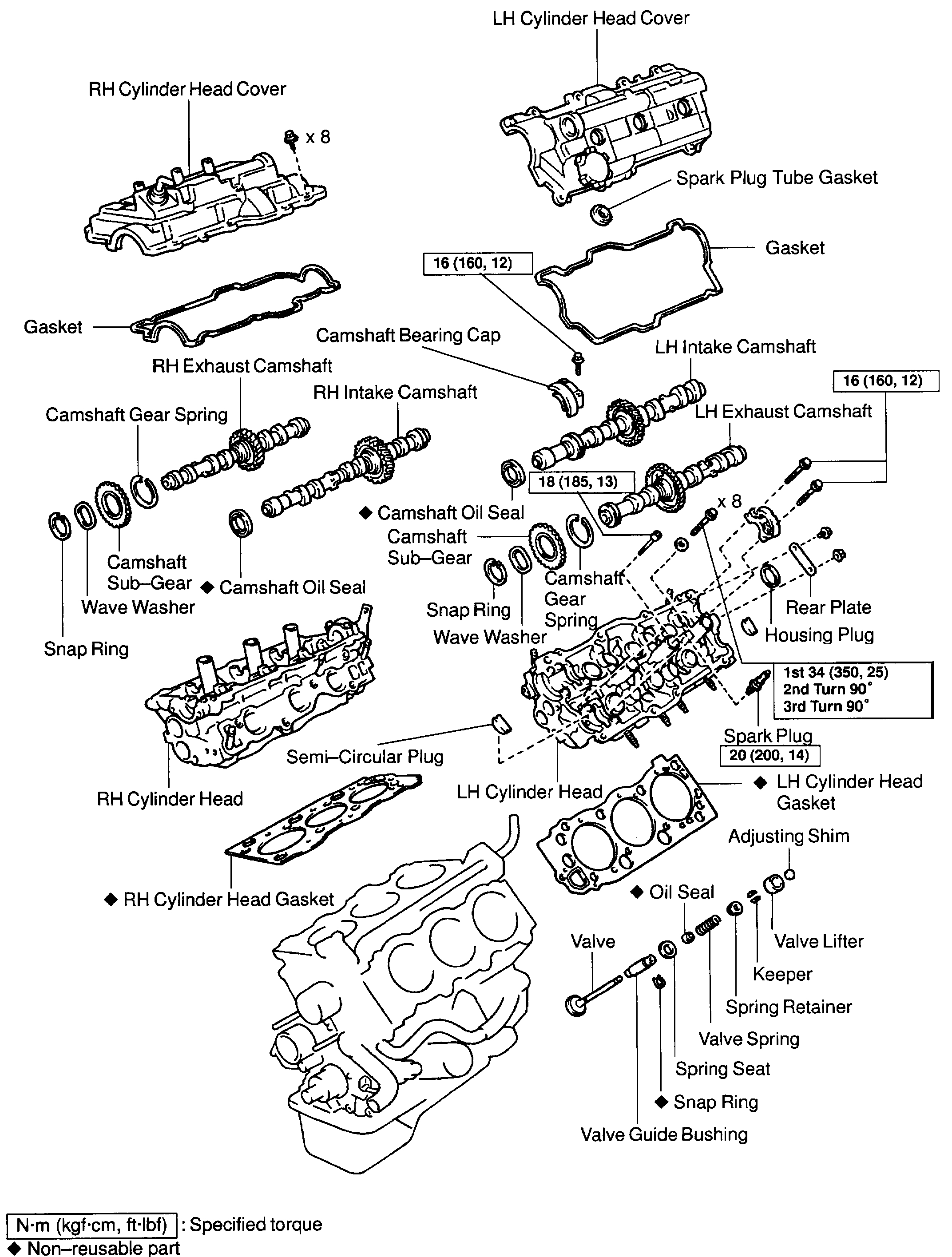

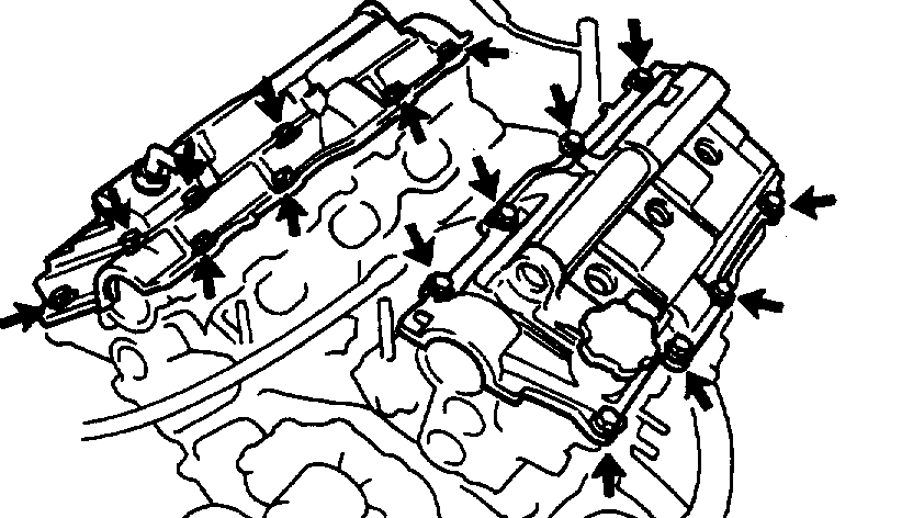

As far as the valve cover, if it is wet around where it mounts to the cylinder head, then it is leaking. Yes, the gaskets need replaced. Here is a link that shows it being done:
https://www.2carpros.com/articles/replace-valve-cover-gasket
I have attached an exploded view of the valve covers so you can see the bolt locations.
Let me know if you have questions or need help.
