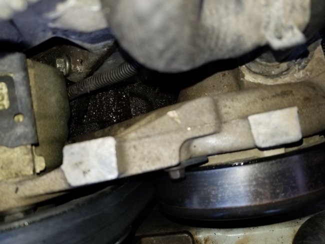

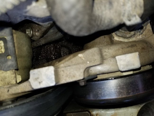

photo.
Feb 22, 2018 at 4:04 PM
ALEX19899
  • 171 POSTS
another photo.

Get some engine degreaser and spray it all around there. They have got instructions on the can, just make sure not to spray any electrical connectors. Then see if it comes back. To me that looks like just years of gunk and grime building up. It could be a leak of some sort, but I am not sold on it being a leak. Do go ahead and check all of your fluids, so if one is leaking you will know for sure.
If it is engine oil, it is probably from old dried out valve cover gaskets. A common issue on these cars. That is a common issue on all cars. It would be a slow leak, that runs down the front and/or side(s) of the engine.
See what you find.
Feb 22, 2018 at 6:45 PM

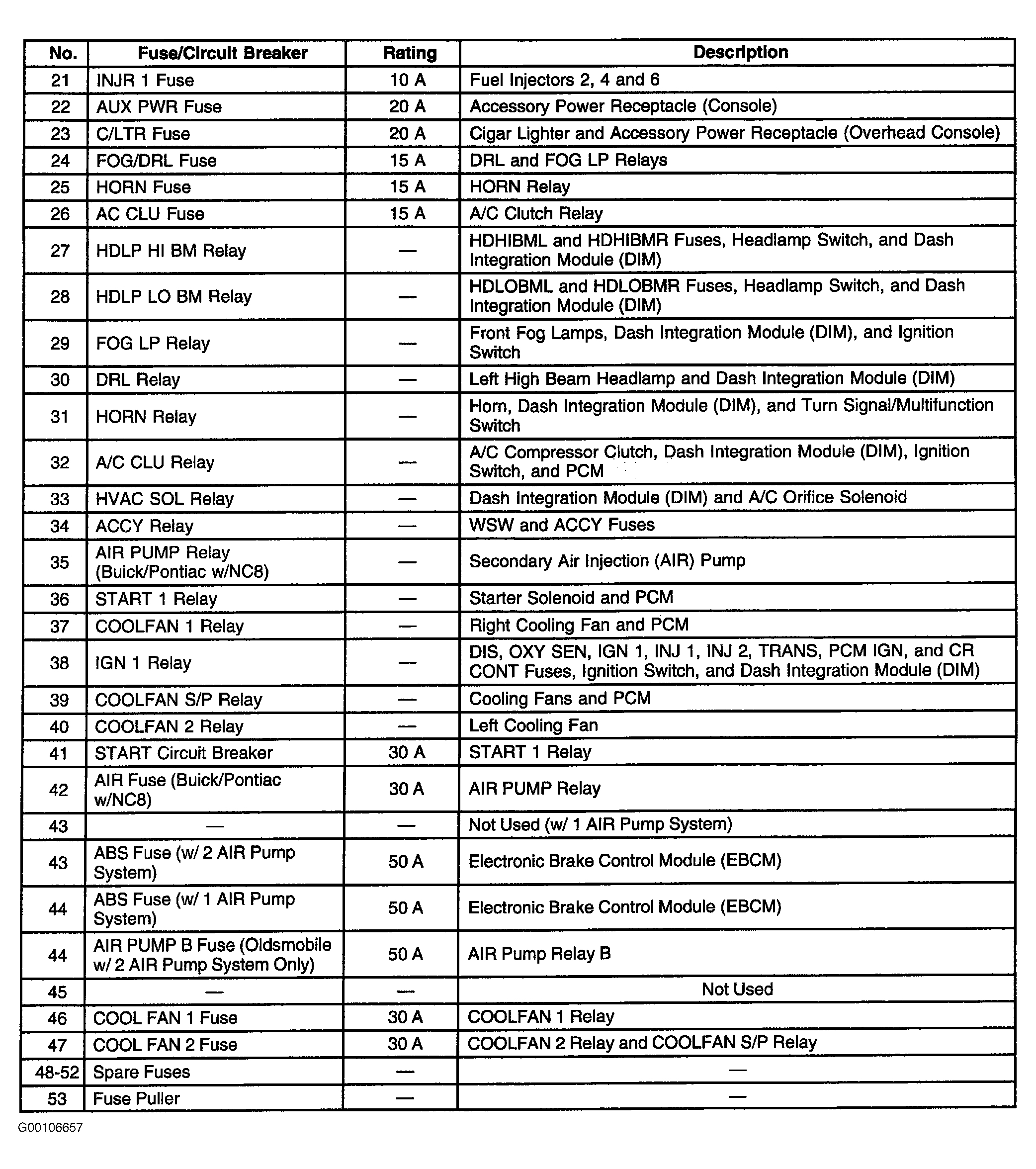

well I also have P0410 code popping up. I already replaced the air pump and both check valves and checked the hoses but the code continued to pop up.
Feb 22, 2018 at 7:33 PM
HARRY P
  • 2,292 POSTS

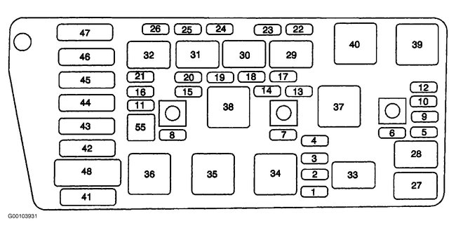

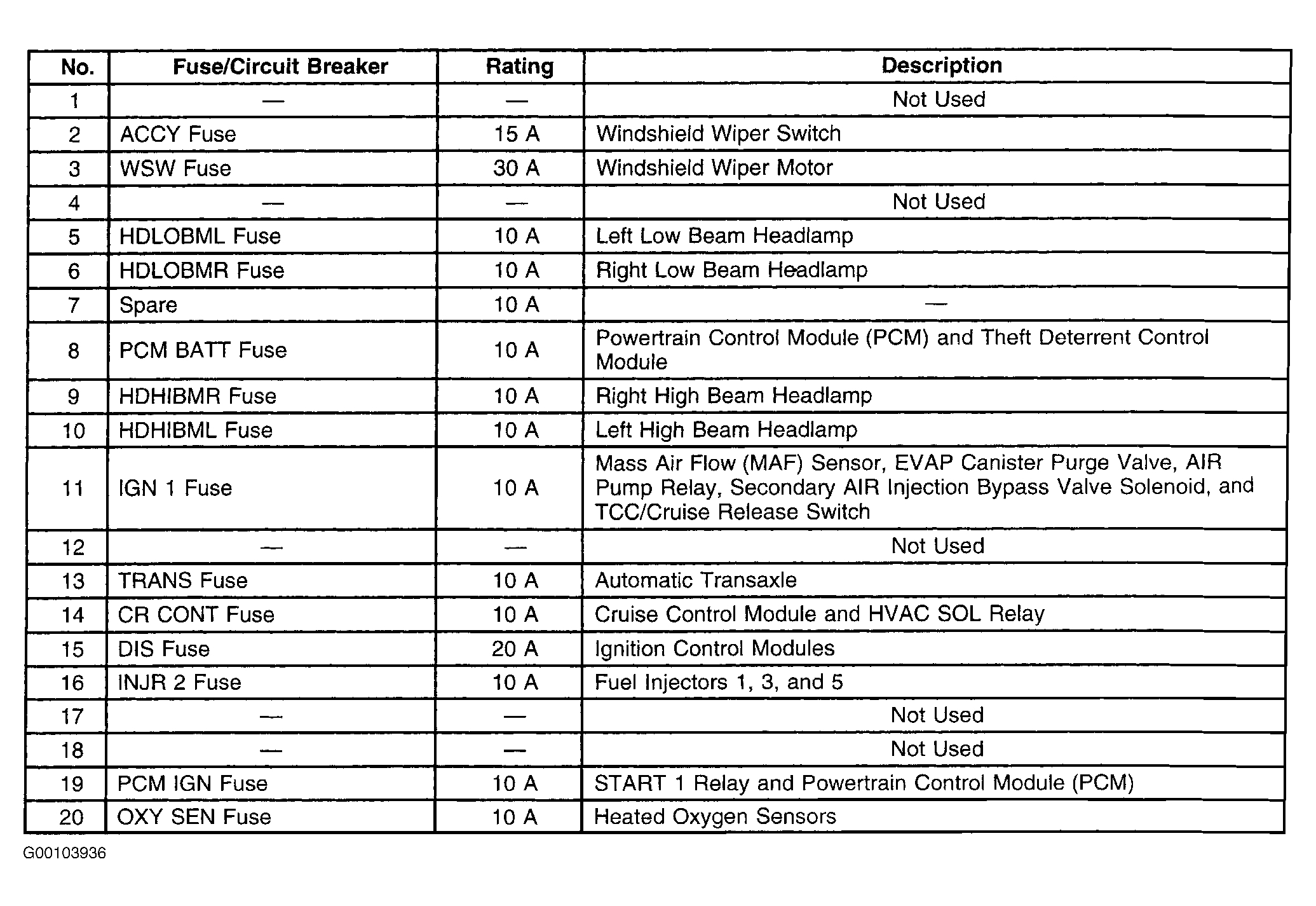

Regarding the P0410 - Check #35 in the images below. It is the relay for the air pump. You can buy a relay for a few bucks and try it. Cannot hurt.
Feb 22, 2018 at 7:51 PM

if the relay is bad would the pump still come on?
Feb 22, 2018 at 8:01 PM
HARRY P
  • 2,292 POSTS
Maybe. It could get stuck on or it could not be coming on at all.

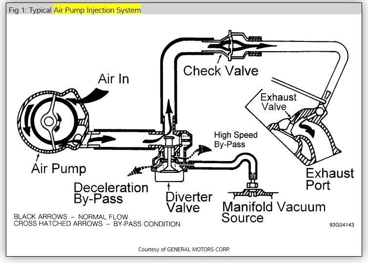

is there a switch for the check valves?
Feb 22, 2018 at 9:46 PM
HARRY P
  • 2,292 POSTS

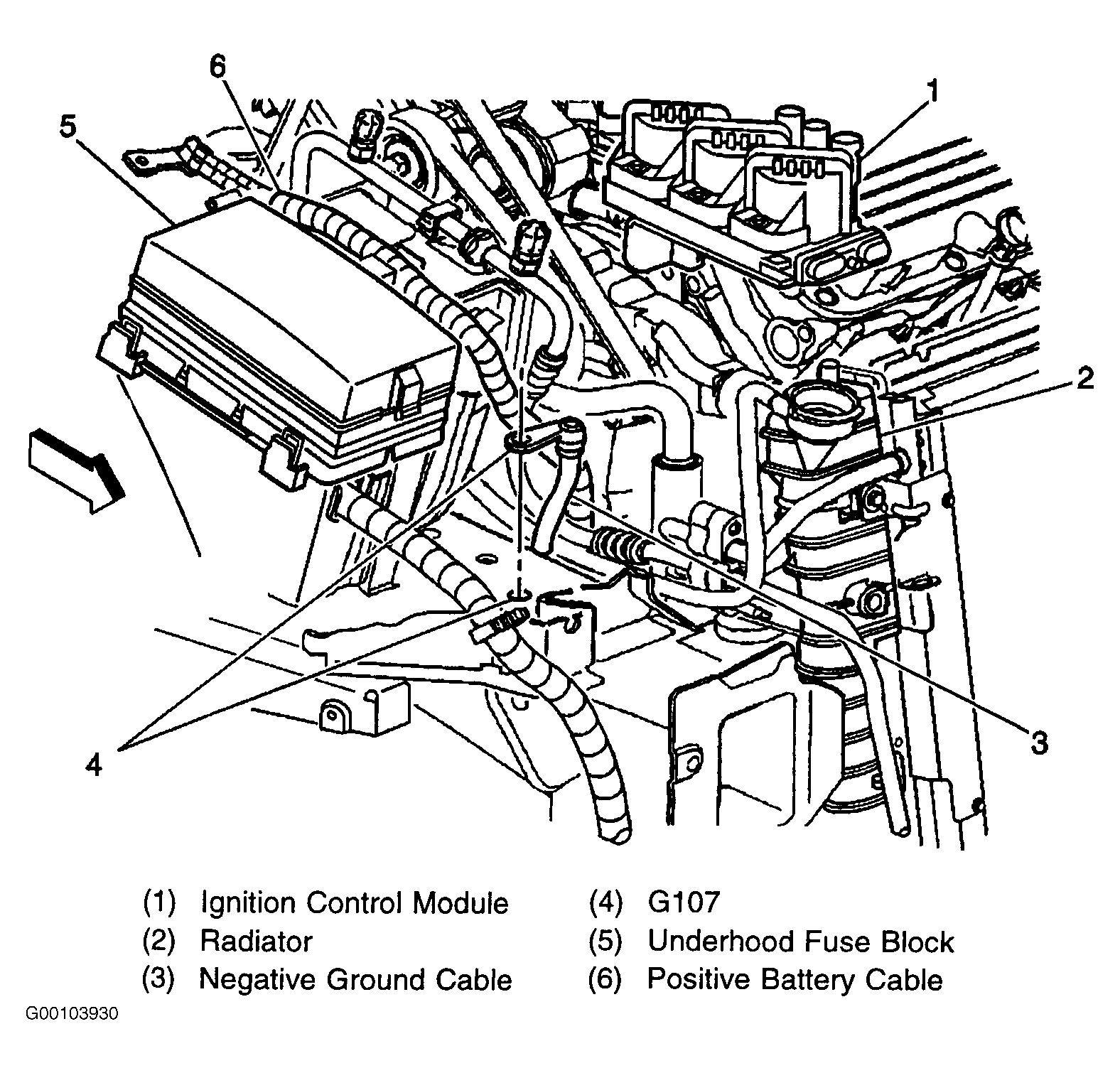

There is a check valve in there. I *believe* it is in the hose leading from the pump to the exhaust. I am attaching a diagram that is provided by GM. Personally, I would bet that that check valve is not opening and that is what is causing your issue. It is likely a dealership only part, but it would not hurt to try the local auto parts shops and rock auto.

so when the air pump comes on is it suppose to sound like humming or a mini vacuum?
Feb 23, 2018 at 2:18 PM
HARRY P
  • 2,292 POSTS
Something like that. I haven't specifically heard the one on those cars, but that's the general gist of it. Find that check valve. Replacing it shouldn't be expensive (Check valves aren't exactly new and exclusive technology).

I just replaced the valves couple weeks ago
Feb 23, 2018 at 8:03 PM
HARRY P
  • 2,292 POSTS
Well from what I understand, the code indicates that there's some sort of flow error from the pump. So if you're hearing the pump run, and feeling it blowing air, then there has to be a blockage or something along those lines.
I suppose that it's possible that the oxygen sensors (readings used to set this code as well) could be reading incorrectly. But I doubt it. They'd have to not change as expected when the pump was running, which seems unlikely to me, especially without any other oxygen sensor codes.
Feb 23, 2018 at 8:09 PM
ALEX19899
  • 171 POSTS
well today I change the relay and when I was changing the relay I only got a portion of it out and then the air pump came on sounded like a mini vacuum. before the pump would only make a humming sound and I couldn't hear or feel any air coming from the pump. I just bought an air pump from rockauto brand new a couple weeks ago. my old pump would make the same sound.
Feb 23, 2018 at 8:19 PM
HARRY P
  • 2,292 POSTS
There has to be an airflow issue somewhere in there. If the pump is pumping air, then there's something else going on. Either no air is getting through (jammed check valve, clogged tube) or too much air is getting through (check valve stuck open or a leak in the tube).
