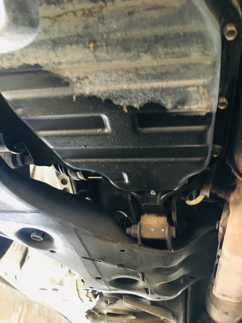

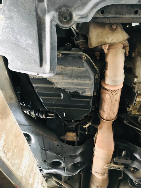

I just bought this car and I check my engine oil daily, but my dipstick is showing a reduction in oil with huge difference every day. Like I changed my oil last week and now the dipstick is showing oil below the low level. My engine exhaust is not showing any white smoke, my engine sound is also perfect and there is no low oil sensor indication on my dash. Please help guide me through the problem. The engine is 2.5li DOHC V4, I guess.

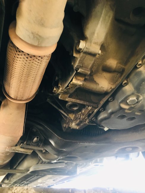

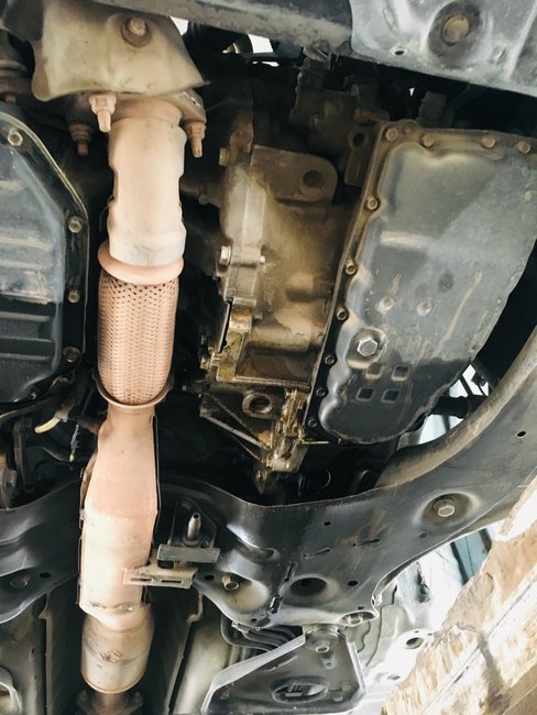

There is oil leakage from the bottom, but I cannot confirm it, either is transmission oil or engine oil. Because a person was saying that it is transmission oil leakage. How can I confirm that?

Is there any way you could get under the vehicle and snap a few pictures of it and upload it to us? Also transmission fluid is usually reddish in color and engine oil will be black. Please get back to us with what you can deduce from the information or with a few pictures.

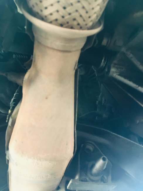

These are the possible shots that I could take. I hope these are helpful. Today I added w40 oil of fuchs. Before that i was using 10w30 of petromin. I though the thickness might help.

Okay, if the oil is coming from the front of the engine around the crankshaft pulley then it will be a front main oil seal that is leaking. If not then it looks like it will be the oil pan gasket that's leaking, Please check the front of the engine around the crankshaft pulley and get back to us.
