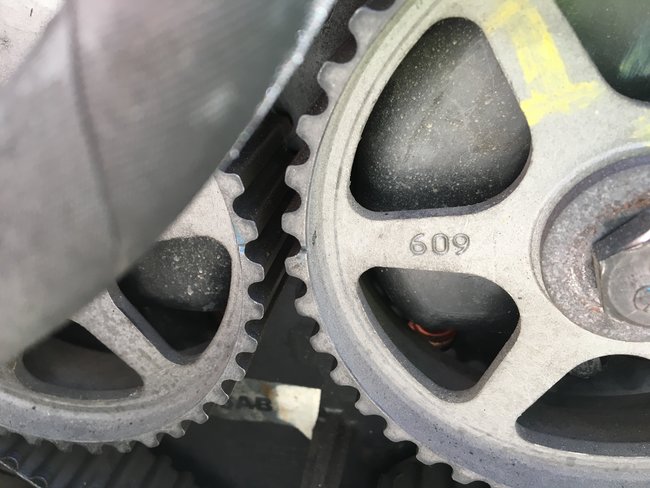

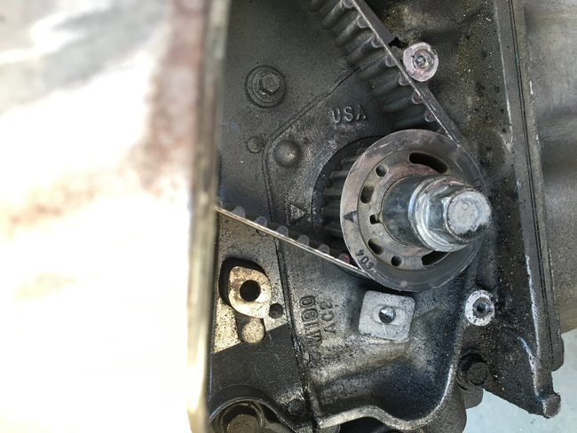

Car has a cylinder misfire. Was originally cylinder three. Replaced spark plugs, wires and replaced coil pack with a known working coil pack with no change. Other then cylinder three misfire has moved to cylinder two. I do not understand why cylinder three went away and now it is cylinder two. Tested compression and all four cylinders are 190 PSI. Thought maybe the timing belt stretched a tooth. Took pictures but it looks like it is in time but I could be wrong. Does not have a misfire in fourth gear. Only in fifth gear and it starts when you get to forty five to fifty mph.
Jul 29, 2020 at 5:02 AM (Merged)
MHPAUTOS
  • 31,937 POSTS
Valve timing looks okay, have you checked for any vacuum leaks at the inlet manifolds yet?
