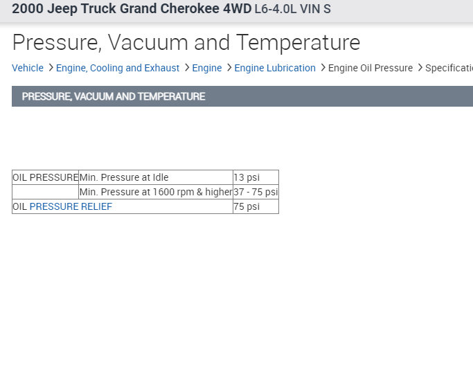

My oil gauge reads 80, is this normal? I'm female and just trying to get informed. It's a great running vehicle. However, the heater doesn't heat, and the conditioner doesn't cool. But blowers seem to work well on both settings. I checked the coolant and it's fine.

Does the oil pressure gauge always read at 80?
On this engine it should be anywhere from 37-75 PSI at 1,600 RPMs.
And 13 PSI at idle.
What are you experiencing? Are you just noticing that the pressure is high or is there an issue?
Here is a guide that talks about high oil pressure as it is slightly high.
https://www.2carpros.com/articles/high-oil-pressure
