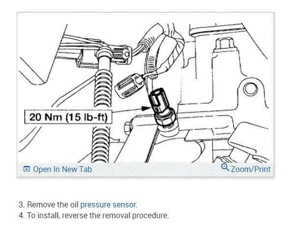

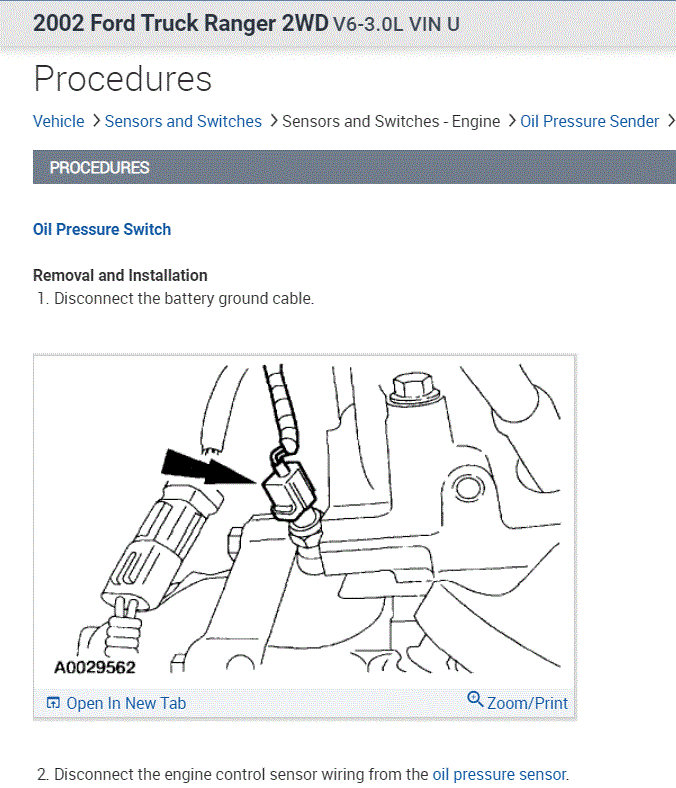

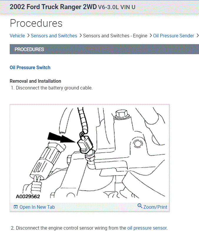

When this happens, are there any engine noises such as knocking or ticking? If not, chances are the sensor is going bad. They can start to leak (often times where the connector is plugged in) causing this
I attached the directions for replacing the sensor. This is certainly where I would start.
Let me know if this helps.

You are very welcome. I did have an afterthought. If you are concerned about pressure, go to a parts store and get a mechanical oil pressure gauge. Most stores will lend one to you. Remove the electrical sender and install the mechanical to confirm pressure.
