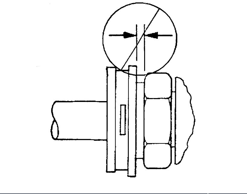

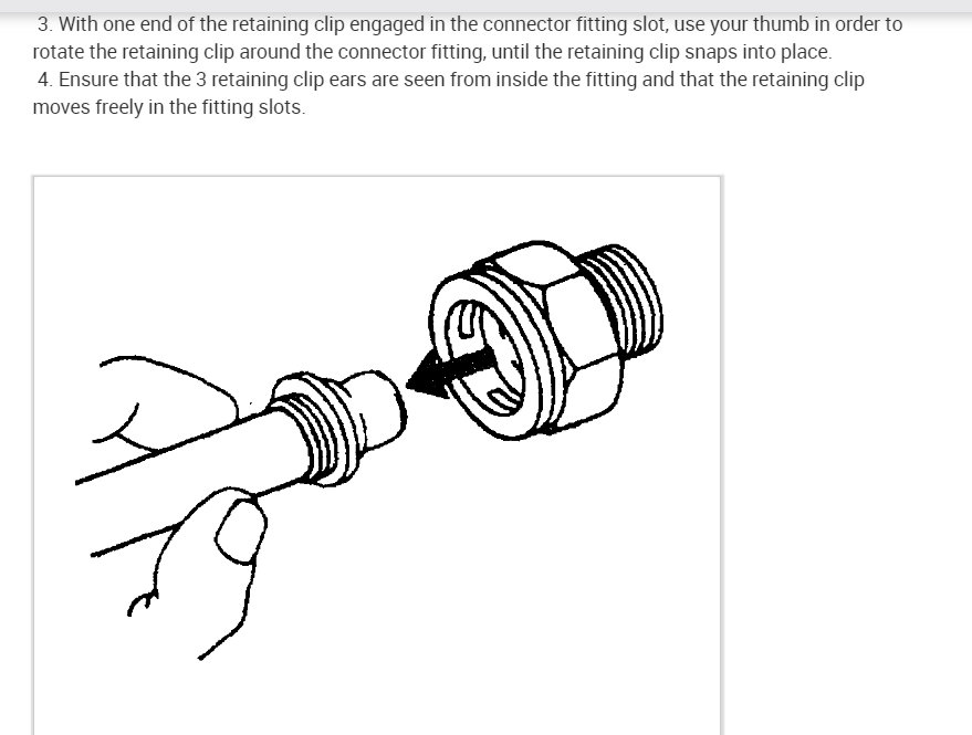

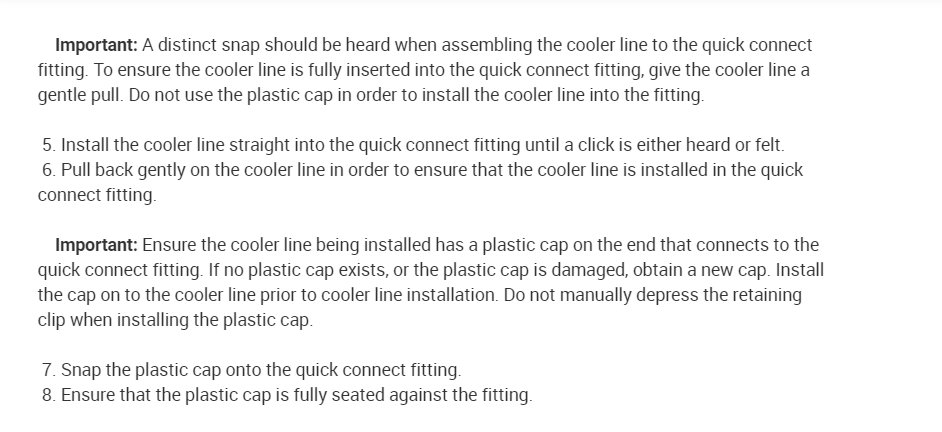

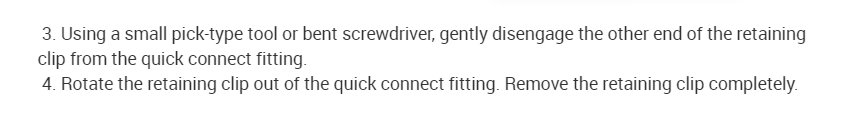

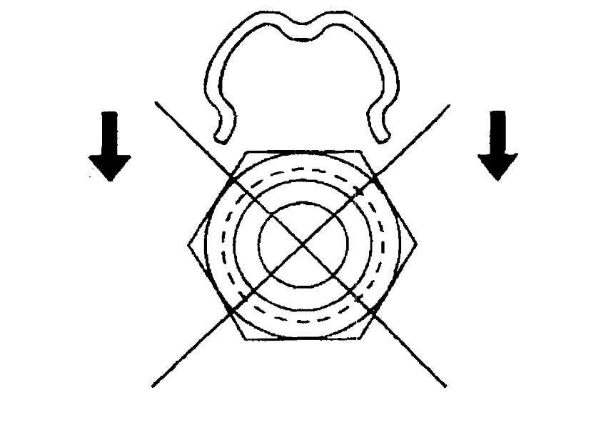

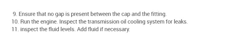

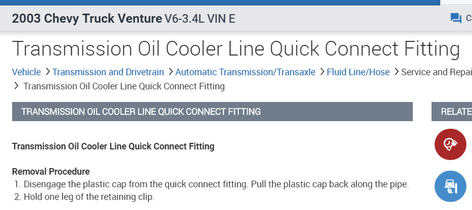

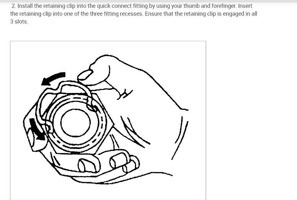

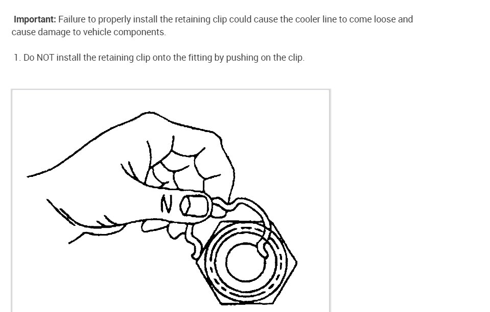

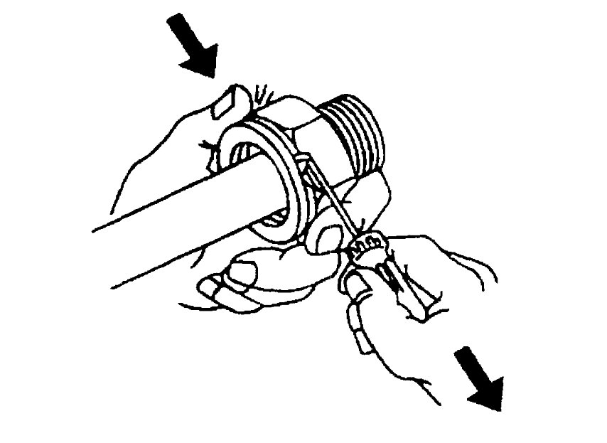

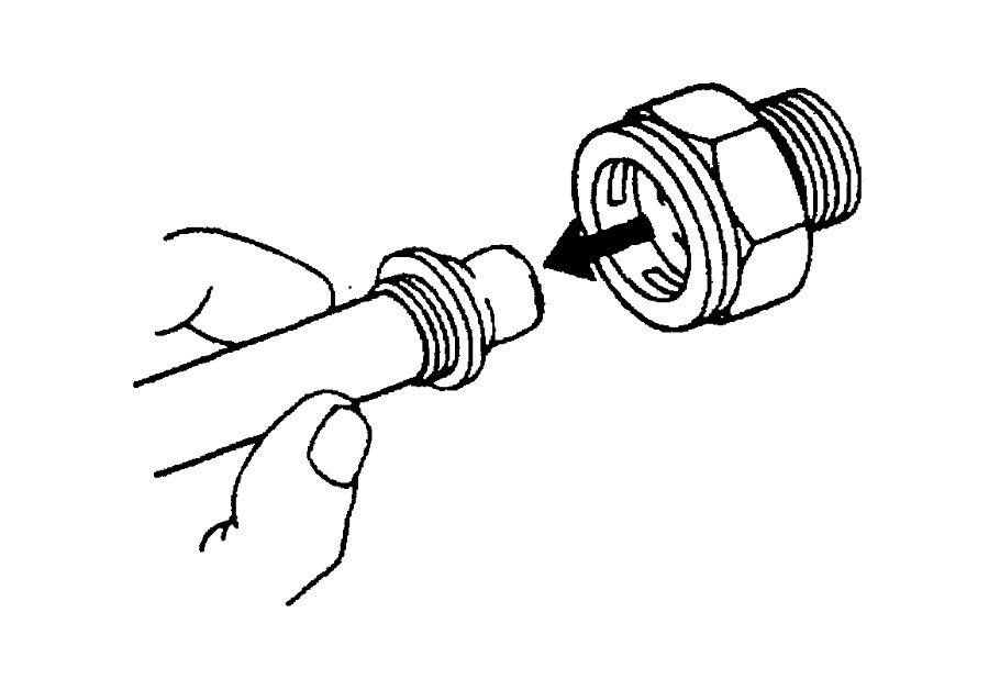

Hello, I noticed on my minivan that oil had sprayed around on other parts so I try to figure out where the oil was coming from. I looked at the top by the radiator and it was the oil cooler line, but when I looked it wasn't attached to anything. so I played around with it and push it back into the spot it was like it didn't have any thing attaching it there. what do I do?
Aug 27, 2019 at 5:10 AM
SCGRANTURISMO
  • 4,897 POSTS

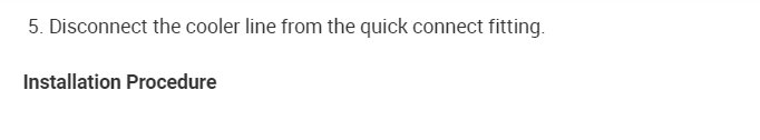

These fitting are known as "Quick Connect" fittings. In the diagrams down below I have included a guide describing how to remove and install this type of fitting on your vehicle. Please get back to us after you go through this guide and let us know how everything turns out.
Thanks,
Alex
