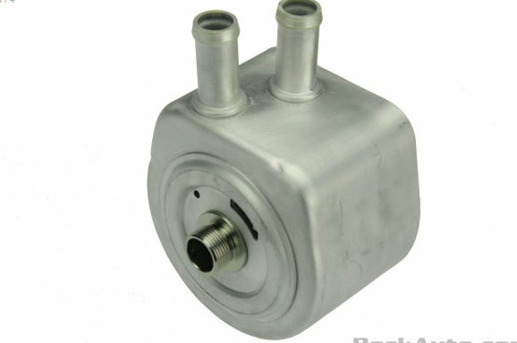

I'm not sure if this truck uses an oil cooler, if so, would you happen to point me its location? i'm assuming by the oil filter.
Jan 28, 2022 at 7:23 PM
You are correct that it is going to be near the oil filter. Basically, it is on the oil filter housing if it is equipped.
It is not clear on the 5.4L if it has the cooler but if you look at the oil filter housing and it has two lines running from it then that is the cooler.
Here is a guide that will help with changing the oil if others that visit this post need that info as well:
https://www.2carpros.com/articles/how-to-change-engine-oil-and-filter
I attached a picture below of what it will look like so please run through this and let us know if you need other info.

Hey thanks for this info. anyways, I checked and there is no oil cooler on there. so, does that mean the oil in the coolant reservoir is from a blown head gasket?
Jan 29, 2022 at 2:38 PM
Understood.
On this engine that would be the most likely cause of this.
Here are a couple guides that will help with this type of testing:
https://www.2carpros.com/articles/coolantantifreeze-in-the-engine-oil
Let us know what you find with the head gasket tests and we can go from there.
