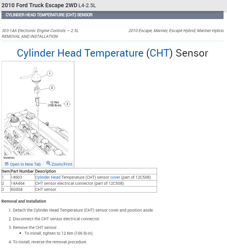

Temperature gauge on the dash heats up much faster than it has in the past. I have had the car for 2 or 3 years and it has never gone over to the right and maxed out the dash gauge. The last oil change was less than 100 miles, radiator coolant was filled up at the same time. Radiator has minor damage from a previous accident; however, it does not appear to be leaking. Gauge gets hot from both idling in a parking lot and driving on the road and highway. What I am looking for is more information on the subject and a diagram of my engine showing where the sensors that check the temperature are.

The temperature sensor is located on the top of the engine.
I have attached a diagram for your reference.

Thank you so much for your quick response and the diagram with the included location and part number. If I have any other questions I will be sure to let you know.
